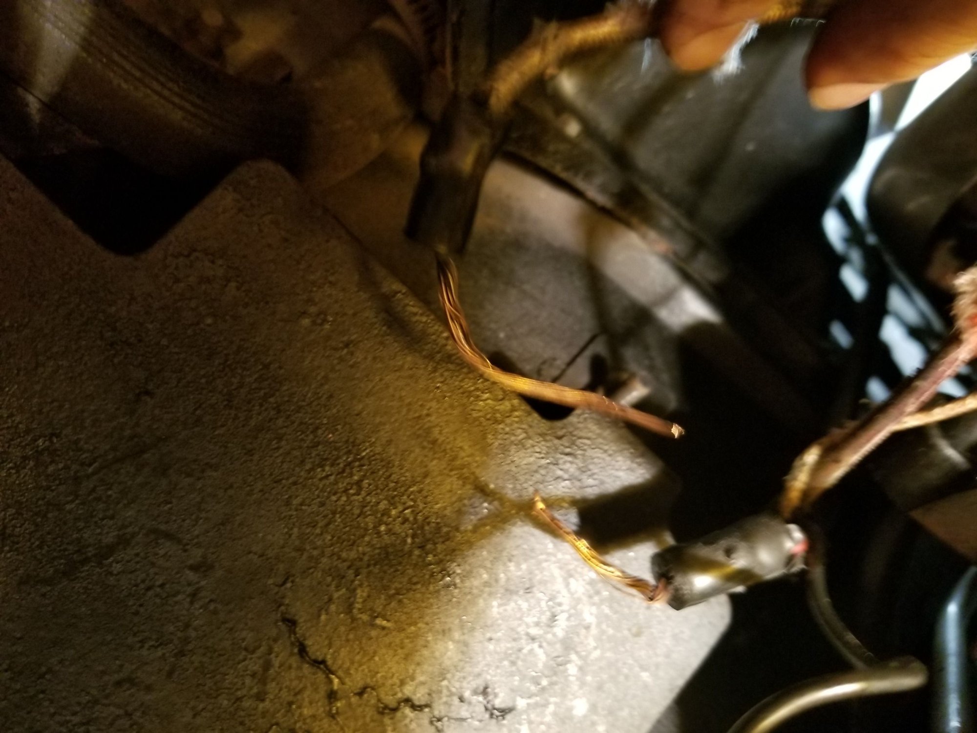

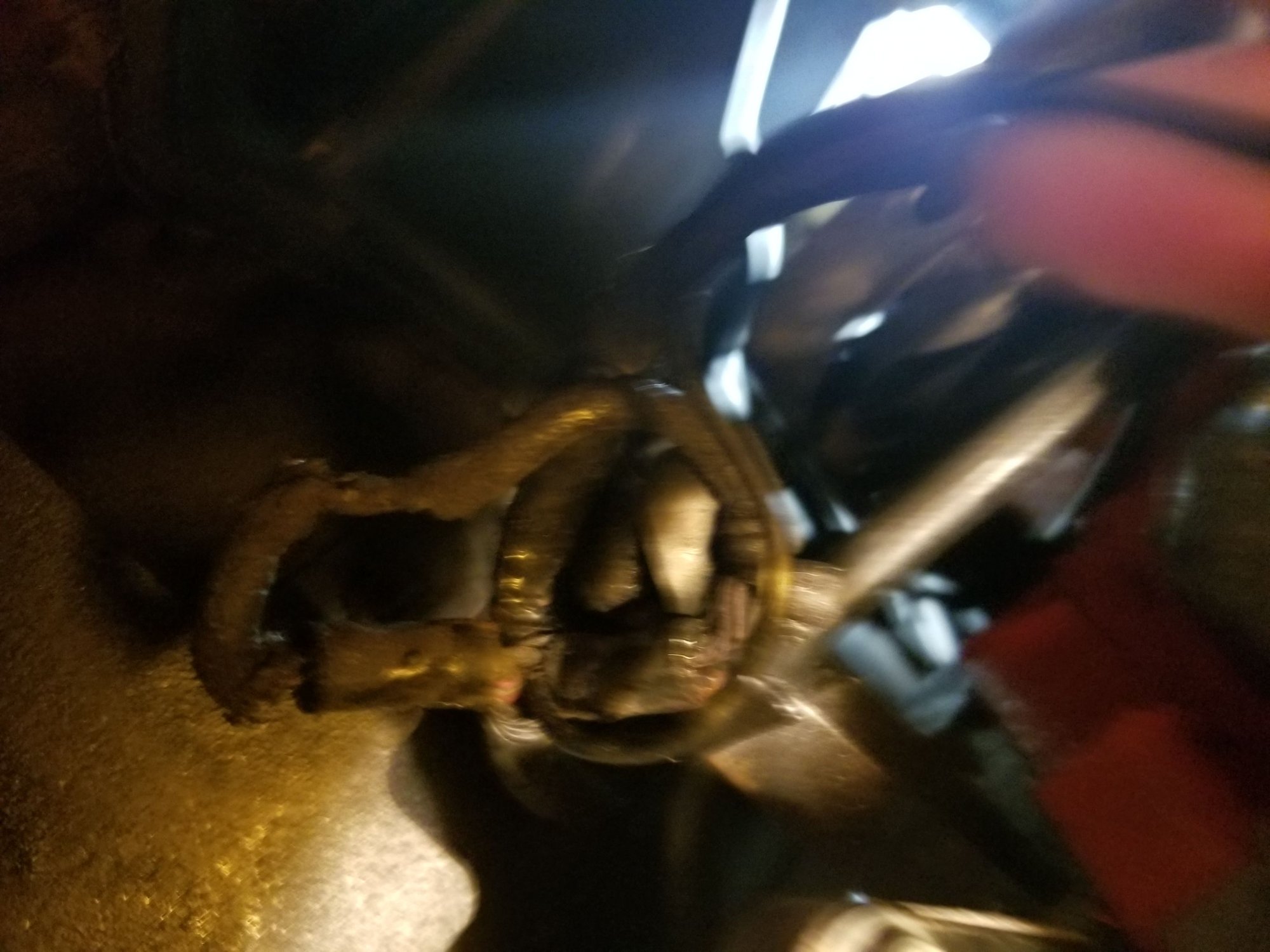

Appears a new battery was installed backwards, negative on p positive and Vice versa. Melted the fusible link going to the started. I'm attempting to add pics. I've removed the melted jacket and found the wire burned in half. I need to replace. Do you patch these or replace? If replace, one end goes to the top of starter. The other end goes up towards the windshield. So I have to track down that end of do you somehow replace between the 2 connector shields on the link? What do I purchase and where?

You can splice in a piece 14ga fusible link wire. also I believe American Autowire makes a replacement fusible link with the eyelet on the end that connects to the solenoid + post.

Thank you. I'll try that.
