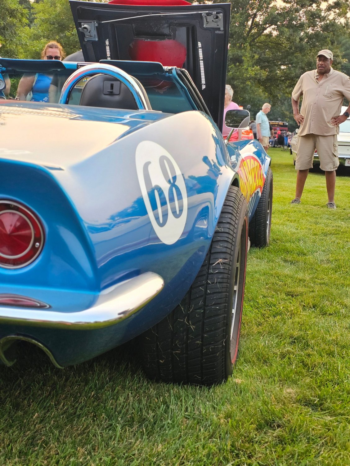

low as I can go without rubbing...

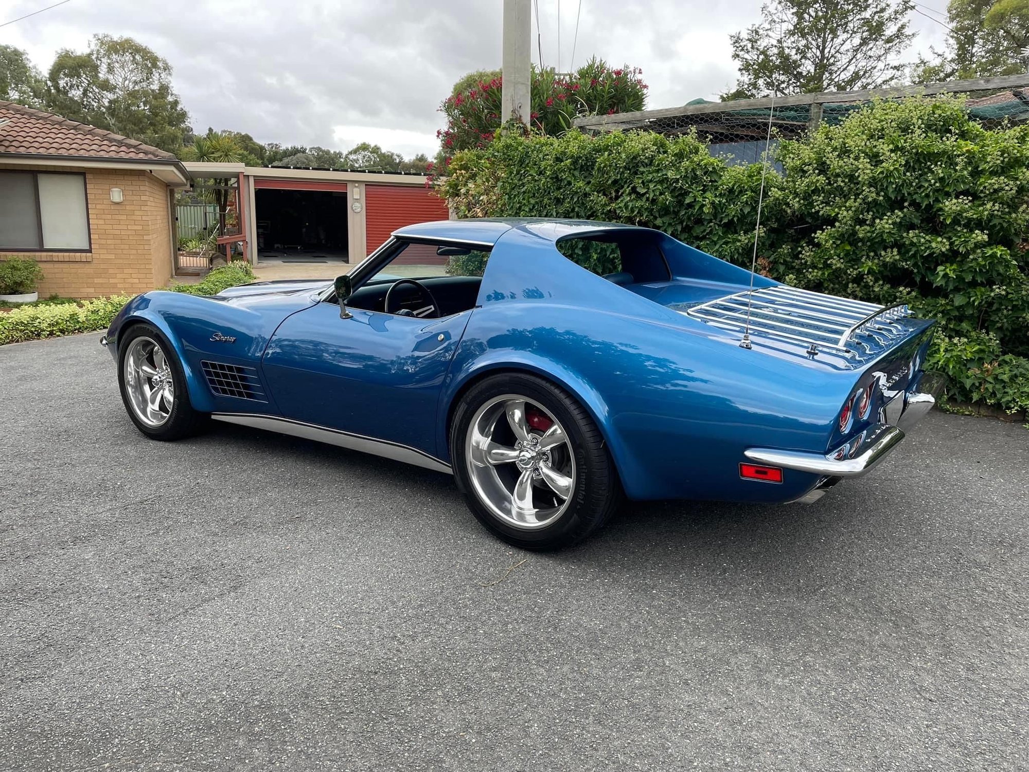

Occasional scrape but not very often. My diff sits a bit higher with VanSteel delrin mounts and removal of the stock rear spring (using coilovers) does give a little more space for the exhaust to pass. Custom exhaust to tuck up as high as possible but running low will always have the occasional scrape.
While I do appreciate the input this isn't even on the same page. With a setup like that the pipes hangin too low would be the last thing I'd be worried about.

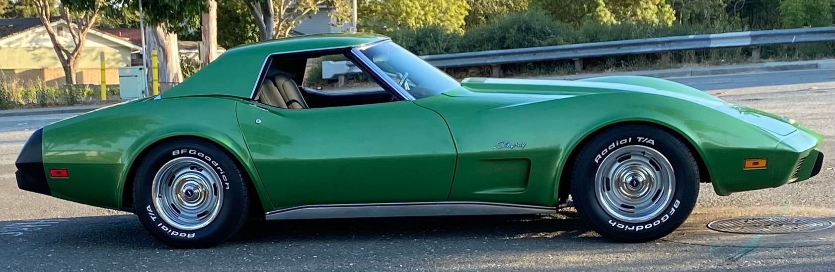

Ive shaved the ends of the spring. I had planned on running a set off coil overs,got them in the front but don't want to weld anything on the car. I do need to crank down the rear spring to stiffen up the rear. I've bought this car about 3 years ago and have been pretty much working on it non stop,cars got 12,500 original miles,sat in a garage for 35+ years so in addition to getting it back on the road a Ive done a few mods along the way. I do need to put the front spoiler back on the car. This picture was before I dropped the back down to where it is now.
