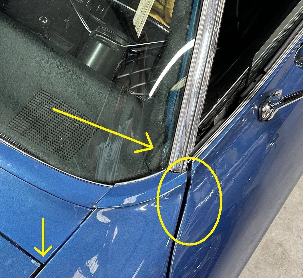

This is the LHS A pillar, does the door gap look alright and what about the base of the A pillar and the dash with what looks like bubbling? Would that indicate rot?

The underside doesn't look too bad but I would be pulling off the kick panels to look at the bird cage and interior window trim and looking it over very closely.

I forgot to mention, this is not my car, this is a car that is for sale that I am looking at... the gentleman does not want the kick panels to be pulled, he is adamant about the car having no rust.

Do the borescope thing to inspect the kick panel body mounts. Look upwards behind the dash as well as downwards to the bolts. Also inspect the frame in the area of the rear lift pads - the "kickup" of the frame for the rear suspension is welded there and can accumulate mud and debris in the pockets that will rot out the joint.
Windshield A-pillar: (the posted pic isn't high enough detail to see this clearly) As far as the bubbling at the windshield, my '72's sealant goo is not pretty and could be mistaken for rust jacking, but if you look closely with a flashlight, it's evident that it's sealant. The factory was less than careful with cleaning up excess schmoo. How does the pillar look at each end of the VIN tag where the rivets are?
I wouldn't worry too much about the gaps unless it really looks off or is binding when you operate the door. There was/is a lot of variability from car to car concerning panel fit.

On my car I can take a mirror inside the car and look up the of the top of the window shield areas and see what the top of the birdcage looks like. You have to look in from the outside of the glass. Car does look sprayed and/or coated as the bolts are black. Overall from the pictures it looks pretty decent compared to most. All depends what you are looking for and the cars price.

There is activity on the bottom A-pillar that is bad enough to want to see behind the kickpanels......if the seller has an issue with this, thank him for his time and walk away......thousands of other Vette's out there.....

I don't like the gaps, if that door is fully closed it's way off which could indicate a previous front end collision / repair. The hood gaps are off too, cant see passenger side or the other gaps in the door closer to the handle but again this is way off. Yes it all can be adjusted but why is it like this ? I also don't like what appears to be rust / bubbling at the lower post by the vin tag which ( SHOULD BE BLACK ) if there is rust there, then you can be assured there is most likely rust under the chrome or in other places you cant see. More pictures would certainly help.
