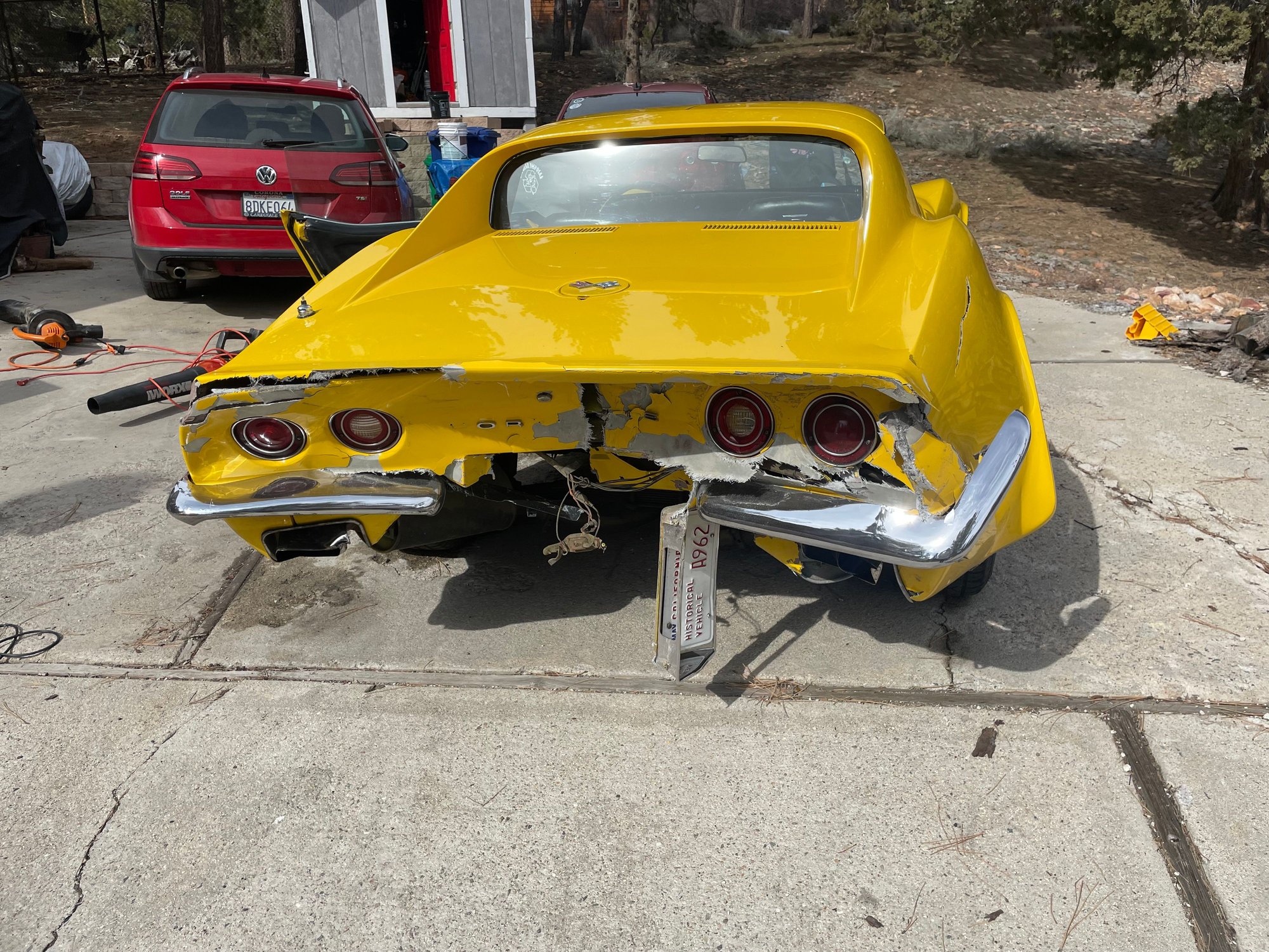

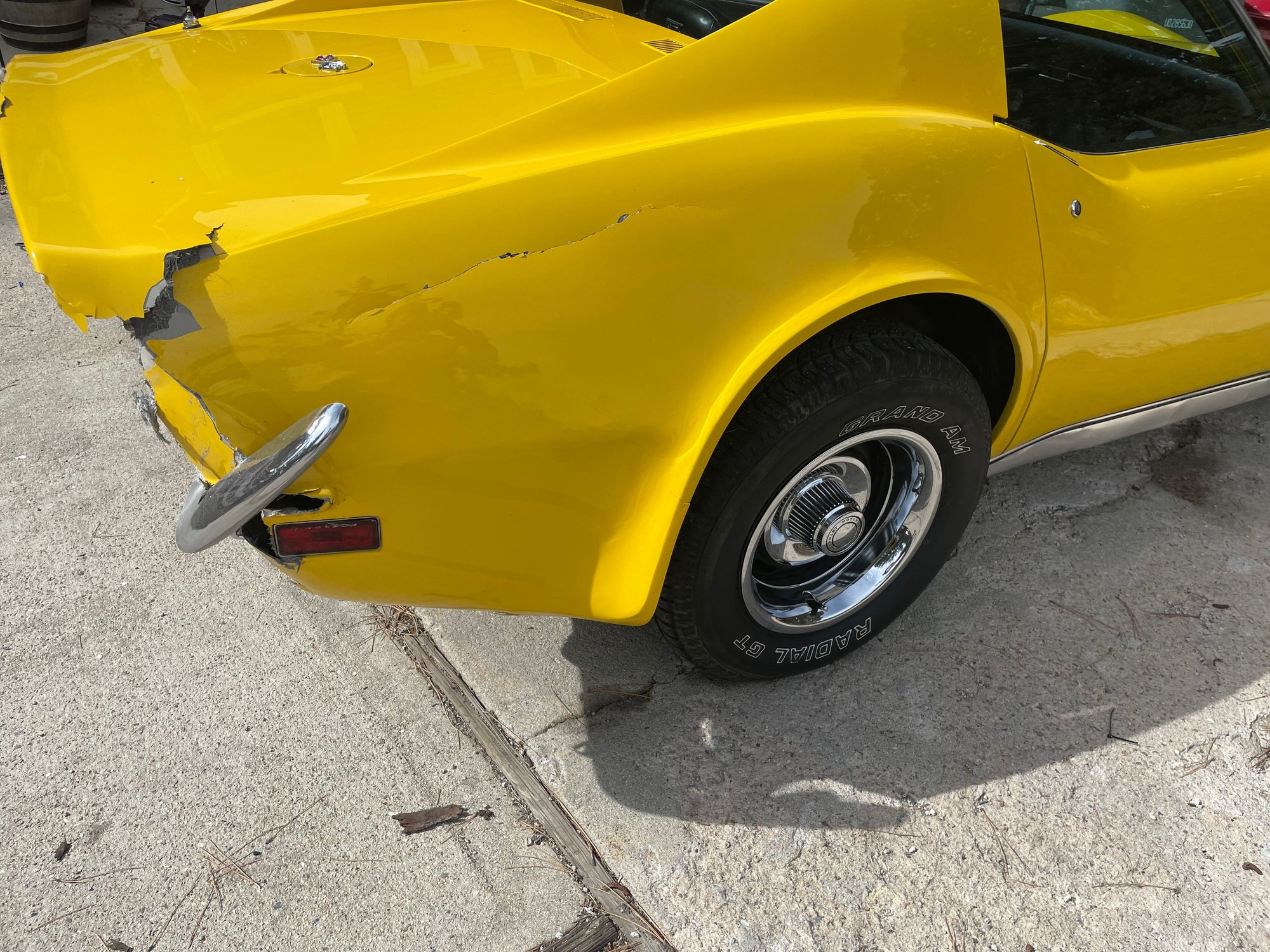

Before
Before
Before
This is my sad story. I had just gotten the Vette back from being in the paint and body shop where they had been working on it for three months. I had three coats of paint that had to be removed: the original Warbonnet Yellow, Sunflower Yellow and then Matte Black. I also had stress cracks and some minor body work. The body shop did a phenomenal job and even fixed some other issues I had like the electric windows, the horn, and other stuff without charging me extra. It looked gorgeous. I had so many compliments just in the three hour drive to my house. I had it for about 12 hours, was detailing the inside to show it off to my friends, and inadvertently knocked it out of park. I was also in the process of replacing the handbrake handle so the handbrake wasn't on. Did my car start rolling down my steep driveway while I was still in the car? Nope. Casper the Ghost waited until I went in the house to get the keys and then rolled down the driveway and hit the car on the opposite side of the street. I am really glad nobody was walking down the street and got hurt, but my poor body shop guy and I were almost crying. He had taken so much pride in his work.
Thank you everyone for taking the time to give me such detailed responses. I have talked with the body shop and if we go forward with getting it fixed, which I hope we will, I have ready to go the rear panels and the right quarter panel. More updates will be upcoming as he does the work.

New rear panel and new quarter panel certainly sounds like the correct way to go to me.
Yes there is some structure under there that is bent. Any shop with a frame machine should be able to pull that back out.
I see that you have gotten mixed opinions as to replace entire rear clip or not.
Just google what's involved with removing it from the bird cage!
New panels can easily be sectioned in.
Best of luck with the repairs. Hope to see the repaired photos in a couple months.
