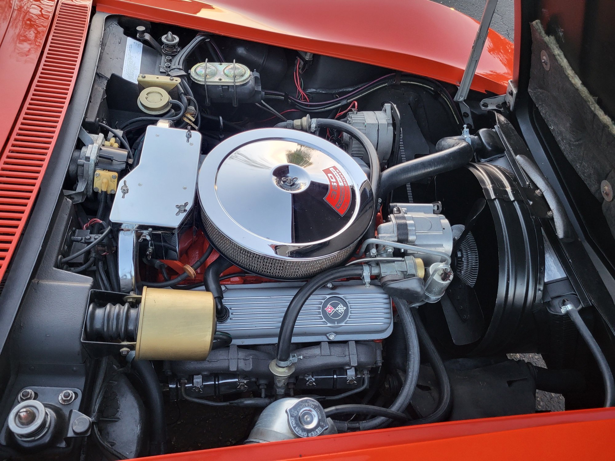

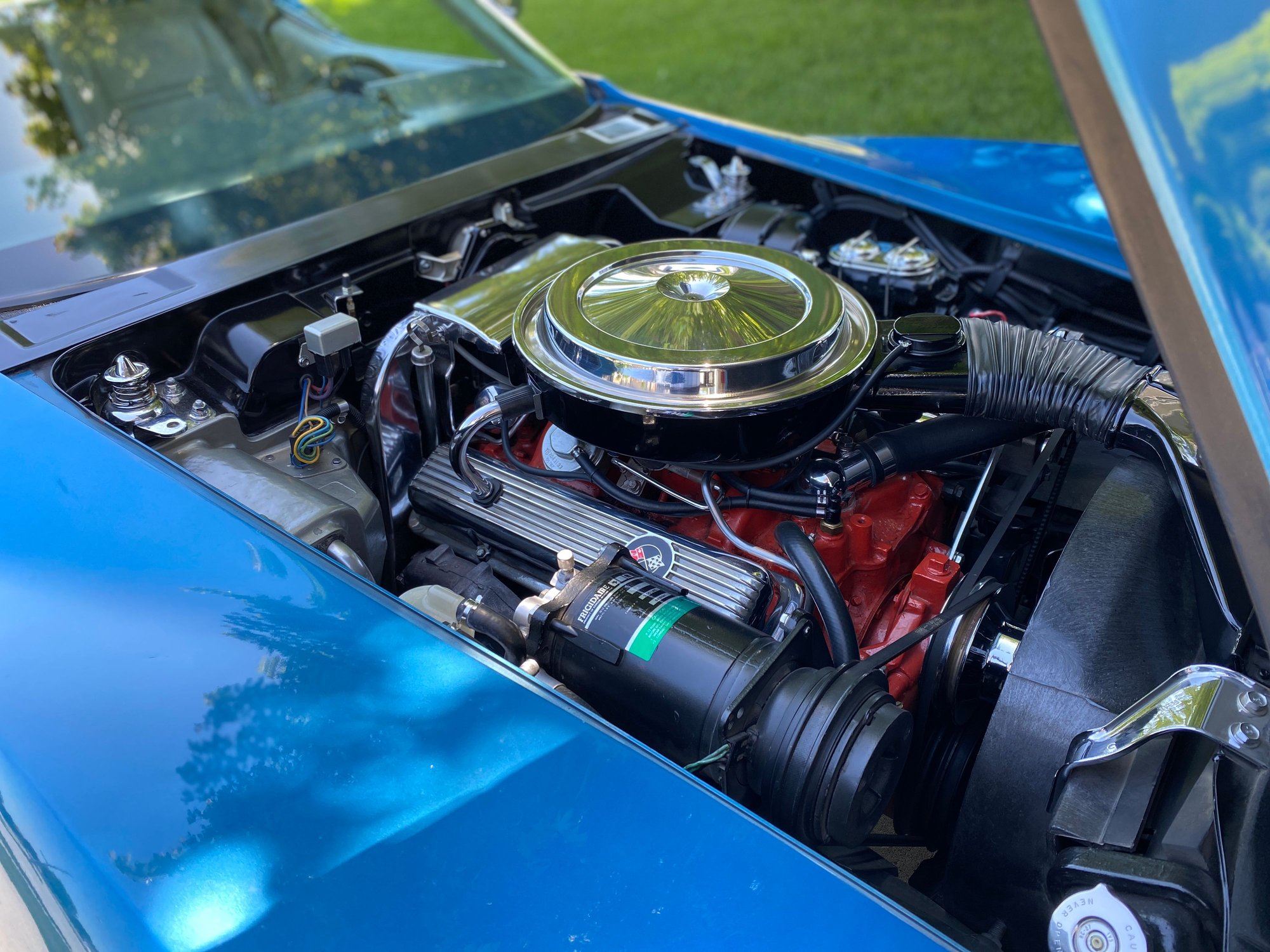

Originally Posted by SEVNT6
Nope, and I bought mine new.. In '76 anyway, all L82's came with a pump but not L48's...just Cali..
Neither california cars
69 L46
80 L48
