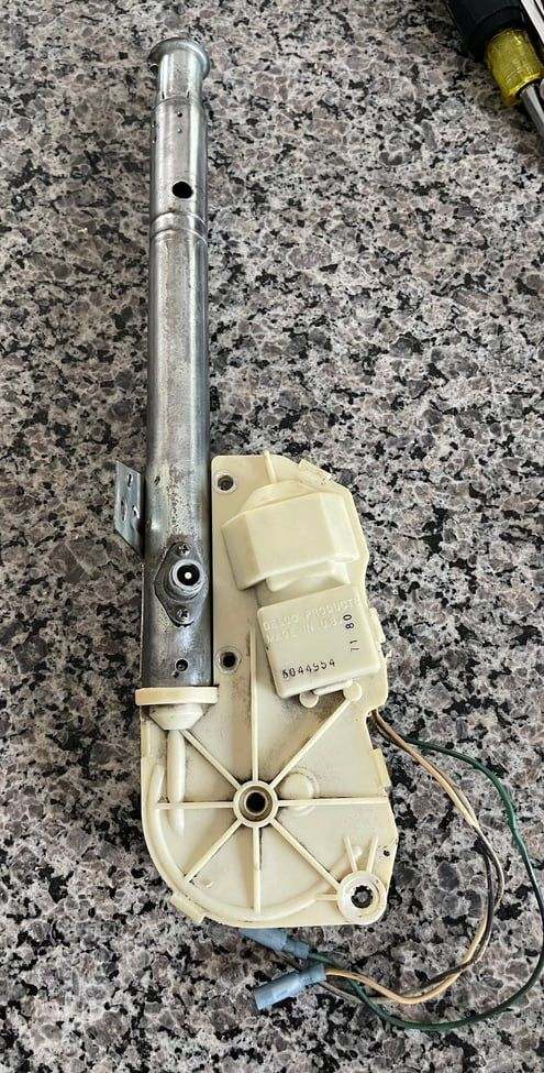

Time for a rant! One of the worst designs coming out of GM in my opinoin was their power antenna, both in design and placement. I have had to replace 3 antenna cables in the last year on my 82 CE. And the location is difficult to access. Anyone else had this pleasant experience.

Yes I’ve had to replace two of them. I finally bought a repo power antenna from Zip and installed a switch on the side of the console to control when it operates. I usually leave it up.
too much cycling up / down wears those cheap plastic cables to break.

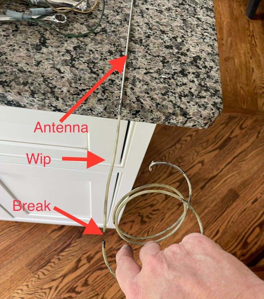

My antenna wip broke and I bought a replacement from “The Antenna Source”. I had my mechanic remove the antenna while he was doing other work, and reinstall after I replaced the wip. I like having original equipment that works but the idea of an override switch is a good idea.

How long did the original last? GM does not make the masts any more. They are all aftermarket. Blame the inferior quality on them.
Amazon Amazon
You can get a antenna like I did. Ran it behind the dash and tucked it between the pad and windshield. Virtually an invisible install. I have a radio and no visible antenna. If and when I get the car painted I will just have them fill in the hole for a cleaner look.

I’m not sure if you’re asking me or the OP. My C3 is a 1980 and the antenna mast failed in 2022. It appeared to be the original mast when i took it apart.

Back in the mid to late 90's we had a mid-sized Cadillac DD which had the SAME exact antenna as the C3. The original antenna mast lasted a long time. I can't really even estimate how long...b/c we bought the car used. But from what I could tell it was either an original antenna, or it would have to have been a factory (used) replacement. This was kind of pre-ebay...but it didn't look old/used/replaced. It could have been 10yrs if it was the original antenna ..before the mast cord broke in our ownership. Anyway, the first replacement mast I bought from GM and that too lasted a few years. But not 5-10. After that, I bought aftermarket masts which were avail for like $14 and said they were from the original supplier. They looked exactly the same as the GM replacement mast, which IIRC were like $45 at the time. They'd go about 2.5-3yrs it seems. But you have to remember, we drove this car in -20*F temps too which can make those plastic nylon masts crack. That antenna would go up and down a lot cause we used the radio (and tape player!!) constantly. It had a great Blaupunkt GM radio in it. Once the plastic gets old/brittle or cracks from the cold, the salt around here would help corrode the wire inside the plastic cord. Or the plastic would break at the plastic hook joint. I got pretty good at replacing them. I eventually started buying multiples at a time.
So, I don't have an explanation why yours would break in short order. The last masts I saw at a Corvette show parts place seemed the same grade/quality as what the original ones I bought ....were. But plastic specs can change...that ya wouldn't 'feel' by hand. But they've always been kind of a short-life units. Ford antenna units had similar issue once they got to a certain age.
