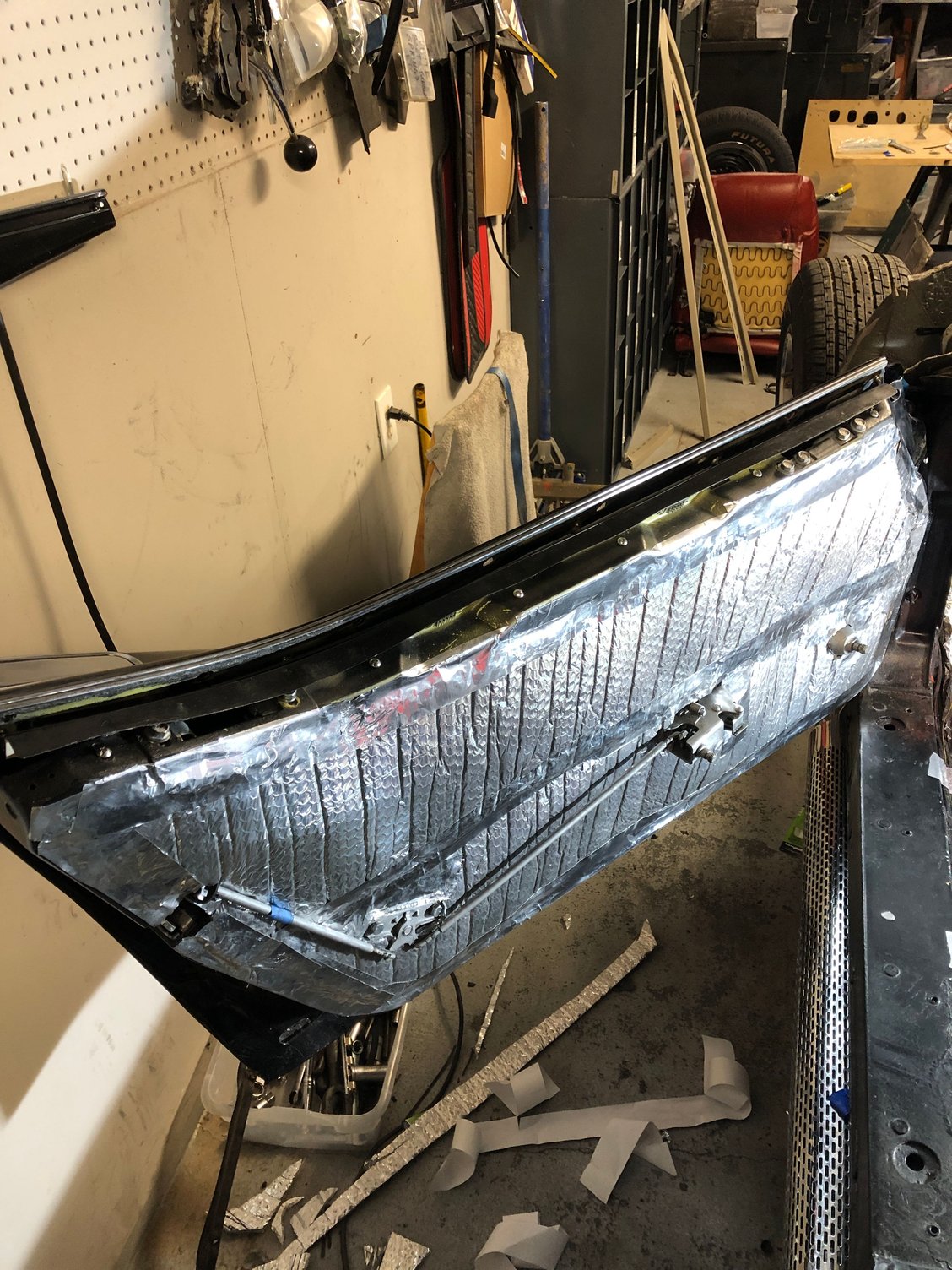

Problem solved........the insulation also solved the noise problems from the engine bay and from the tire/road noise
I also applied a layer to the INNER door skin which helped even more with noise issues.
The door without insulation actually acts like a cheap speaker sending road noise into the interior.

You guys have inspired me to do the extra upgrades that really make the car better to drive.
