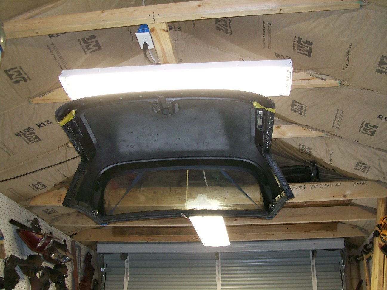

This method gets the hardtop within a foot of the ceiling.
Installing the 300# rated winch (More than enough lifting power) in the corner of the ceiling allows the hardtop to get within 6" of the ceiling. The corded control switch can be hooked/stored onto the wall until it is needed.....
6 years of operation/no problems. Just park the car in the garage with the door raised and mount the winch where the door will not contact the cable. (I have a roll-up door so interference was not an issue)
As other members said-mounting a pulley onto the joists, then mount the hoist onto the upper sidewall works well also.
I DID have to rotate the pre-installed light 90* and about 6" away from the hardtop
