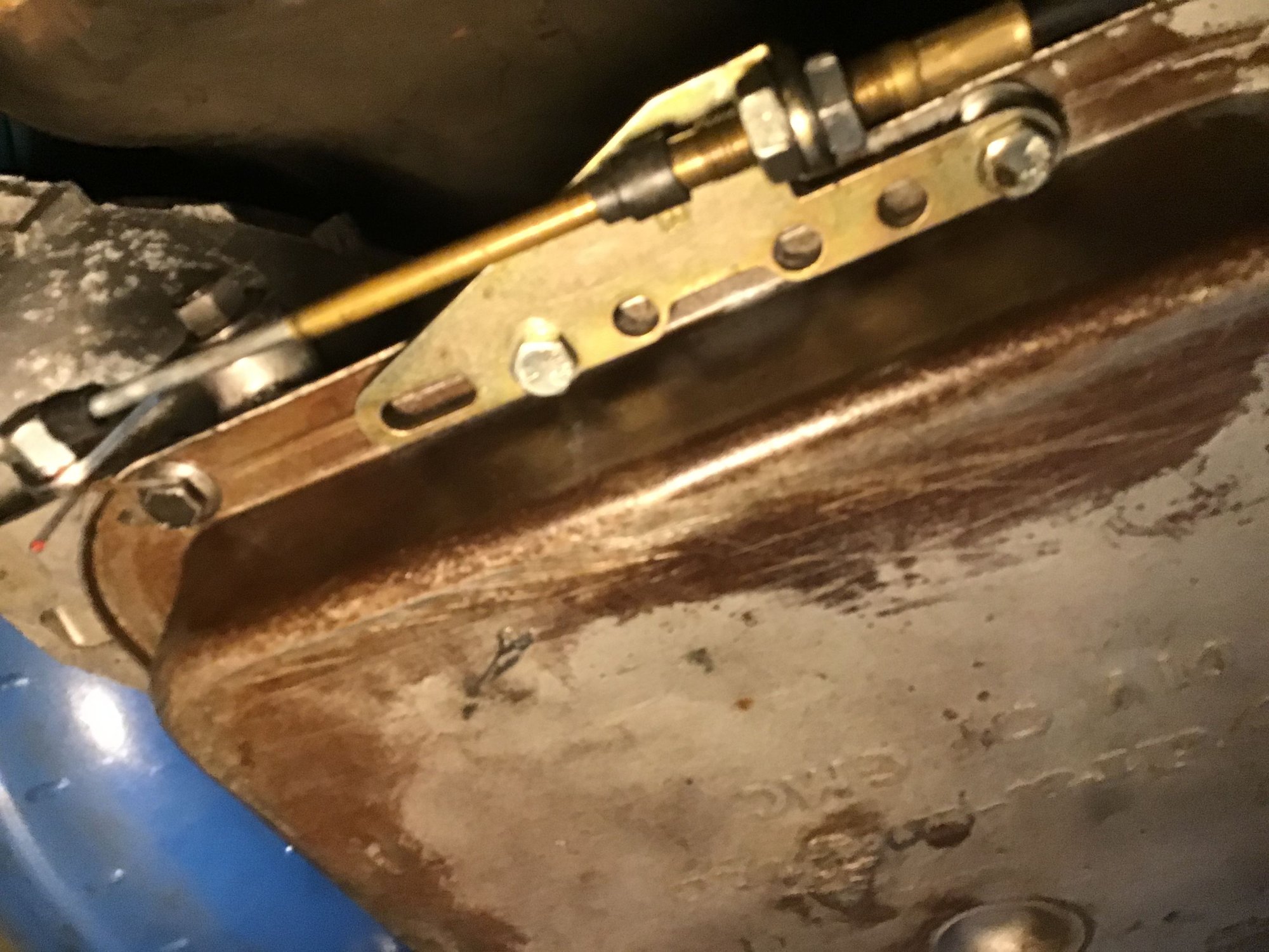

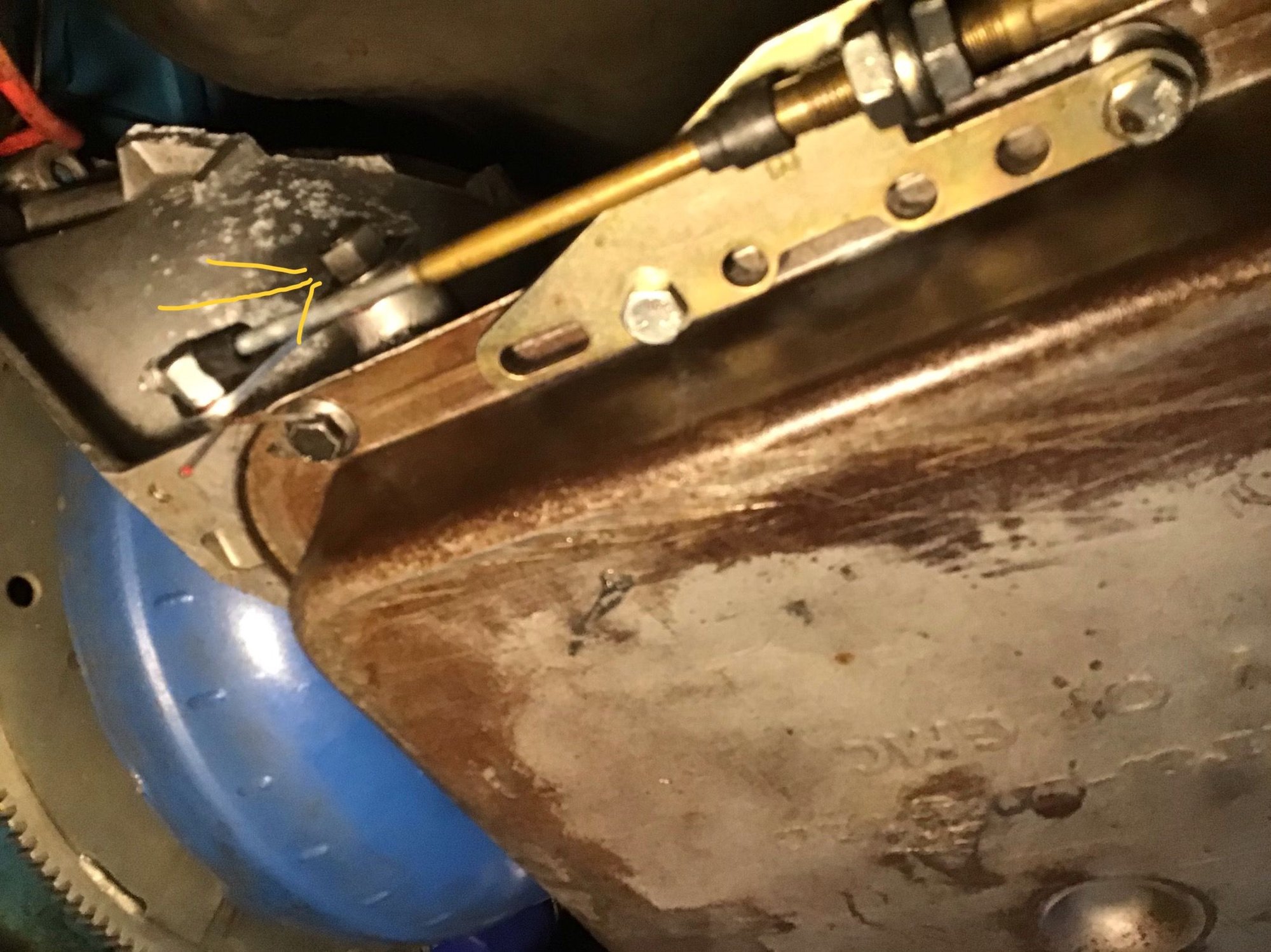

This is on my Pontiac I recently bought,I had a couple of transmission leaks,one coming from speedometer cable gear,so replaced it,now narrowed it down to the bracket where cable is hooked up,but is tight,is their a seal here or O ring.
Hope you can see arrow,but coming from between nut and housing.

There is a seal in there. There is also a tool to remove that seal without having to take the transmission out or apart.... as long as there's enough room to get it in over the shaft.

Thanks that would be the problem for sure.
