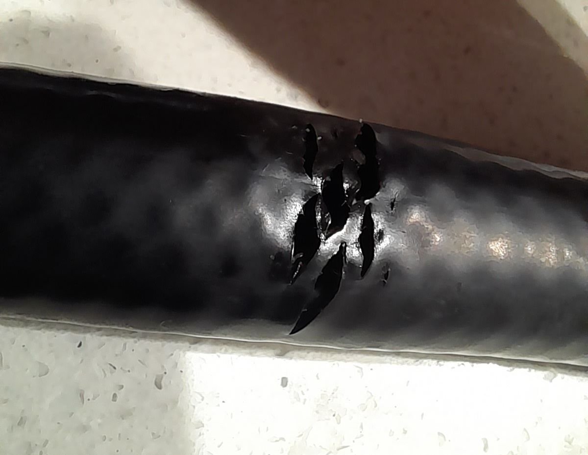

Let's look at failed hose.
I didn't print this on there! USA Made Rubber. Have failed more times than I believe I can count!
THIS! This is the leak! In the center of the hose! No where near a clamp! Those worm clamps work just fine for me!

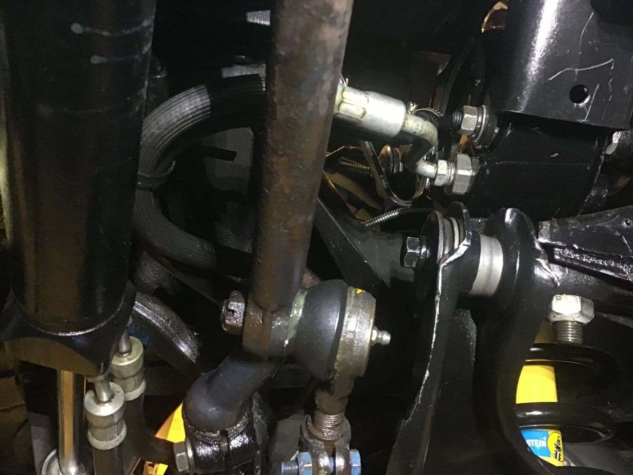

OK, so once again let's look closely at this hose that fails.
let's look closely. This is roughly right in the middle of the hose. Where most of the bending accurs.

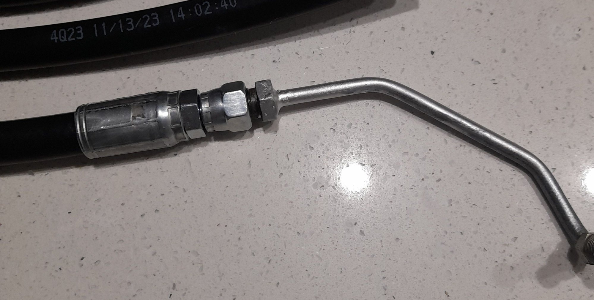

left my lines with him. One slightly used high pressure line. (Special thanks to Craig). And one brand new return line.
A couple hours later, he sent me a text. Ready to pick up. Much quicker than ordering lines from the States.

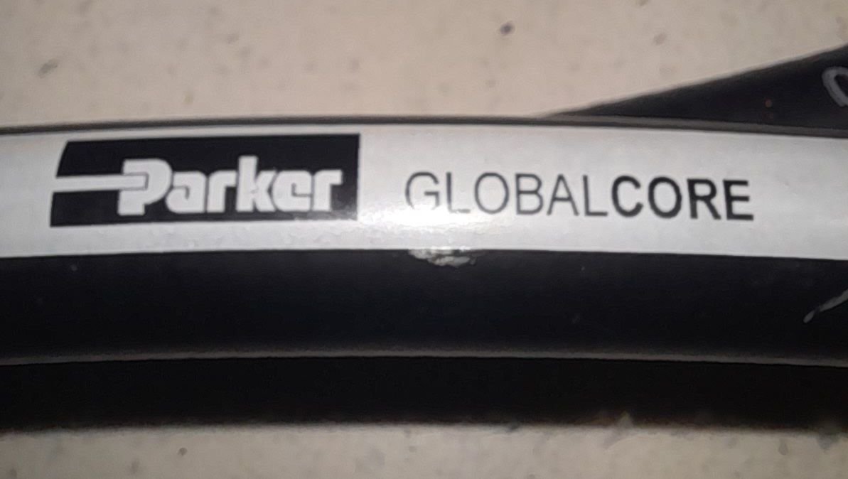

This is what I received. Please note a USA hose on top for reference.
Much heavier duty.
Check this out. He put a swivel on the high pressure line so I can get the alignment just right!

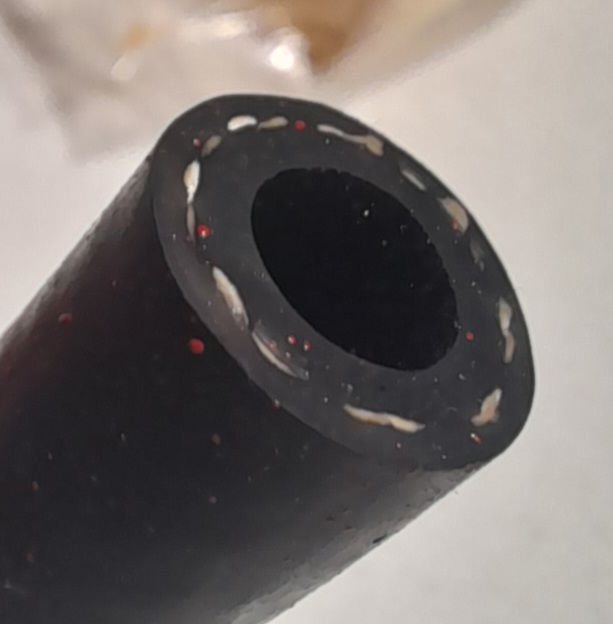

End view of the Goodyear hose. Note the cloth type reinforcement.
End view of new hose. High pressure liner and stainless steel reinforcement to prevent kinking.
The man tells me this is the good stuff. NOT made in the USA. used on heavy earth moving equipment.
I asked him if it would last 15 years. As then I'll be 80 and my boys can worry about it then.
He confidently told me. You'll never have to buy another PS hose again!
Hoping so!

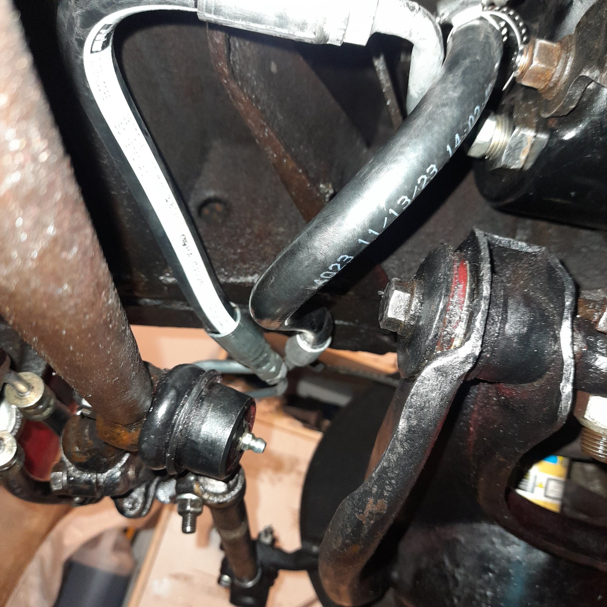

OK, Got my Super Duty PS hoses installed, bleed up and tested for leaks. Here's some installed pic's.
Hoses at left full lock.
Hoses at straight ahead position.
And full right lock.
Hard to get really clear pictures. But I can assure you that nothing rubs or kinks.
You can see from full left to full right there is a huge change in the lines. The swivel in the high pressure line was really helpful.
Now I'll have to set my alarm for a year from now to fill you all in!
Oh, and by the way, I really like that fat stainless worm clamp.
