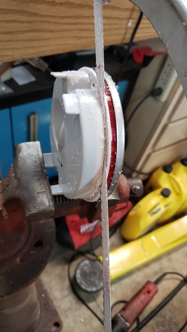

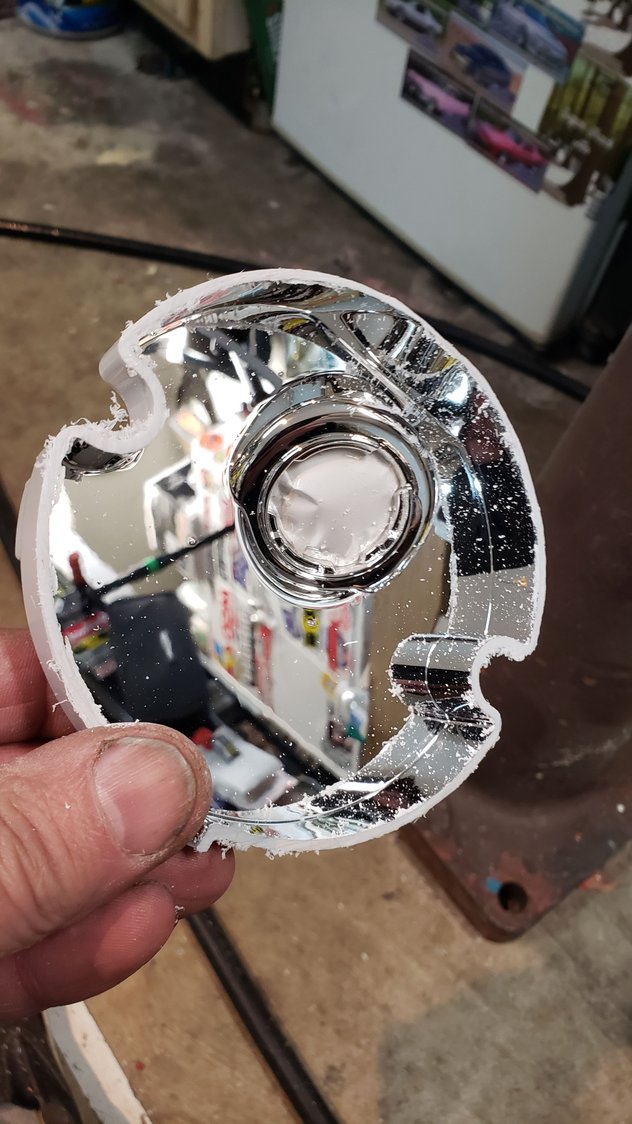

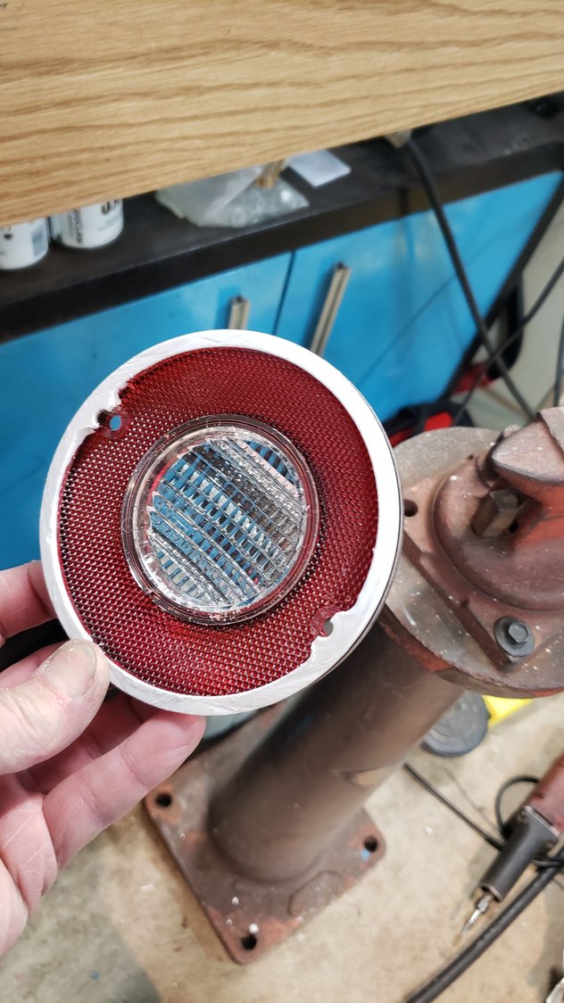

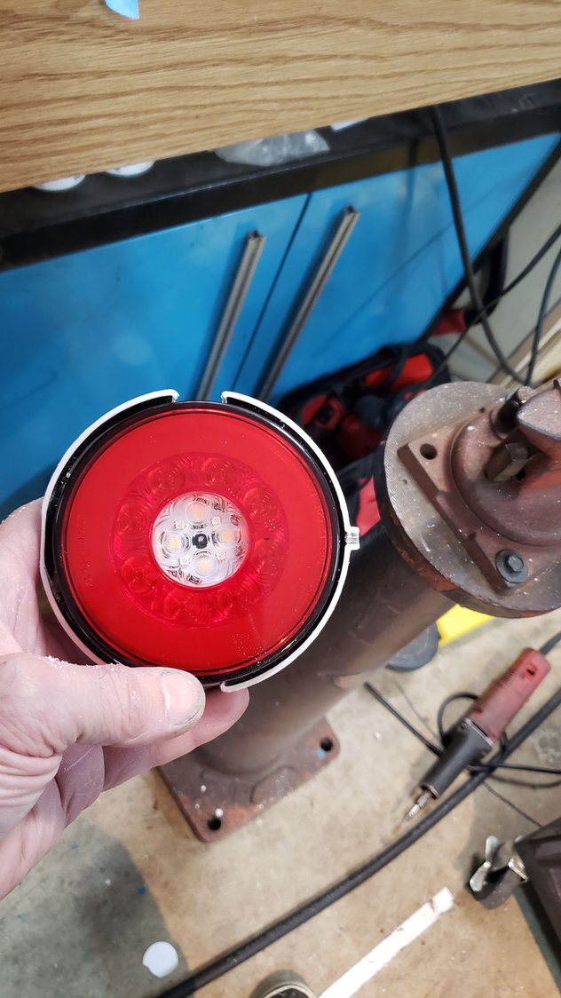

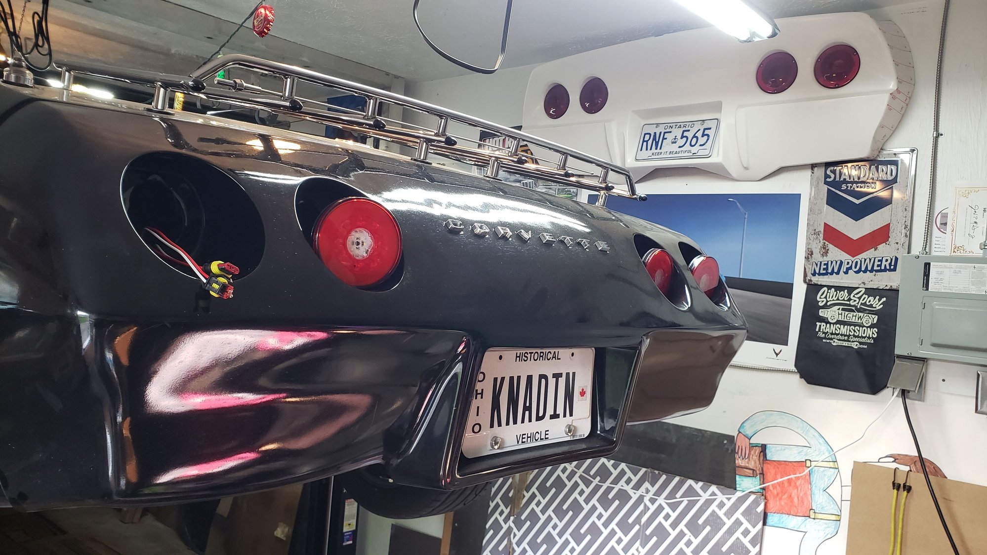

I'm always playing around with ideas for cool updates on all my vehicles. This is on our '75. Got new lens for it, ( '75 has one piece light style ). Then found bright LED truck lights that have same diameter.
Cut my new 75 lights in half and trimmed them to accept the truck lights inside.
Glued them back together.

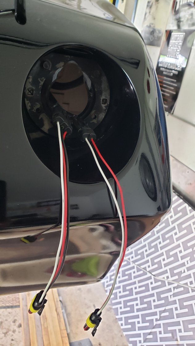

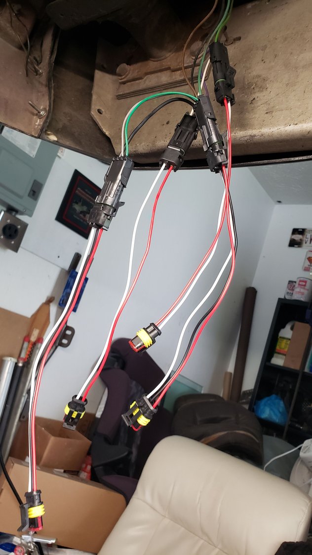

Then wired it all up using weather tight connectors. ( this way it can all be easily reversed to origonal if someone wants )

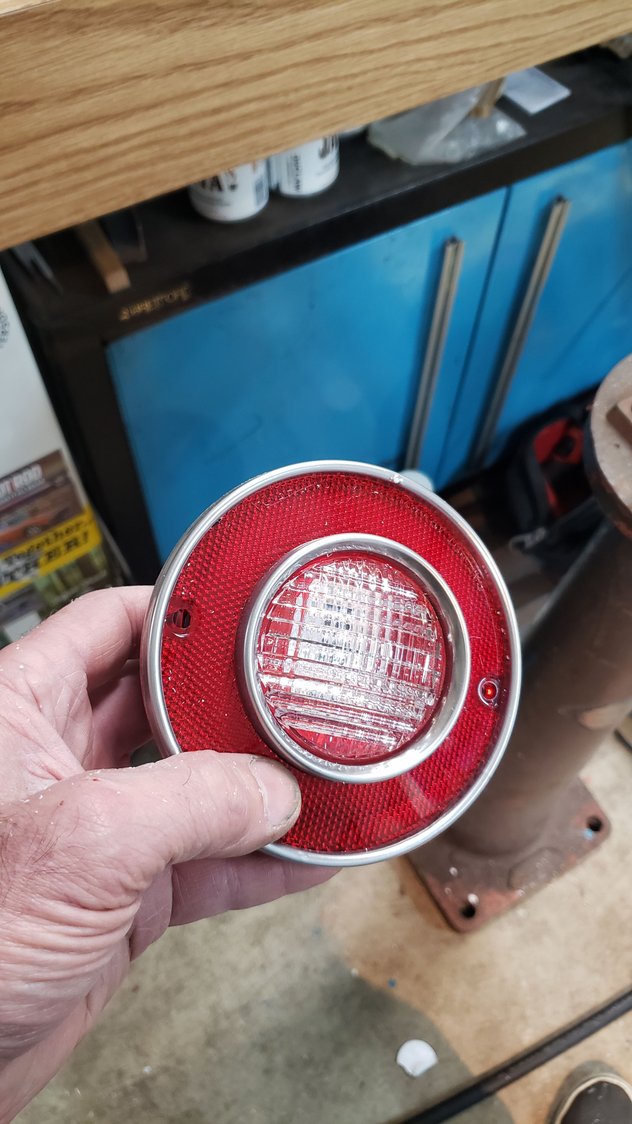

It turned out great, and now I have super bright tail lights, turn & brake, and reverse lights in all four lights.

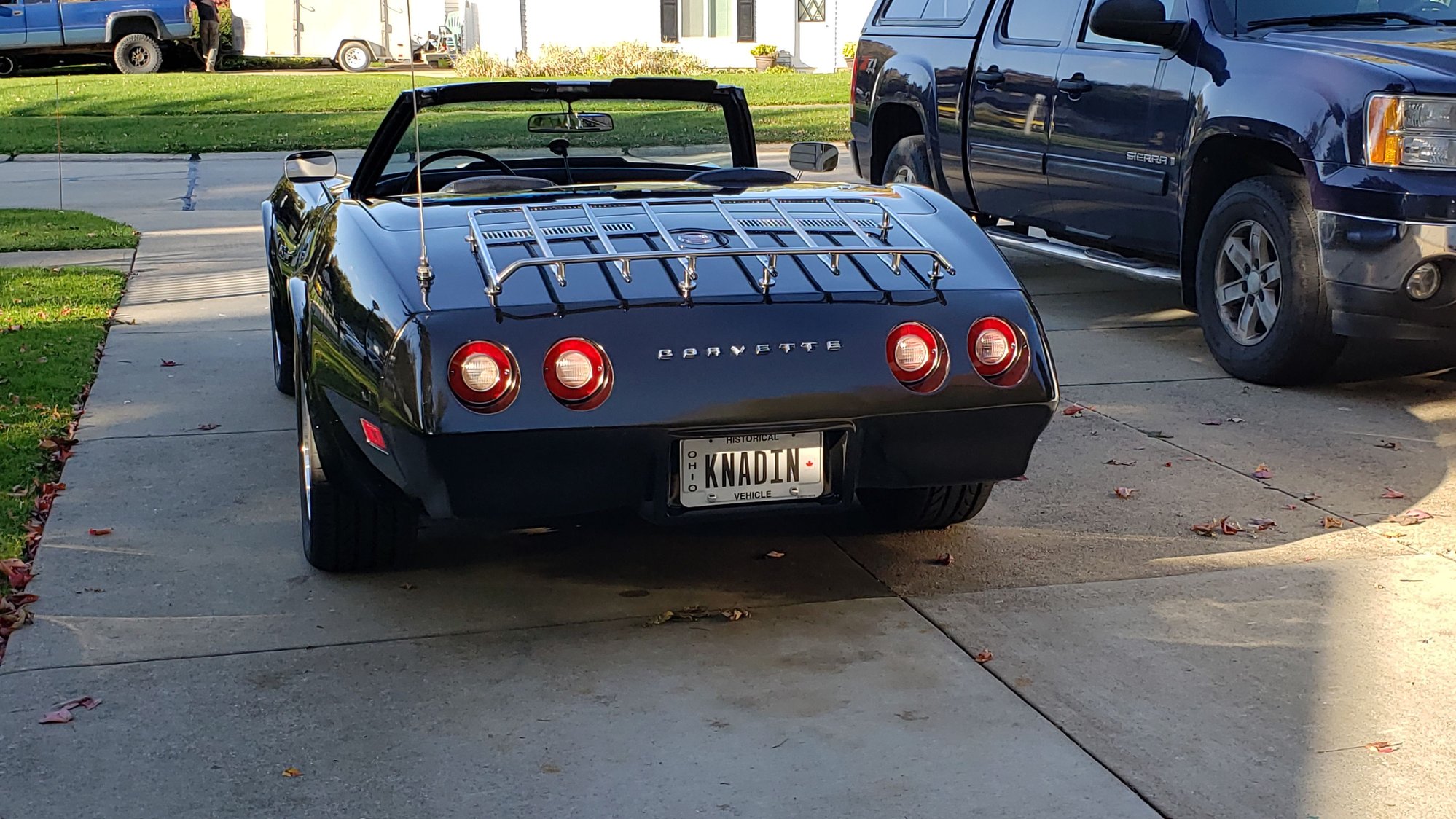

Here are some pics of it I'll share. I haven't any pics of them functioning yet because my phone doesn't capture the lights well. Ill try for those again soon.
.Happy motoring to all,,,
This last pic is with lens installed and completed. I'll get pics of them illuminated soon...

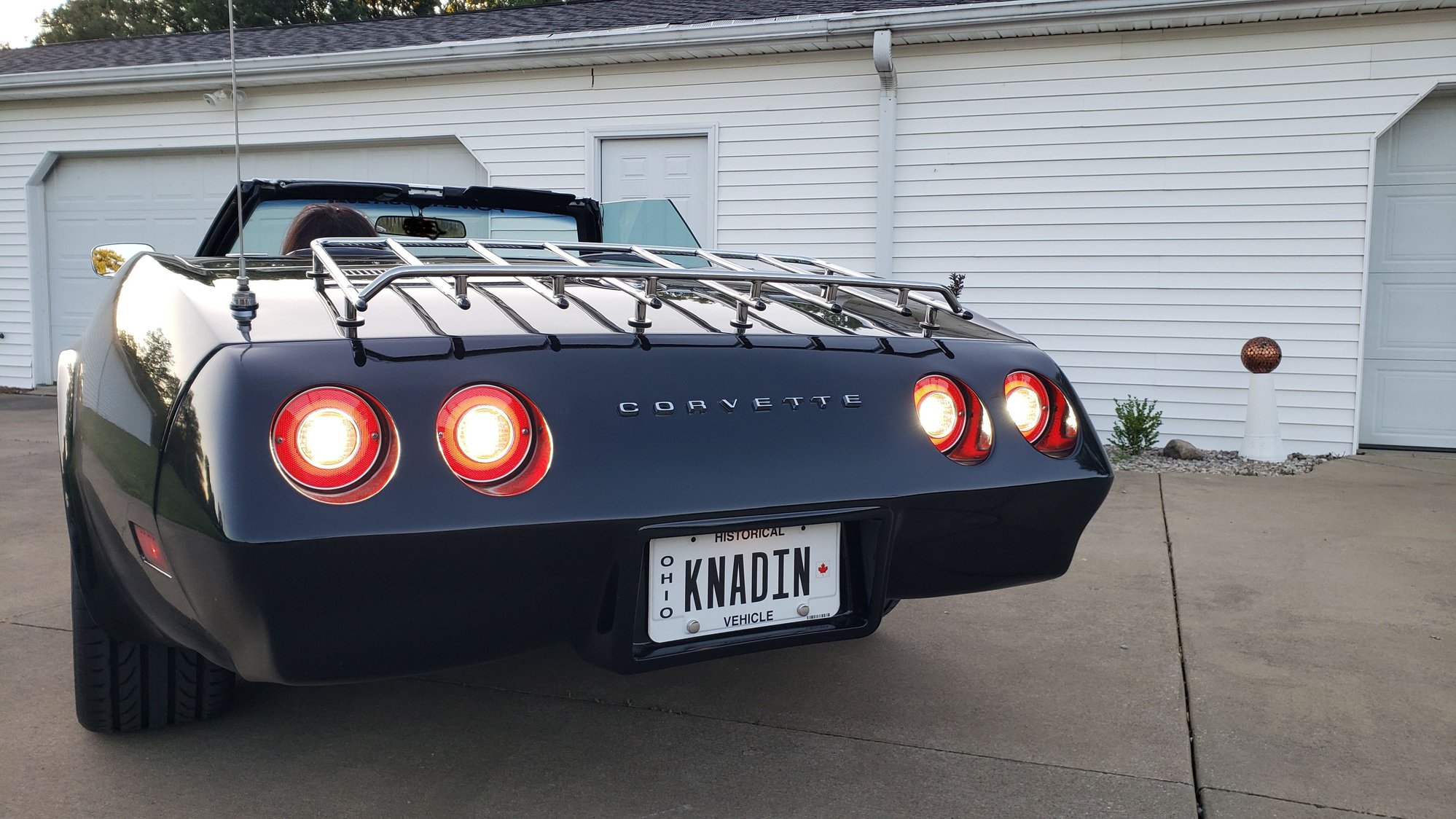

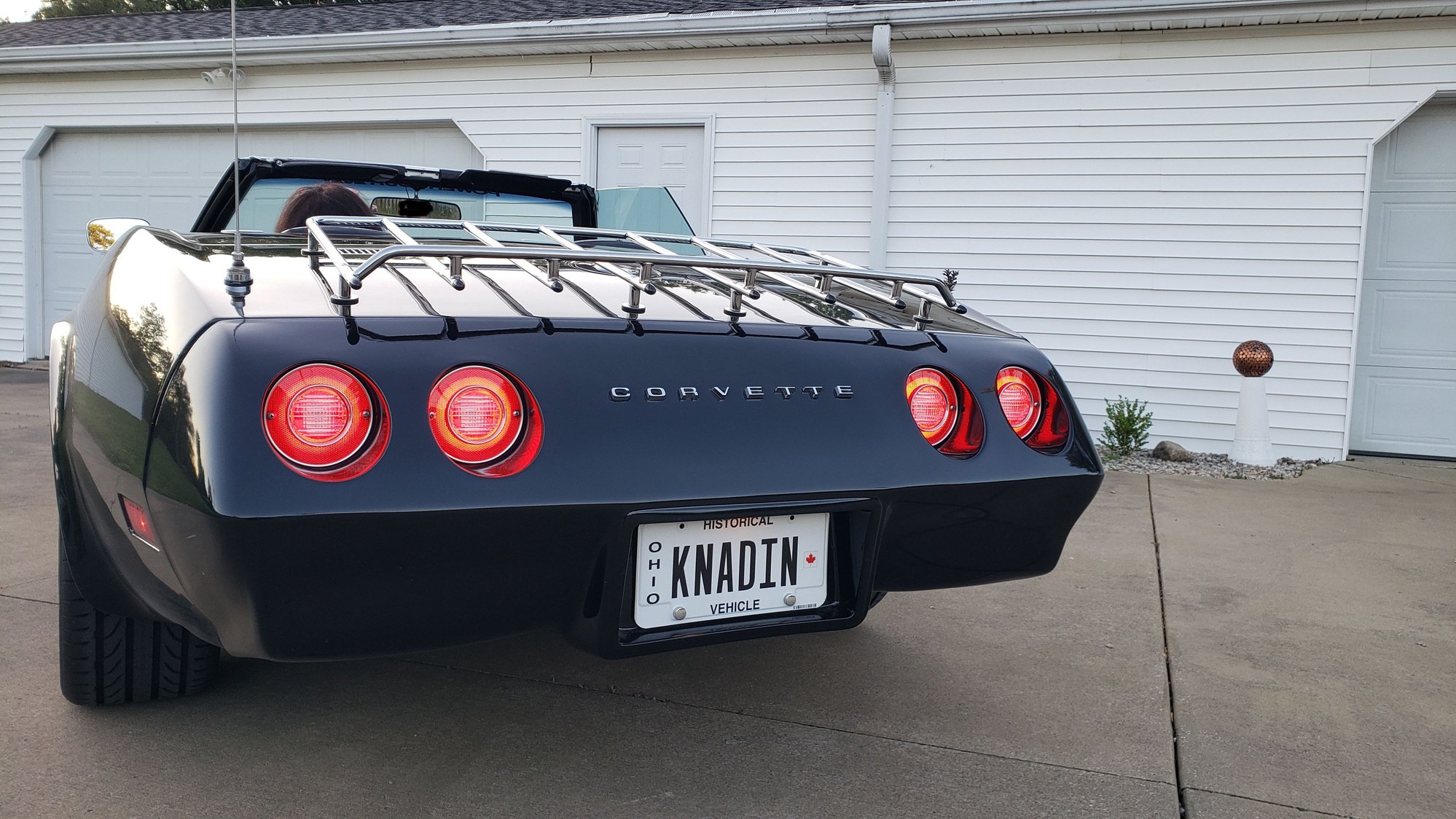

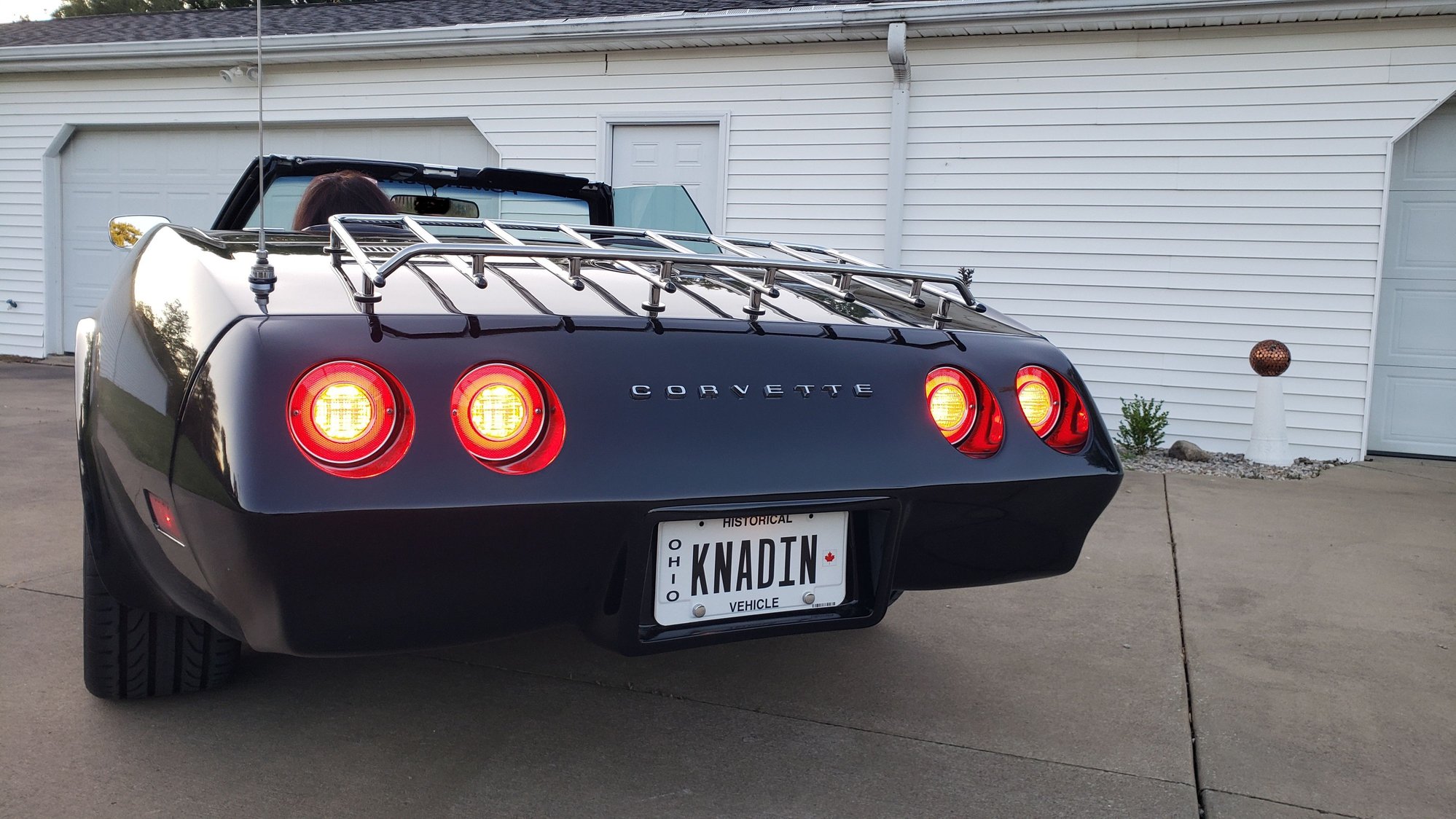

I finally had a chance to try and get some pics of the lights on. They are super bright ,, im likeing them....
,,,,,,,,,,,Tail lights,,,,,,,,,
..........Brake Lights..........
,, ,, ,, ,, ,, Reverse Lights,, ,, ,, ,, ,,
