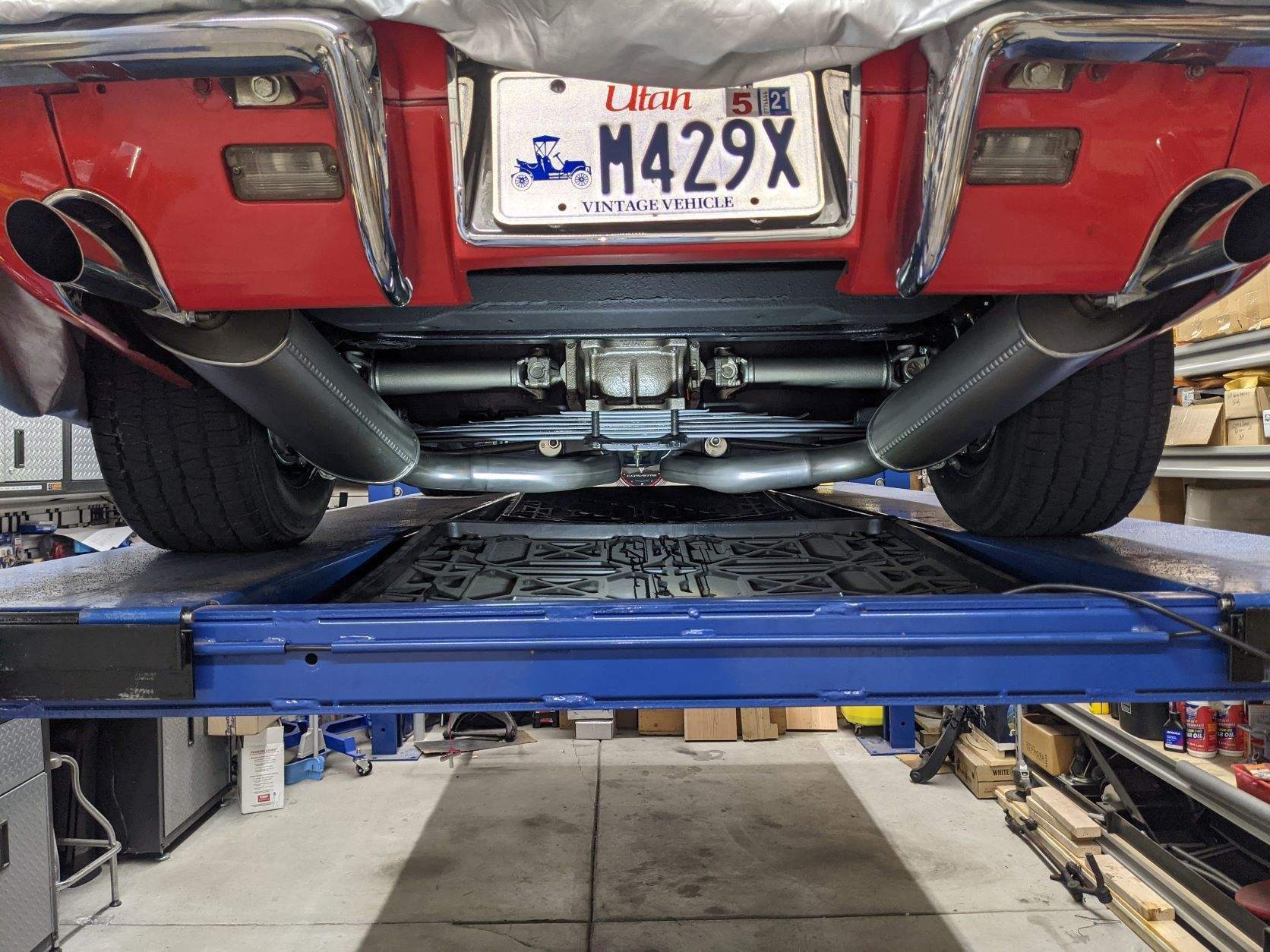

I did the N11 from CC. No issues with fitment at all. I wish for just a bit more 'noise', but it's very good. EZPZ and I was expecting problems. Best, Paul
