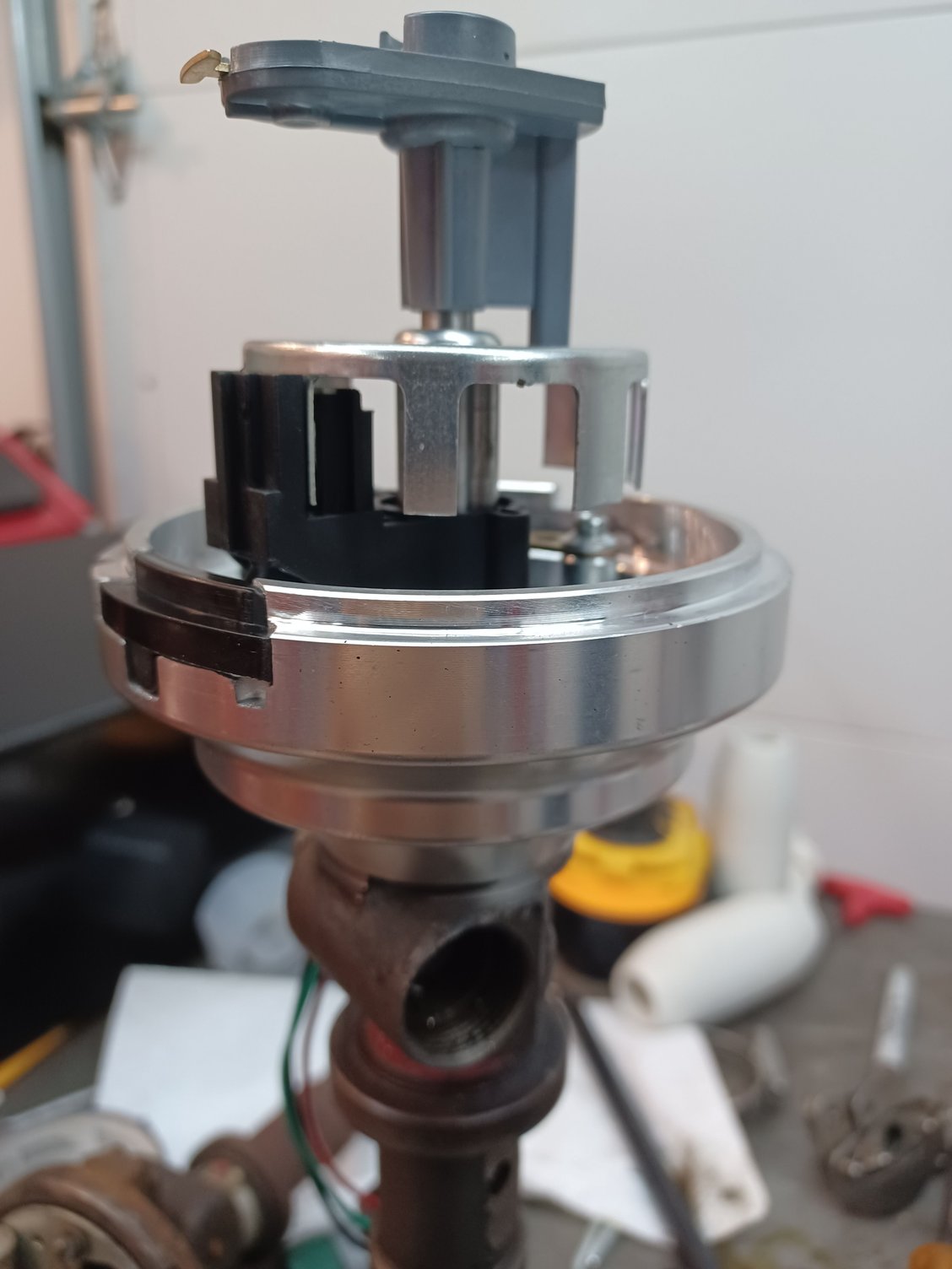

I just finished converting my C2 stock tach drive distributor to accept an Edelbrock Pro Flo 4 electronic EFI distributor top. See pics.
Machined stock bowl to fit EFI
Tapped hole partern alowes top to be positioned anywhere.
Installed, see tack cable position.

Wow. Impressive. Did you have to machine the cast iron? And fabricate that collar? Is the collar screwed onto the cast iron? Very nice.

No, I machined off the cast distributor bowl and turned down the diameter to fit the Edelbrock top. The Edelbrock top is screwed onto the cast base. I drilled and tapped 12 10-32 holes into the cast and added another set of 4 holes to the top piece. I had to use the original C2 shaft as the Edelbrock for some reason is a bigger diameter. This allows me to rotate the top to wherever I need it in relationship to the bottom, and screw it down.Over all, it is was a lot of work but in the end it was worth it and a lot of fun, especially when it fired up the first time.
