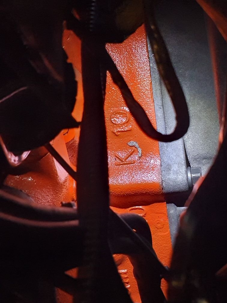

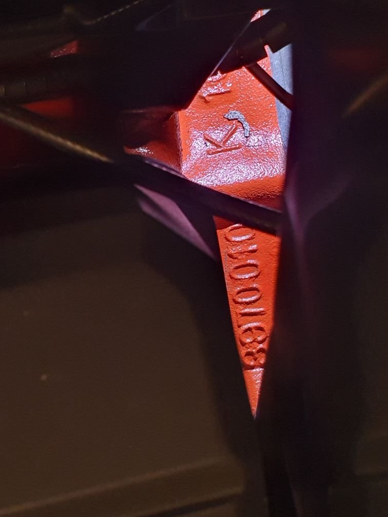

Thanks for your replies! Below are photos of the markings on the back of the engine.

Looks like it was a CKL stamp prior to the restamp.
CKL 73 350 145 2B,TH CH,EC,MC,PA

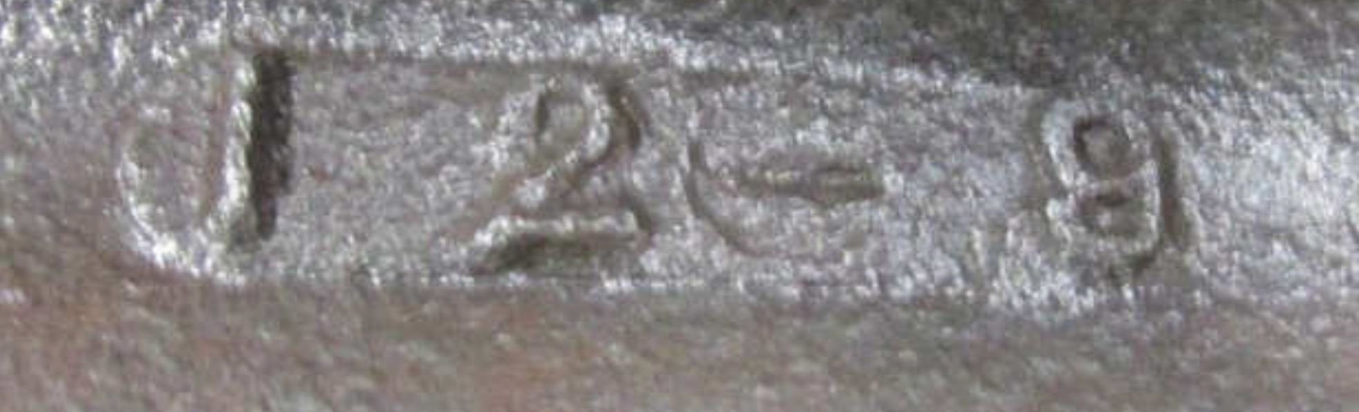

Thistledew, on the other side of the rear flange should be a long oval casting mark with a date code in it. Can you take a look for that?

An example of what 67-72 is asking for.
