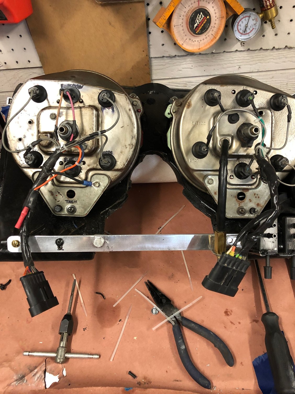

Hey guys. I’m replacing the gauges in my ‘68, and I keep finding conflicting information. I need a wire that is hot when the lights are on - to light my gauges. Where I get confused is some people call it a curtesy wire and some call it an interior wire. I thought curtesy was when you opened the door. I would check on my aftermarket radio, but it does not use a wire for illumination.

The grey leads to the instrument dash illumination lamps are hot when the lights (Parking or Head) are turned on.
I think that is what you are asking about?

Yeah, just something to tell the gauges when to light up. So, it’s the grey one?

There are multiple grey leads..... each illumination lamp has it's own grey lead. Maybe I am not understanding what you are asking?
The interior "courtesy" lamps illuminate when you open the door. ALSO, when you turn the lightswitch **** fully counterclockwise BOTH the following will illuminate:
1. the interior "coutesy" lamps will illuminate
AND
2. the backlights on the dash will also illuminate.

Yep....gray
(ignore the quik disconnect plug
