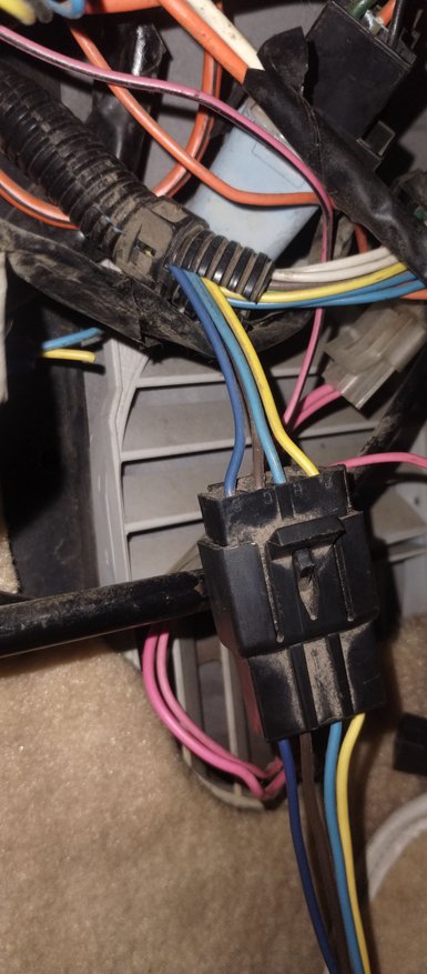

I am working on my 78 Corvette and have a few wires that are broken and do not know where they go. One set of wires is light blue and dark blue the other is yellow and brown. I will add pictures tomorrow. Any help is welcome.

Speakers?

Originally Posted by RickM Z06
Speakers?
My guess as well!

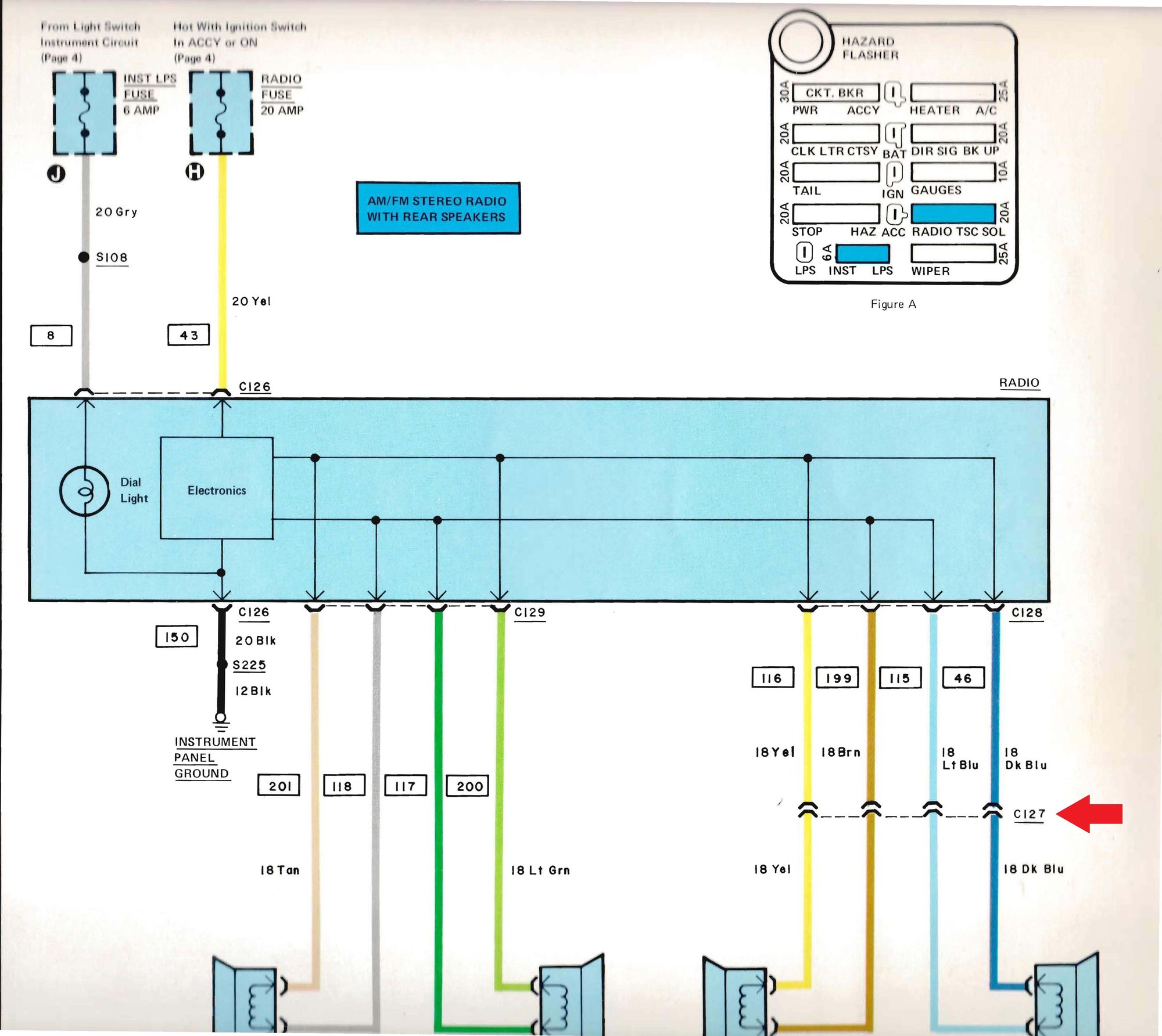

Wiring diagrams:
https://wordpress.keystonestatecorve...m/?page_id=118

I have checked the speakers they are all hooked up and working.

My Guess,
C127 (C=Connector) was located around the left side of the instrument panel and if you had the rear speaker option...
Old May 30, 2024 | 05:32 PM

Thank you for the help it does seem to be the rear speakers. I didn't think to check those.
