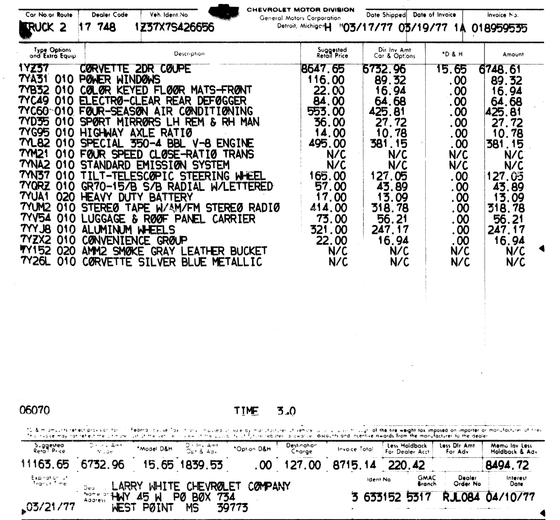

Greetings lady's and gentlemen,
In my quest to gather documentation for my 77 I Gm to send me the build sheet and its fairly readable !
and i was wondering if you folks knew if any of its options are rare and i should pay special attention to or if its just standard fair.
Second bit that is probably more suited for the Tech section , if im reading this correct it has the BorgWarner M21 close ratio trans- Im not a manual guy that's where they keep the magic and pixies - i found a chart giving me the ratios but i dont know what im really looking at. can someone point me in the direction of some resources so i can learn.
build sheet

L82 4-speed! If you are going to keep the stock drivetrain, that's the one to get.
G95 and M21 were both very rare options that year. The vehicle information kit (available at the same site that sold you that dealer invoice), has more info, including available and transmission ratios. You'll have to look up (or measure) what diff you have (3.08 or 3.36 perhap), but your M-21 should have a 2.43:1 first gear.

im hoping to keep the stock as offten as possible in my resto but when ever it becomes unreasonably expensive to order a part then im going to mod it - Ex cost of control arms is nutty same price i can retrofit the front with coilsprings ( still undecided here )
if im reading this right with the 2.43 it would normally be 3.70 but they paid for the G95 so it should be 3.55 ?

Perhaps. I'm not really sure. 3.08 is a great highway gear (that's what is stock in my 80 4-speed). I'd go measure your diff if you can (easy on jackstands, or math in 4th on the highway with GPS speed on your phone). There's also a code (and lots more interesting codes at this site), but since axle ratios can be changed, it's still best to measure.

Since it says highway axle ratio it must be a 3.08
