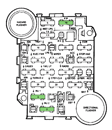

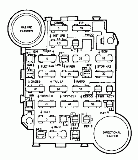

Check the fuses for the pump

Like mentioned, why was the pump changed? Obviously, the pump wasn't bad or it would be running. My guess is, that whoever you have/had working on your car does NOT know anything about CFI, like so many other so called mechanics. The first thing I would suggest is to purchase a GM service manual and start reading it. It has lots of great info in it to troubleshoot your 82. P.S. Shotgunning parts is NOT troubleshooting an issue, stop doing that unless you just want to spend more money needlessly.
One more thing. If the motor cranks, but doesn't start, check the 30amp fuse in the battery box in the right back corner. If it is bad, the motor will crank, but will not start. This fuse is the direct dedicated fuse for ECM power. It will crank, have spark, but no fuel because there will be no injector driver power...hence, no start.
Also, like posted. Check these two 3amp fuses for injector #1 and #2 to see if they are good along with the fuel pump fuse. Also ensure the terminals are clean. GL
