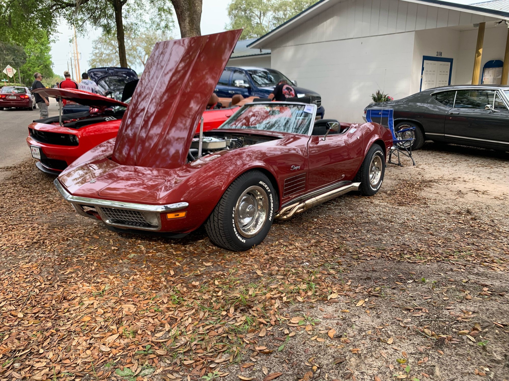

Be aware that there are also only 2 size choices to keep the speedo reading correct: 215-70r15 (most closely matching original F70x15) and 235-65r15. These diameters ( 26.9" and 27") most closely match the original tire which is what the speedo gear is showing. I went with 225-70r15 for the BFGs on my '72 a couple weeks ago (27.4" diameter) which causes the speedo to read slower than actual. It's no concern around town because the error is only a mile or two/hour but at highway speeds it's close to 5mph off. I use a phone app to monitor speeds for both of my Corvettes rather than the speedo.
