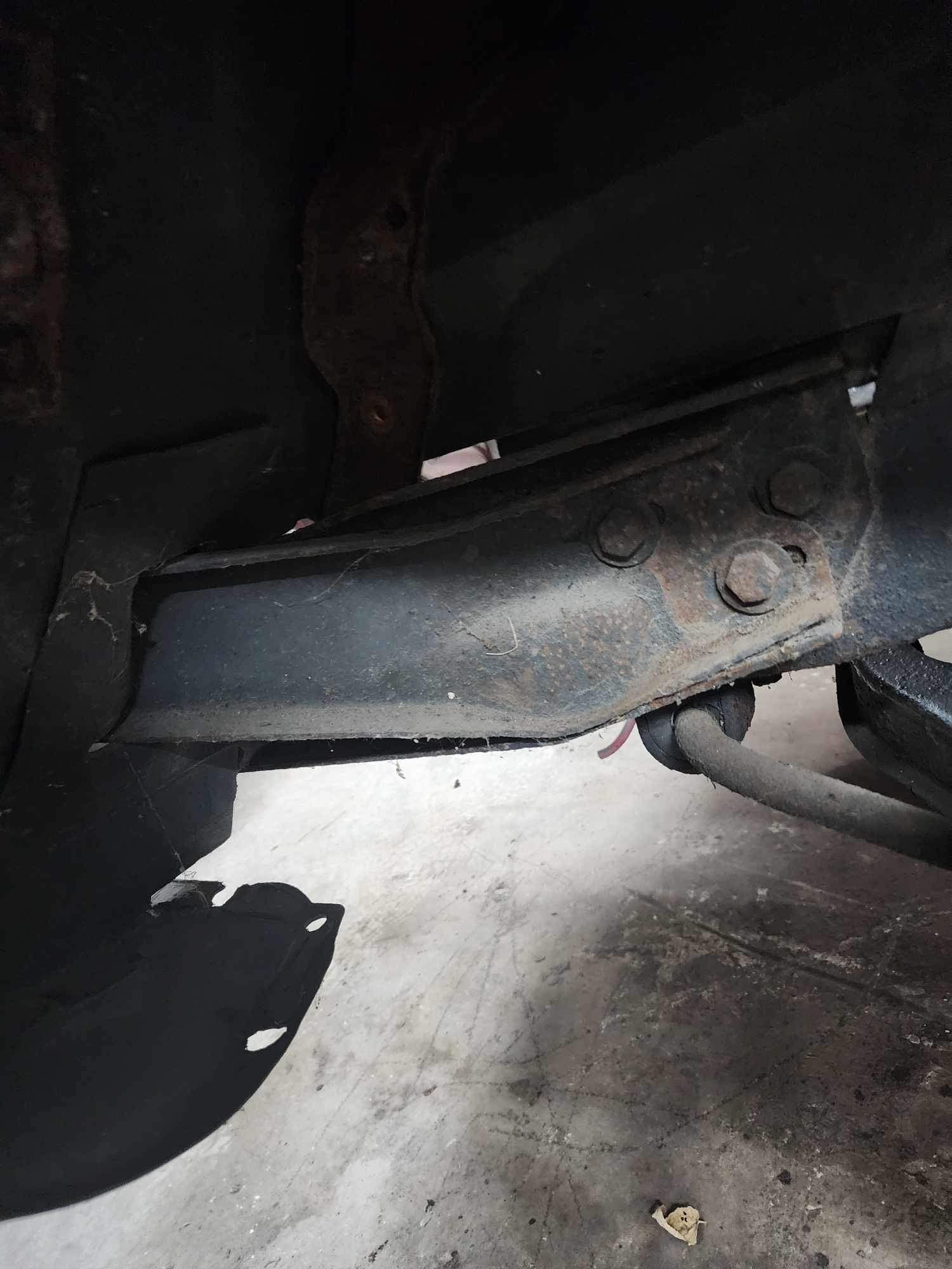

Hello all,
I'm hoping you guys can give me some insight into if the car is worth buying and patching or replacing the birdcage or not.
Back story is a few months ago I went to go look at the corvette and was going to trade a Harley for it (Approximately 9k value). The car looked great for the most part but following others advice I asked if I could remove the kick panels to inspect the birdcage and it was rusty with holes. As soon as I seen that I told him I would have to pass based on the work required to fix it and the owner had no idea of the rust there. He said he was driving it a couple years ago and he parked it to do some engine work.
Fast forward a couple of months and I messaged him to see if he still had it and was interested in selling it. He said he was and we settled on $3200. I’m supposed to be picking it up sometime next week and wanted to know your guys opinions if it was worth that much and if it should be a mission to save it or part it out. Any and all advice is welcome. I’ll attach the photos I got when I first went to go look at it but sadly didn’t take any of the rust behind the kick panel. I will update with pictures later after I pick it up. Thanks for any and all replies!
Also, based on the VIN and his information I believe the car was originally a 350 4speed car if that helps the decision to save it.

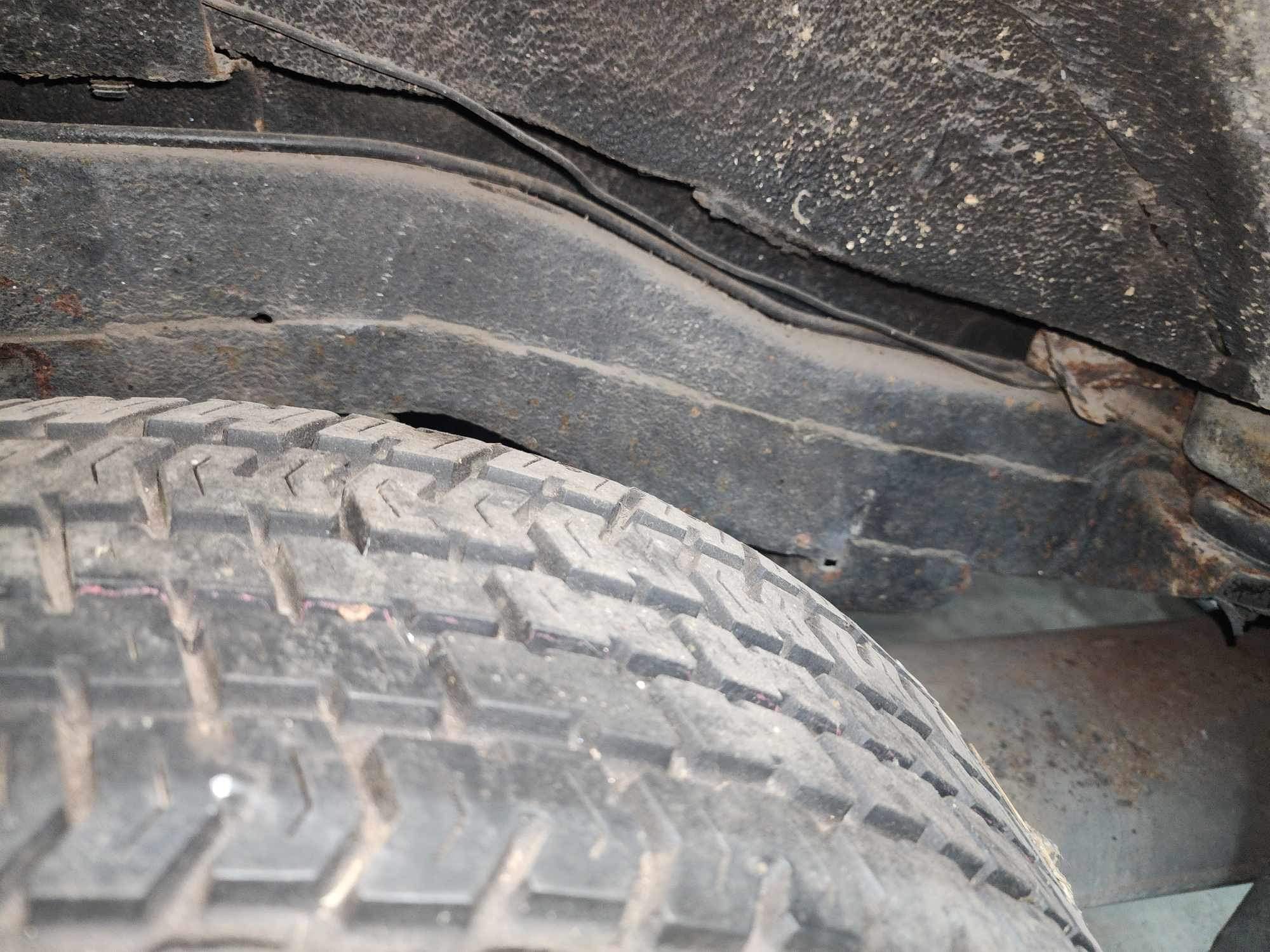

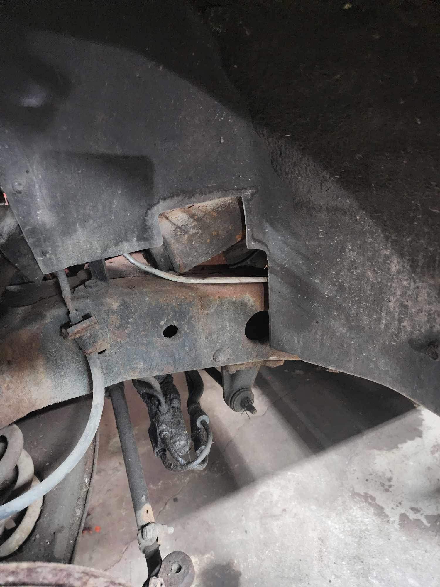

Frame doesn’t look that bad..check body mounts and windshield area..pic if vn may tell something too.

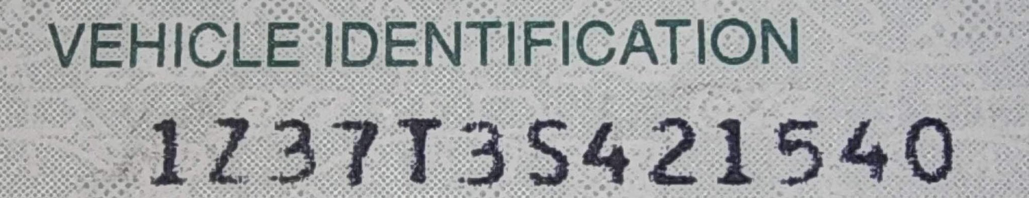

Thanks for the advice, I’ll attach a picture of the VIN now.

the birdcage does not need replacing, but you can buy replacement sections for parts of the frame that have rusted-through.
IF you plan to keep the car...rebuild it. Otherwise it will cost you several thousand dollars to make it safe enough to sell.

Sometimes the vn area may show corrosion around it on a pillar.

I agree: for the most part, the frame looks fine. However, you didn't show pics of the frame in front of the rear wheels where it "kicks up". That short vertical section where the trailing arms bolt is subject to heavy rusting because of the pocket the arms sit in - dirt (and moisture) collects in there.
Will you post pics of the A-pillar body mounts? I'm surprised that you said it was full of holes while the rest of the frame looks pretty solid. From the exterior, inspect at the top of the windshield just below the bright trim. Examine it all the way across and about a foot down from the corners. As interpon mentioned, examine the structure right around the VIN tag on the driver's A-pillar. If the body mounts down below are compromised then I'd think everything above them would be too.

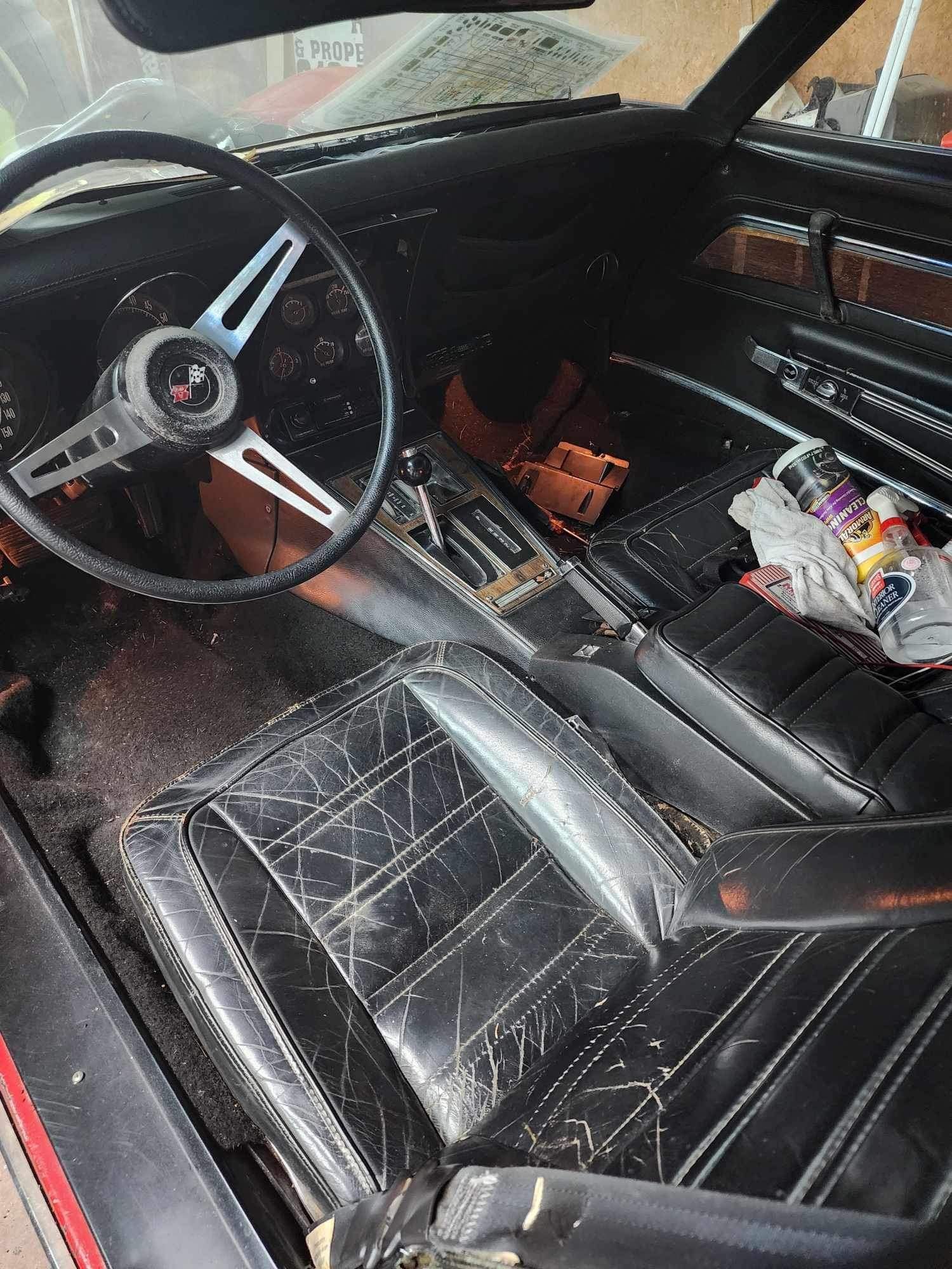

Why do you think it was a 4-speed car? It appears to have the correct bolt-in crossmember, deluxe console, and pedal.

if the only real concern is those number 2 mount areas. They are realitivly easy to repair with replacement sections. Windshield frame and those lower corners of the windshield frame are a much larger concern.
is it worth fixing?
That's totally up to you. It's a great hobby that'll keep you busy and out of the pub.

L82, deluxe interior, coupe, AC, pwr Steering, pwr brakes, auto.... Other than the color, its the same as my car. Whats not to love?

Don't go falling in love yet. you haven't shown the edges of the windshield nor the are behind the kick-panels..... nor all the other viewable body mounts. You should get pictures of those and post them.... and a picture of the area around the VIN somebody already asked for.

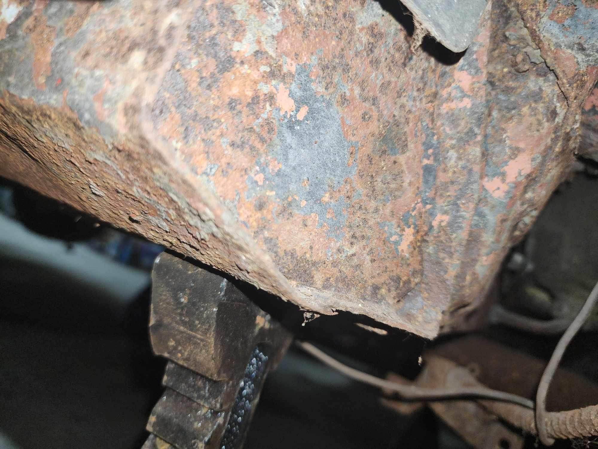

My thought is, not to squash your dreams, but to give a reality check: Do you have 500-800 hours of your life to dump into that car? And maybe the next 5 years? You're dreaming of what it *could be*...and not looking at ALL the time it's going to take to get it good.
I can see it needs a lot more than bird-cage work. If you don't have fabrication skills, time, patience or deep pockets (for parts), to redo the front,, the nose, COMPLETE refinishing (if it needs it...maybe it's not too bad, I can't tell), the freekin' interior, engine work, fix the broken headlight assemblies, new suspension bushings/ball joints, complete brake work, renewed steering, new wheels and tires, new carpet, new door gaskets, maybe new tops ...and everything else ....and buy the hundred expensive parts it's going to need, ....stop right now, back out of the deal, find a better one for $8k-$10k or whatever that's got good paint, driveable, looks nice .....and enjoy it all summer long. Seriously. Unless you have 500-1000 hours to dump into that car. It looks like it's got the usual 5 coats of paint that needs to be completely stripped off and completely repainted. That's TIME consuming and costly. And if you had to pay someone, you'd have far more into the car than it'll ever be worth.
People think parting out is good ....but If you REALLY count your time, including taking off and cleaning the parts, taking pictures of EACH part you go to sell, answering emails, etc...meeting people, putting stuff online, boxing up parts, dealing with the occasional unhappy customer complaint, listening to people's stupid stories of someone who has a lot of corvettes...time away from your family. I bet you'll be lucky to break even. Plus it's eating up garage space. ....your time ain't free either! Even if you came out a couple grand ahead.....you'd be FAR better off putting that time into something you can 'create' real value with, like another sought-after classic car.
Back out and go find a good deal on one you can enjoy right away. One you can take kids or grand kids for rides in...next month! And if you want to fix up a car as a project, go get a rust-free Gen II classic Trans Am, Mustang fastback, or another classic car that you can tripple or quadruple your investment in and be worth many times more, after you put 500-800 hours into it.

I am married with kids but have the last 6+ hours of the night to focus on a project. I have pictures of the rust I was worried about, I haven’t found any other rust so far, I’m looking at buying a complete car wiring harness and a fuel injected motor from Eckler’s. The t-top cage looks solid and feels solid. I don’t see any rust by the VIN or anything. At some point an owner put some tar like substance in the t-top frame area. If there’s any other pictures you guys want please let me know. I still can’t add pictures to this forum but when I can I will. Thanks again for the replies.
