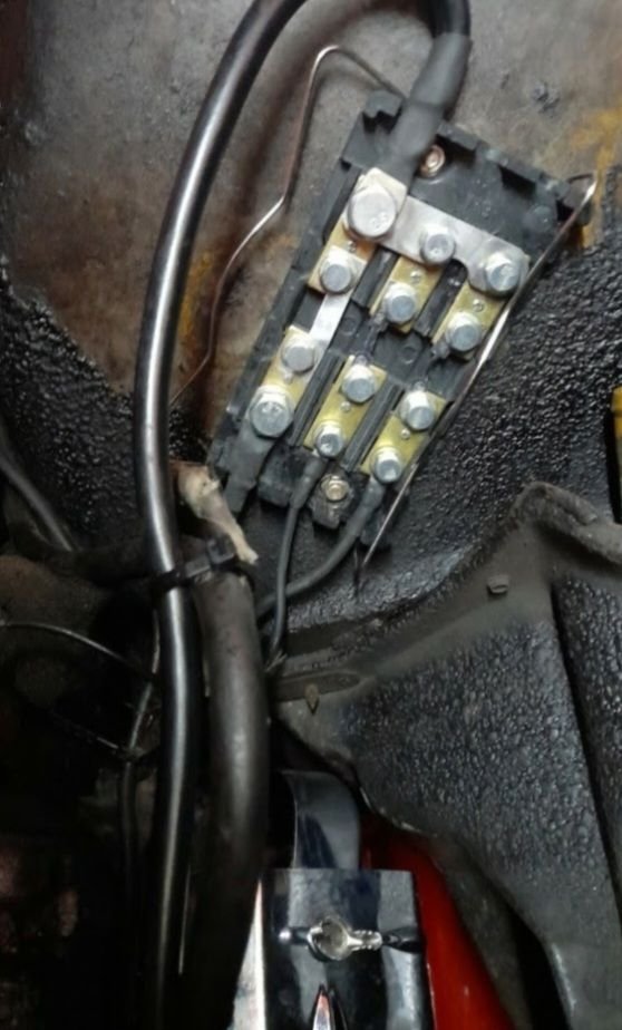

I ran a Harley Davidson sized battery cable from the solenoid (positive battery cable) to a strip fuse panel mounted on the forward side of the passengers footwell.
Like this. Yes there is a cover for the box. Off of this I run headlight power, electric fans and a 100 amp strip fuse for my upgraded alternator also needed for electric fans and my EFI. EFI power has a separate fuse in the battery box. As that needs clean power and ground.
