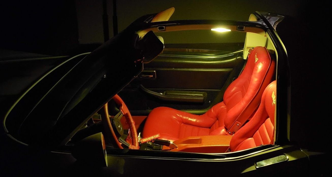

Excuse me while I quote myself. You may find these threads useful.
https://www.corvetteforum.com/forums...-led-info.html
https://www.corvetteforum.com/forums...s-learned.html
Here's what I bought, but it is discontinued.
https://www.superbrightleds.com/578-...44mm-60-lumens
Originally Posted by Bikespace
Where are they going? And what year car?
My 80's dome light takes one of those Festoon bulbs. Use Warm LEDs to preserve the old-timey glow.

This might be the replacement for the festoon bulb I posted.
https://www.superbrightleds.com/cata...lor-Warm~3100K
The key to more light quantity is lumens. The old incandescent bulbs in your car will deposit soot on the inside of the bulbs, and dim them over time. LEDs don't do that, of course.
As for quality, if you choose a warm color temperature (3,000 K or so), you will get the old-timey glow that you expect.
Please post photos when you get it done!

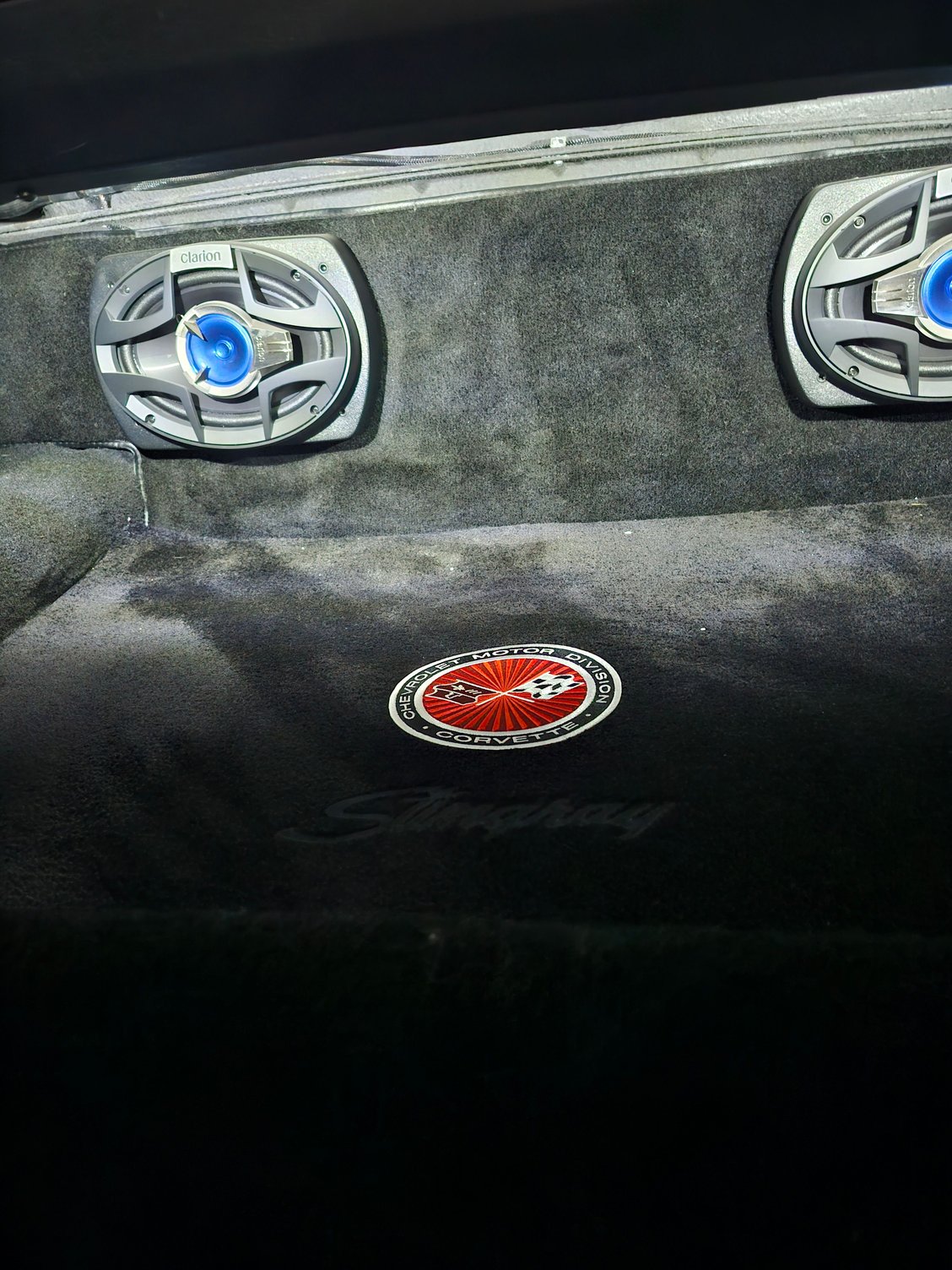

One thing you are going to notice with a brighter light in the rear compartment is you are going to need sunglasses to see anything. What I did to mine is go to the wreckers and find a pair of rectangular curtisy lights and pit them inside the the lower rear window trim.
If I had to do it again I would us a led strip with side emitting diods inside the trim, a much easier installation. I used the for my 3rd brake light. A 20" strip inside the plastic trim around the rear window.
Dale
