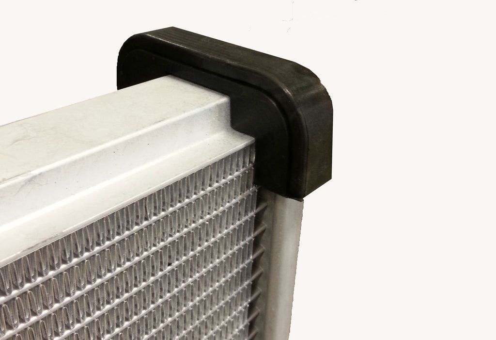

There's a budget DeWitt's radiator sold via Zip. I bought one, and I'll probably use it. It is not a direct fit, though, and will require modifications to the cushions, since it does not have the stock ridges, or the stepped rail (which is used by some electric fan conversions). It also has the useless automatic transmission cooling loop. I think you can get it bare aluminum, or painted "black ice".
I'd consider a 4-row Champion if I were ordering online. I can drive to Zip, and the DeWitt's are Made in USA, so I'll make it work.
They offer custom cushions to correct for the aluminum welded core
CLICK HERE
