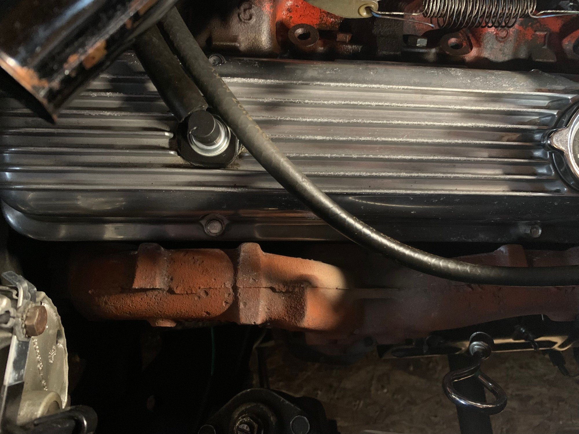

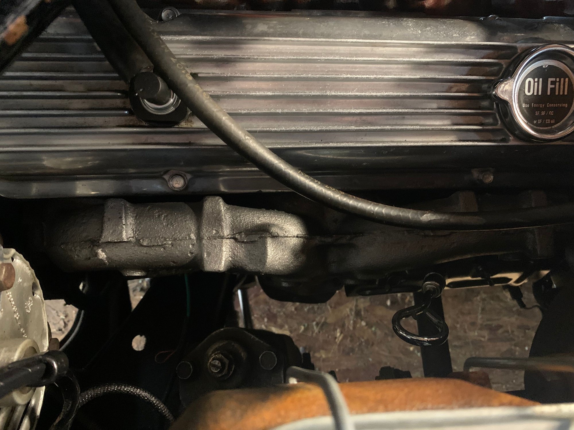

kansas
Here is what it looks like on old oem manifolds. It took me about 10 minutes each side. Prep was just spray with some brake cleaner.
I like it. Probably has about 3 hours of drive time on them and still looks like I just applied. I used a toothbrush and cue tips.
VS

Old Jul 28, 2024 | 06:51 PM
kansas123's Avatar
kansas123
Joined: Sep 2006
Posts: 2,815
Likes: 470
From: Wichita Kansas
Originally Posted by VERYSOON
kansas
VS
good stuff
Man that looks fantastic, I'm sold!

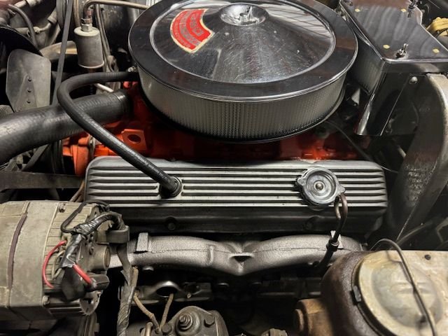

Old Jul 29, 2024 | 12:46 AM
Newbomb2469's Avatar
Newbomb2469
Joined: Nov 2023
Posts: 3,868
Likes: 837
Before and after
