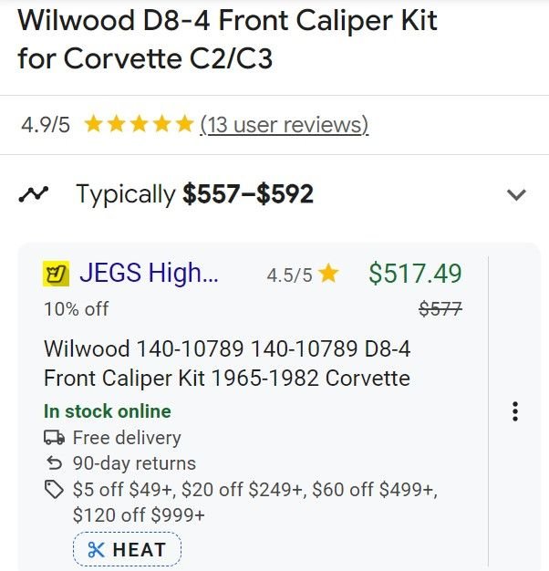

Jegs has some fairly good prices for the non-powdered coated calipers with hoses..... fore and aft links below. Also there is some coupon with the code HEAT on google search. But also look at van steel website to compare. I added the coupon code image HEAT below the links.
I don't think I paid much more than this (they were powdercoated and whatnot so that was a big advantage of the group sale....and I got my favorite RED{not that anybody can see them behind rallye wheels..but anyway) but I'd compare some amazon prices and some ebay prices now that you have the part numbers. Lotsa times there is free shipping on Amazon & Ebay...... I paid shipping when I bought mine.
Take I look. I took the trouble to search because I think they are so goddammed good.
https://www.jegs.com/i/Wilwood/950/140-10790/10002/-1
https://www.jegs.com/i/Wilwood/950/1...HcBF-yNQdmrMQk

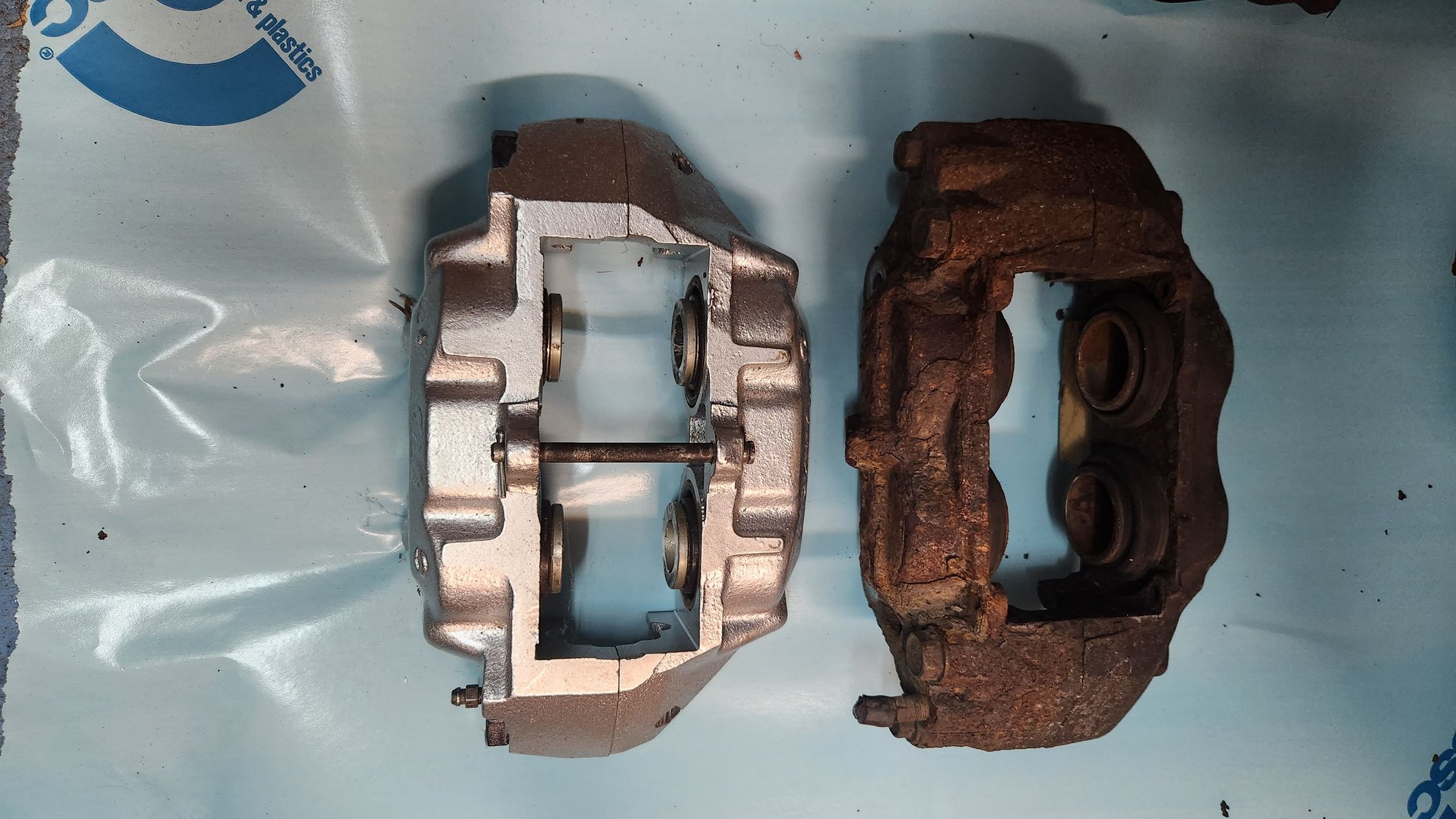

This is a total aside .....but the calipers that are on my Hummer H3 look remarkably similar to C3 calipers. The mounting is similar too (not exact). The picture below is a C3 caliper on the L, old H3 caliper on the Rt. I bet it wouldn't take much to plasma-cut out a new mounting plate out of 3/8" plate to adapt to the C3 knuckle (that's all the current calipers mount to anyway), and get them to work. I've often thought of trying a swap. I've put them onto my C3s rotor just to eyeball the fit, but that's as far as I've taken it. It would be a modern caliper. Drop-in pads. H3's even have spring pad-spreaders (to push pads away from the rotor). No weight savings though and I haven't looked into how the current C3 M/C would work. And it doesnt address C3 rear calipers. Just a thought.
IDK if there'd be enough clearance with OEM wheels. H3's run 16" wheels, so if yer running 16" or larger wheels I suspect they'd probably clear ok. Or maybe a little grinder work would allow them to fit OEM wheels?? Again, something I've just always 'wondered'...
