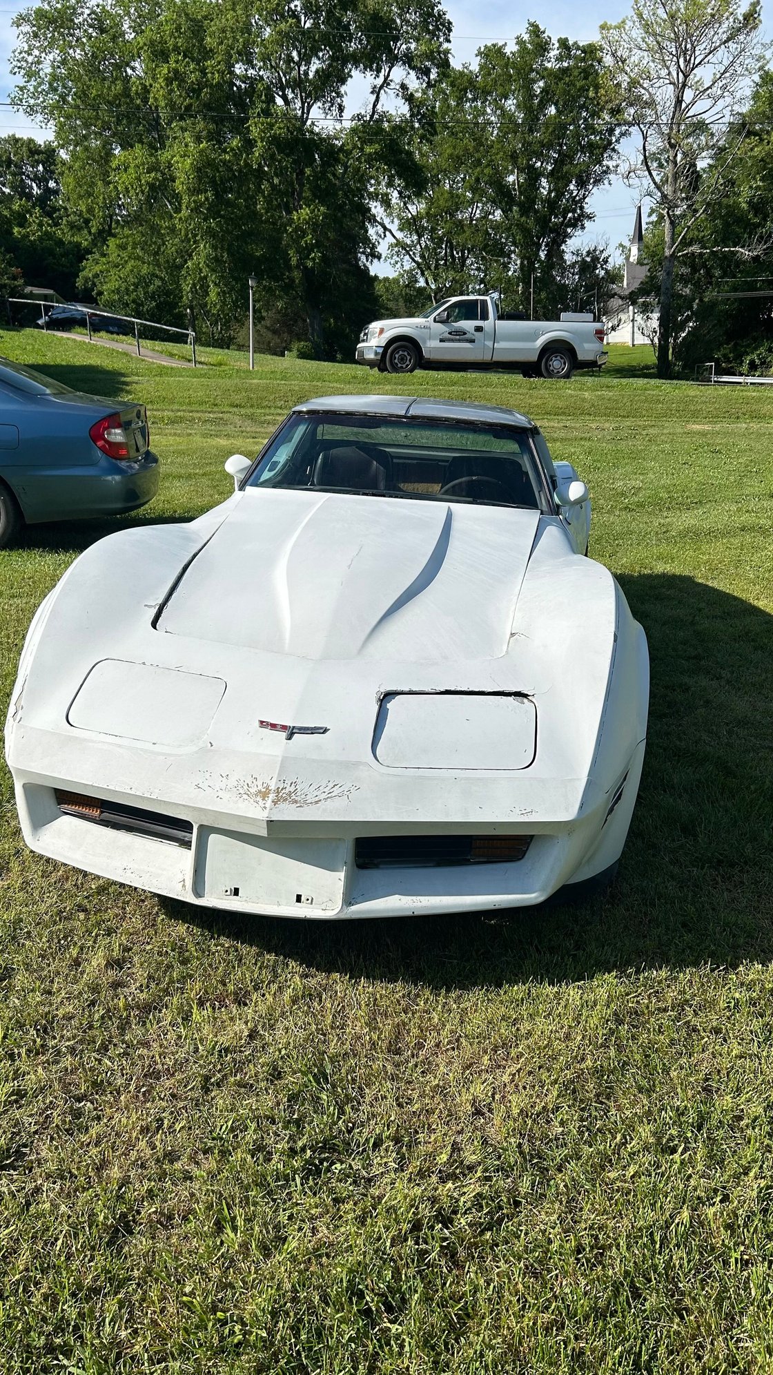

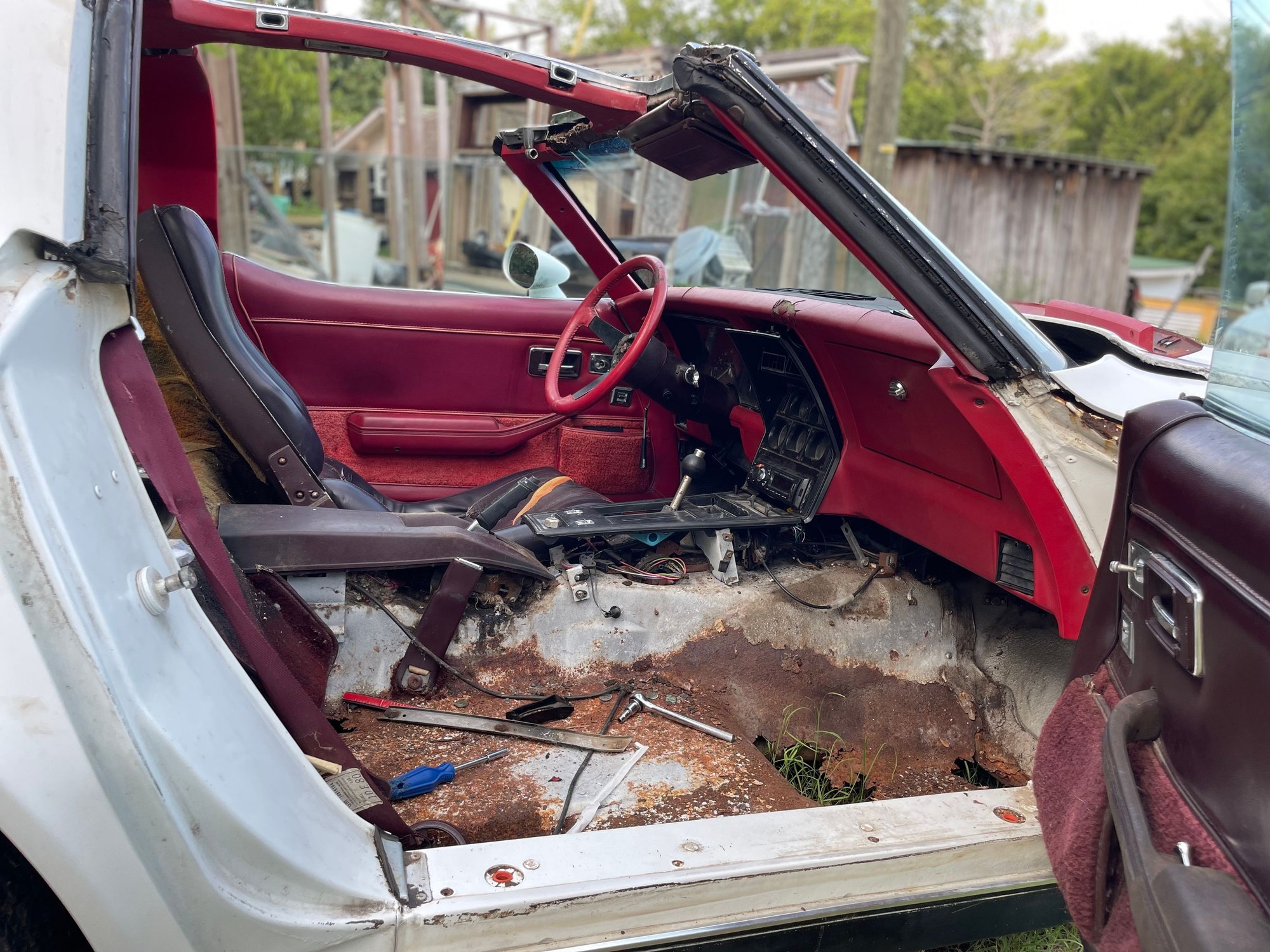

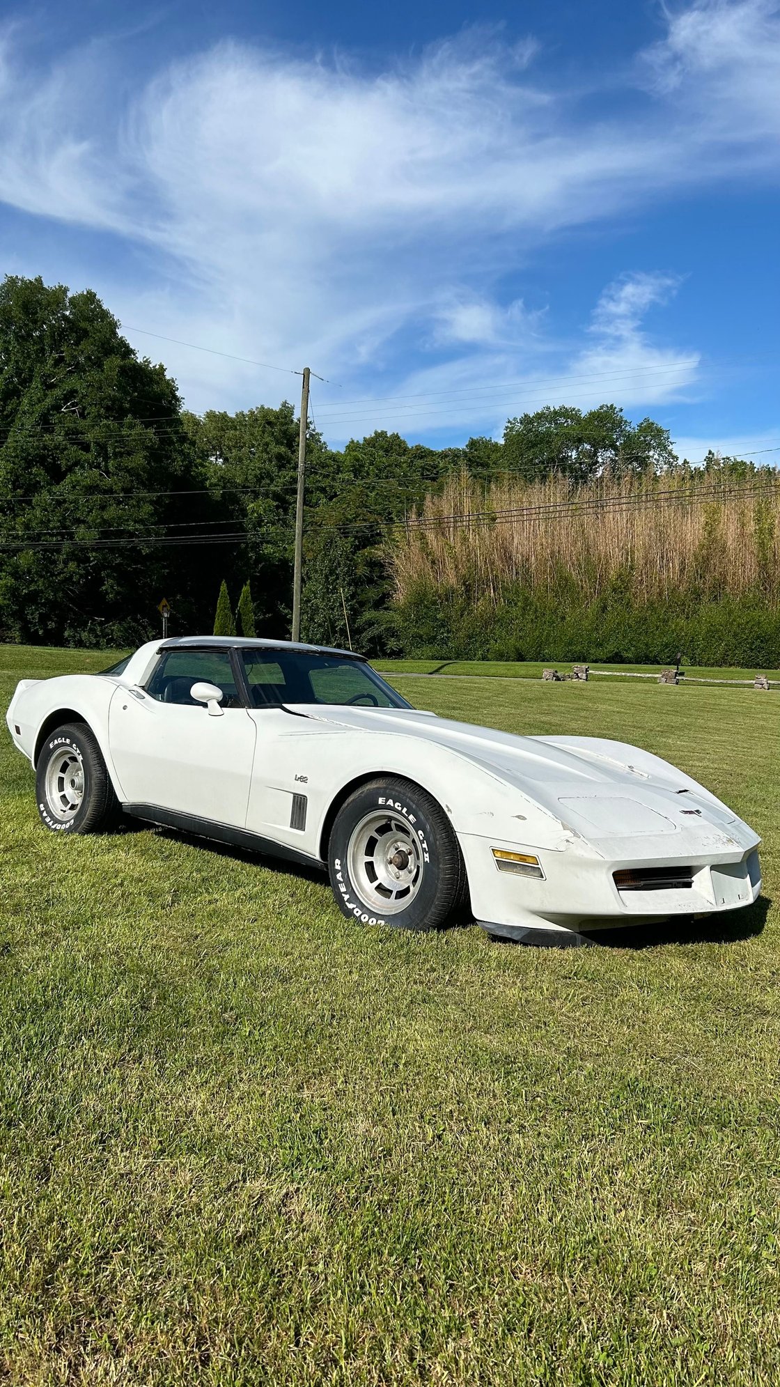

i’ve just traded for a 1980 L82 auto corvette, and after getting what work i can get done on it i’m narrowing down to the last few things and need a bit of help from anyone… i did a bad thing, and got the worst rust bucket thing i could find the body is in pretty good shape other than a few scrapes and small cracks. my frame is totally rusted out almost half of the frame is gone on one side… but.. i bought a 1980 manual corvette with a great frame on it i’d like to put my automatic body on the manual frame and put my automatic trans into the manual frame will i have any issues putting an automatic body on a manual frame with an automatic motor in it? i have an auto crossmembers i can swap out if i would need to

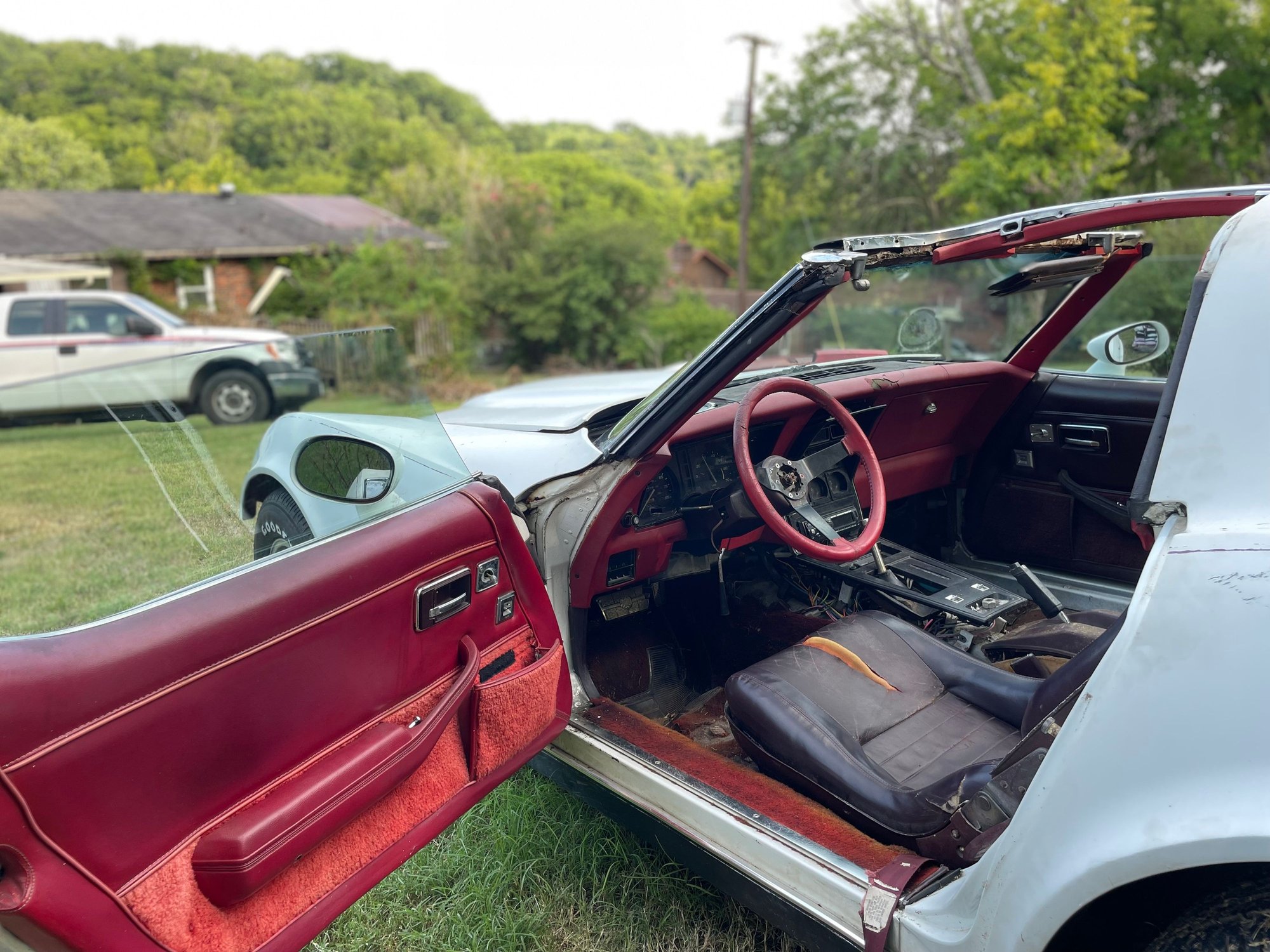

here’s a little view of the car i dont have any pics of the rust sadly but will be getting great ones here soon when the body is pulled off

I hate discouraging anyone, and truly, anything can be saved with enough work and money. I can't see any of the frame in your pics, but if that is the "good" automatic body, yikes!
That birdcage and floor needs some serious work from what I can see. It's your car, but I would consider parting this one out and finding something better.

Before you go too far with your plans, pull off all the inside trim around the windshield and post pics. Pull off the kick panels also.

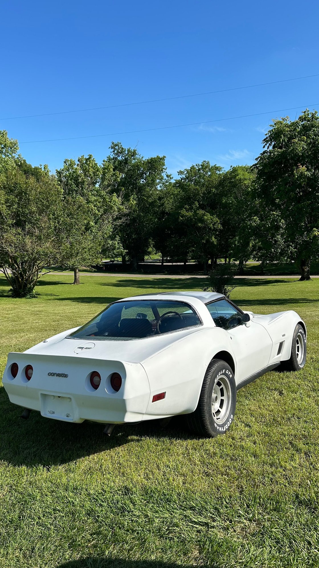

What does the 4-speed car look like?
While I don't want to discourage you from fixing your white on red 80 (the best color combination), the 4-speed is much more rare. Is it driveable and restorable? Only 13% of 80s came that way from the factory. In an apples to apples comparison, I've found that a C3 4-speed is about a million times more fun to drive than an automatic.
It's also possible to cut your losses, sell these two, and find one car that meets your needs. One rust-free, running car is worth more than two cut-up rusty project piles.
