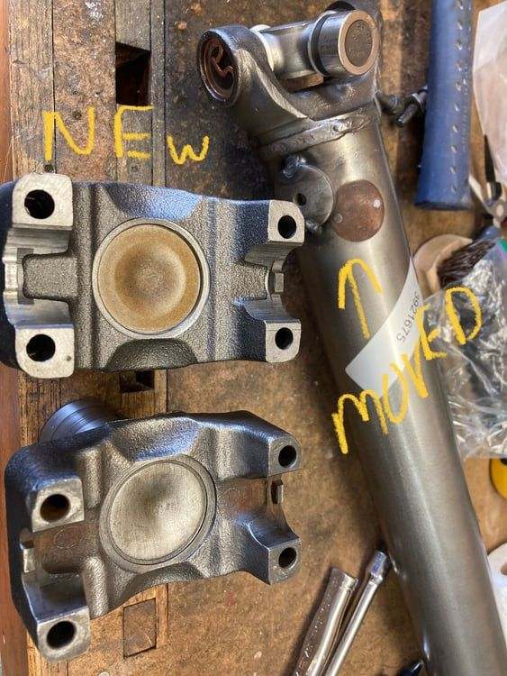

I agree on rebalancing.
mne had bad yoke out of balance, so its not just driveshaft..
