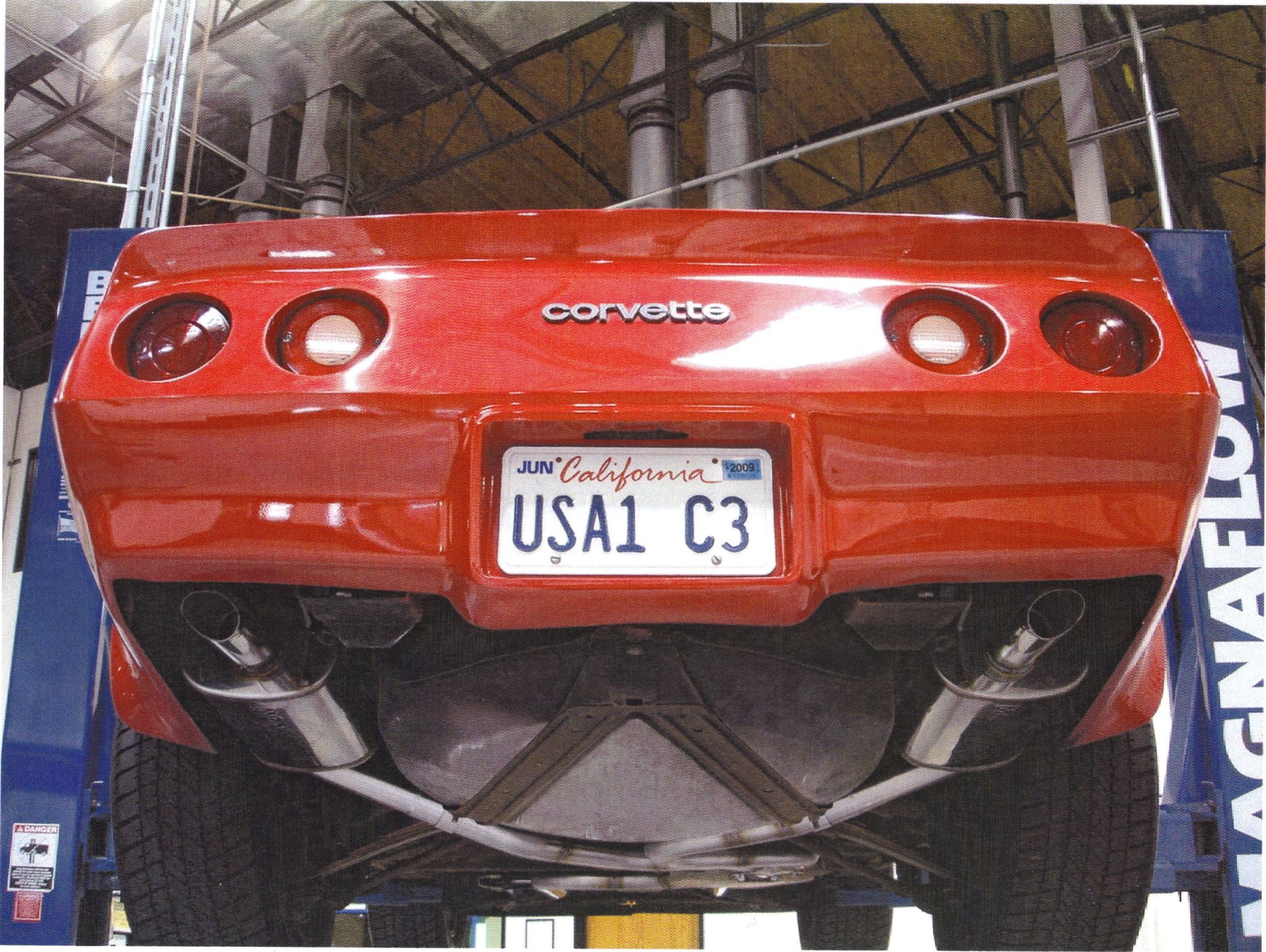

Back in 2008 Magnaflow used my 1980 Corvette as a template to make this system.
It has a very nice sound and you can have a conversation while driving at 70 miles an hour without any droning.

I kinda like this OEM look better versus having the muffler poke out of the rear. I recently had my muffler done on Monday and i have yet to post any pics (which i will soon). I noticed a huge difference vs the oem stock muffler when i take off. My car can breath!
I guess the picture makes it look like that but they do not stick out from underneath the car. The mufflers are actually recessed and from looking at the back of the car you could just see the exhaust tips.

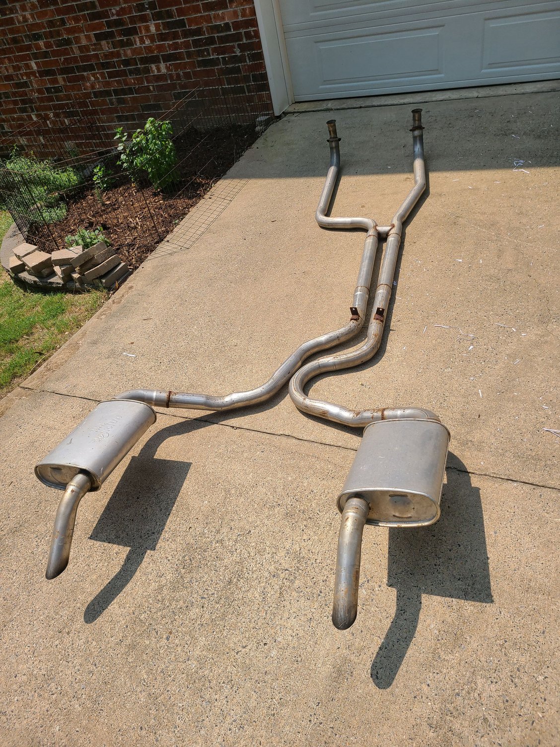

'80 original stock exhaust on left. True duals on right.
Old Aug 26, 2024 | 09:39 AM
Mark G's Avatar
Mark G
Joined: Jul 2005
Posts: 3,691
Likes: 833
From: WI
What system is that? Looks pretty good (for non-inspection areas). Is there a crossover in the line somewhere? Thx.

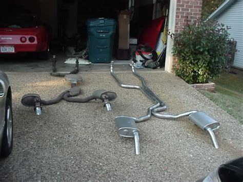

Here it is with my home made H-pipe crossover added. It was sold by Mid America years ago. Great system you could drop out of the car in one piece easy for service. Sold it to another forum member a while back as I went to side pipes. He threw the whole thing into the back of his pickup and drove home.
