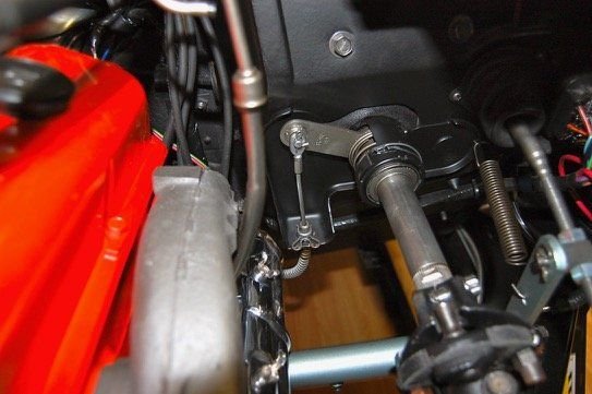

Put it in reverse and take a photo of the lockout lever. Sometimes the cable binds up at the transmission...happened to me.
can you please circle, in the picture above, which is the cable, in order to do the right picture? I will post it asap

The key only comes out with the transmission in Reverse.
If it still does not come out when in reverse pull up on the arm that has the cable attached to it. Just open the hood to access it.
you are a genius. It worked. Thank you my friend
