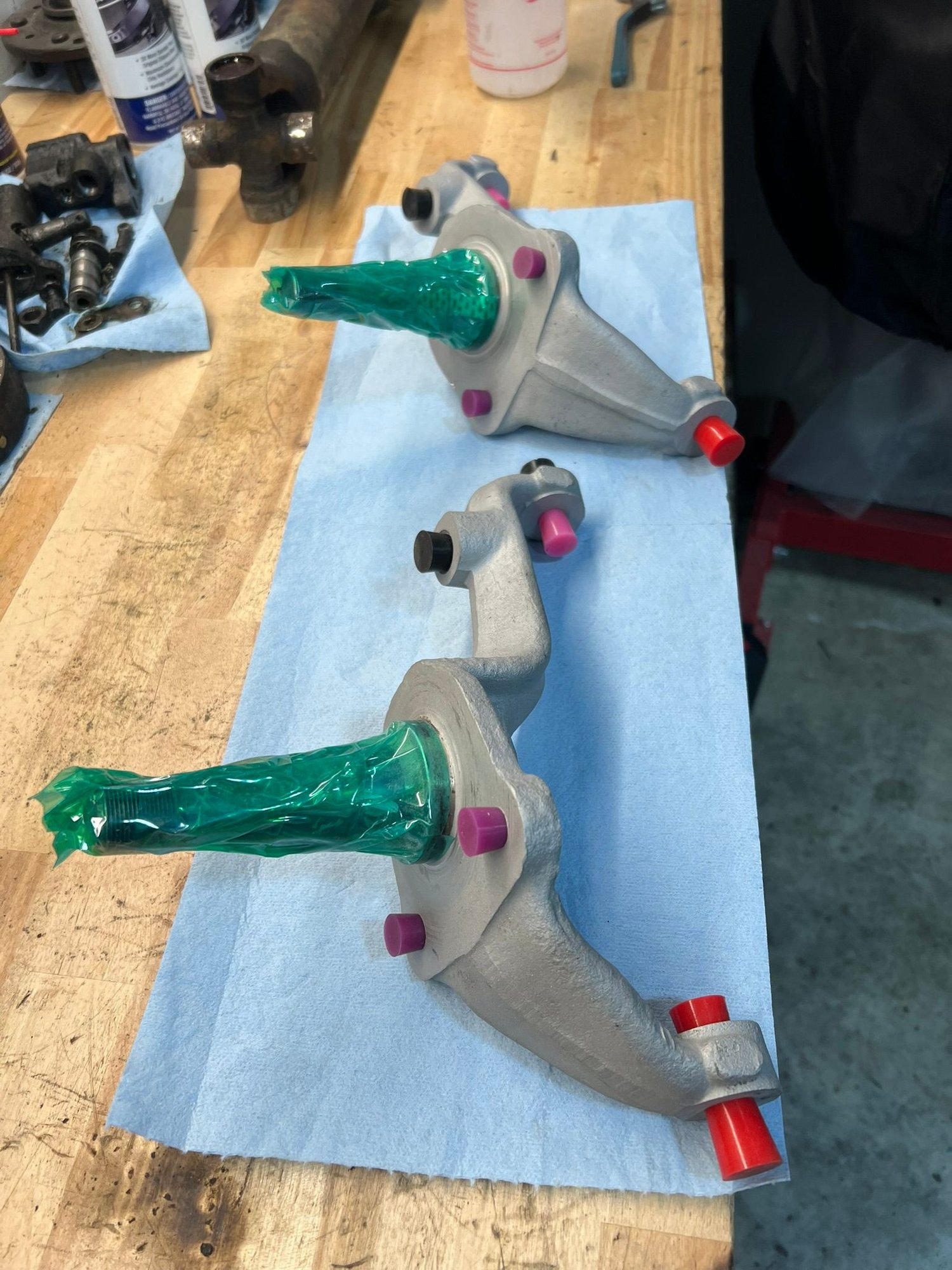

Making progress working off the backlog of parts that need to be blasted and powder coated. I got some 3" fiberglass tape and a silicone plug kit, so I knocked out some of the more complicated parts:

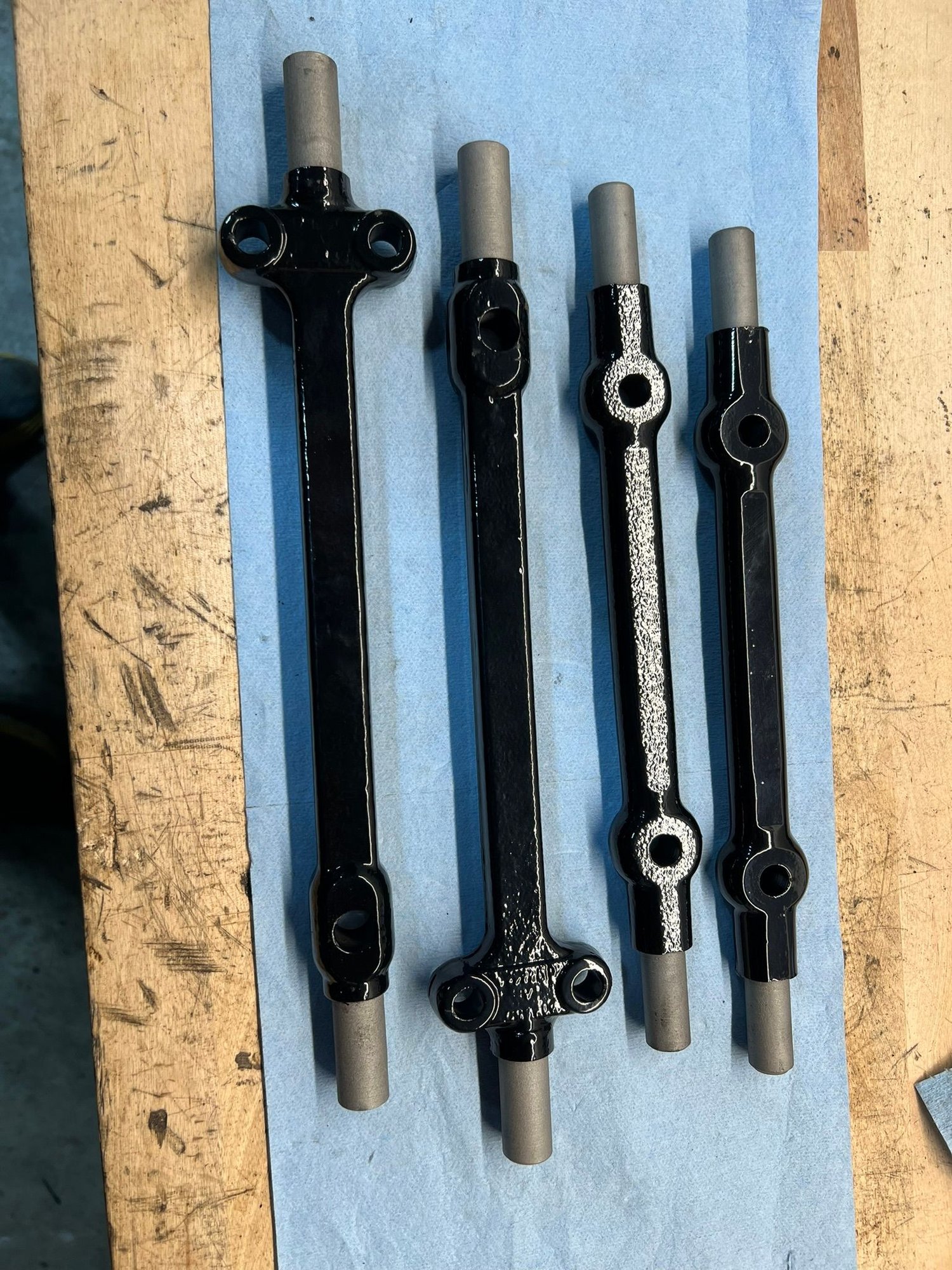

I wrapped the end of these and PC'd the rest.
I wrapped the tape around the spindles and used plugs for all the holes:
I think they came out pretty great.

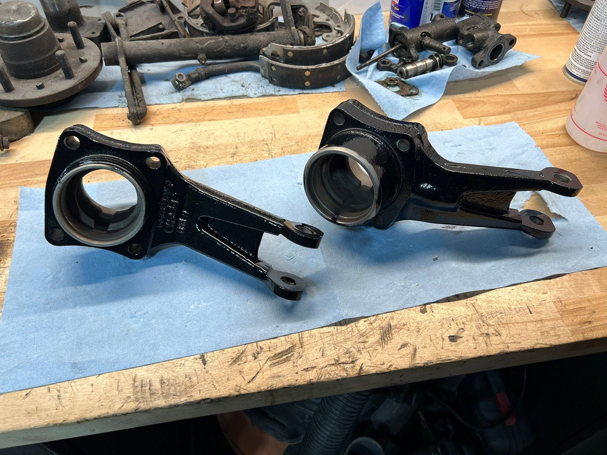

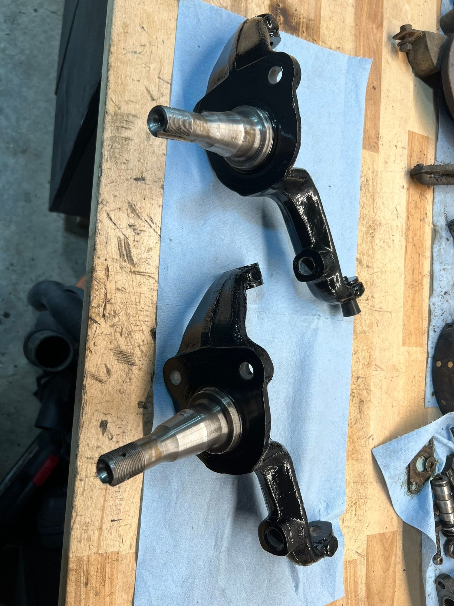

Blasted and wiped clean
Tape over the openings and plugs in the holes
All done, though my taping wasn't perfect so they'll need some cleanup

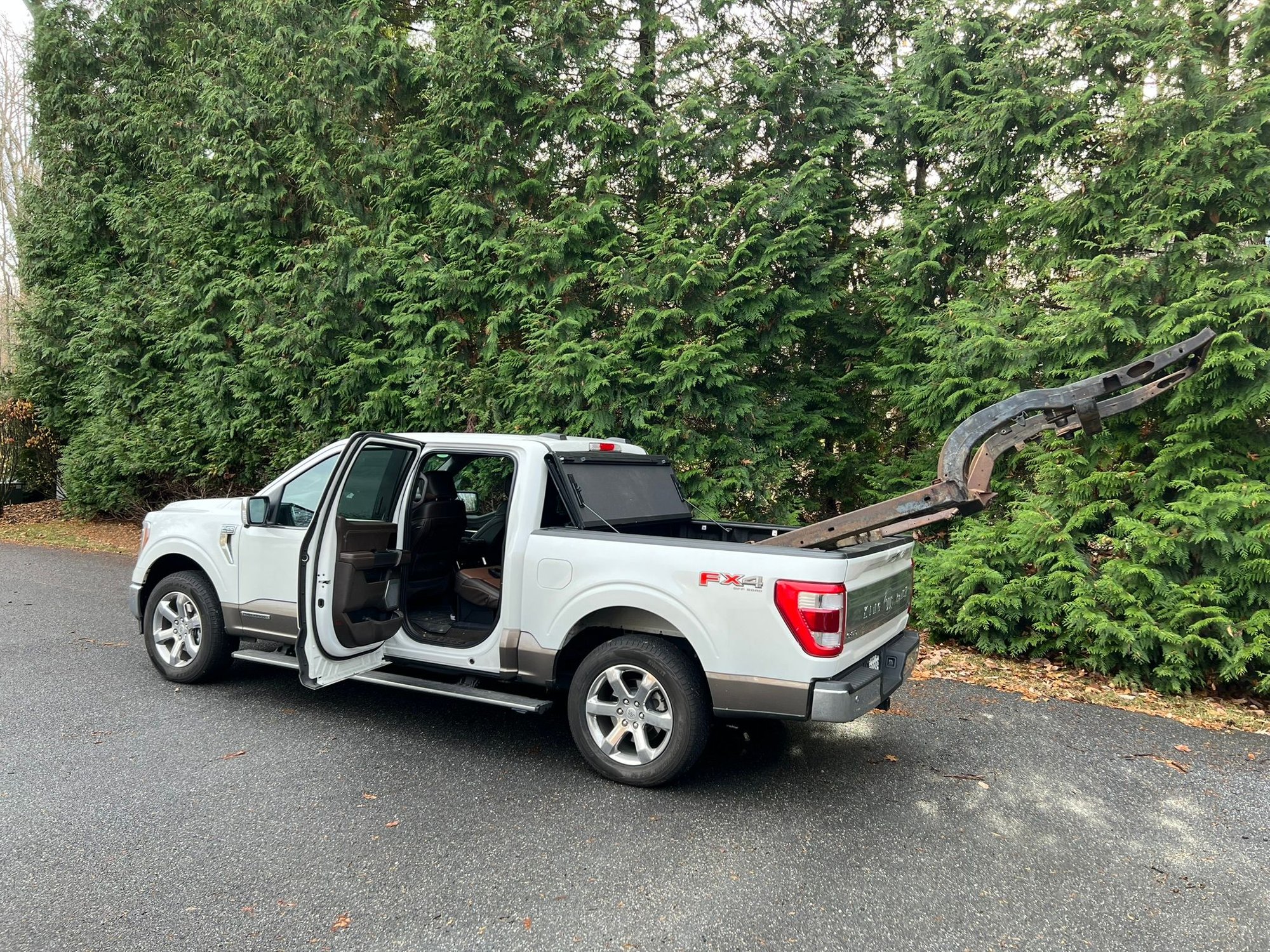

Thanks, I decided to complete the stitch welding along the frame and to add the gussets.
Speaking of, THIS looks like a good idea...
No frames were harmed during the filming of this dropoff...
To 1972 Convertible Resto Mod

Forgot to add a single ratchet strap

THAT would be even scarier!! You can't see any of them, b/c all the straps are at the other end, holding the frame down and tight to the bed in the front, and holding it laterally in the middle of the bed just in front of the tailgate.
