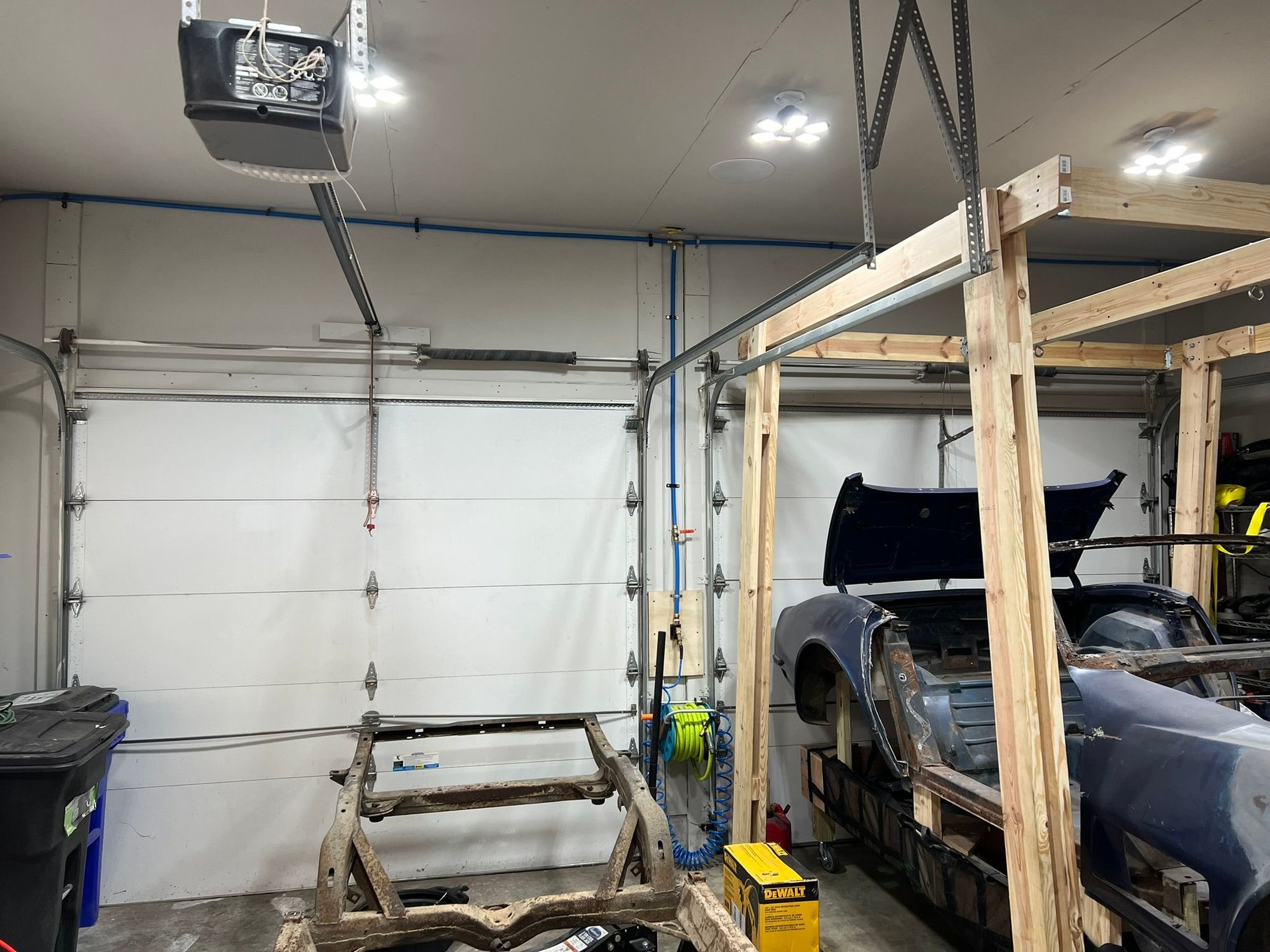

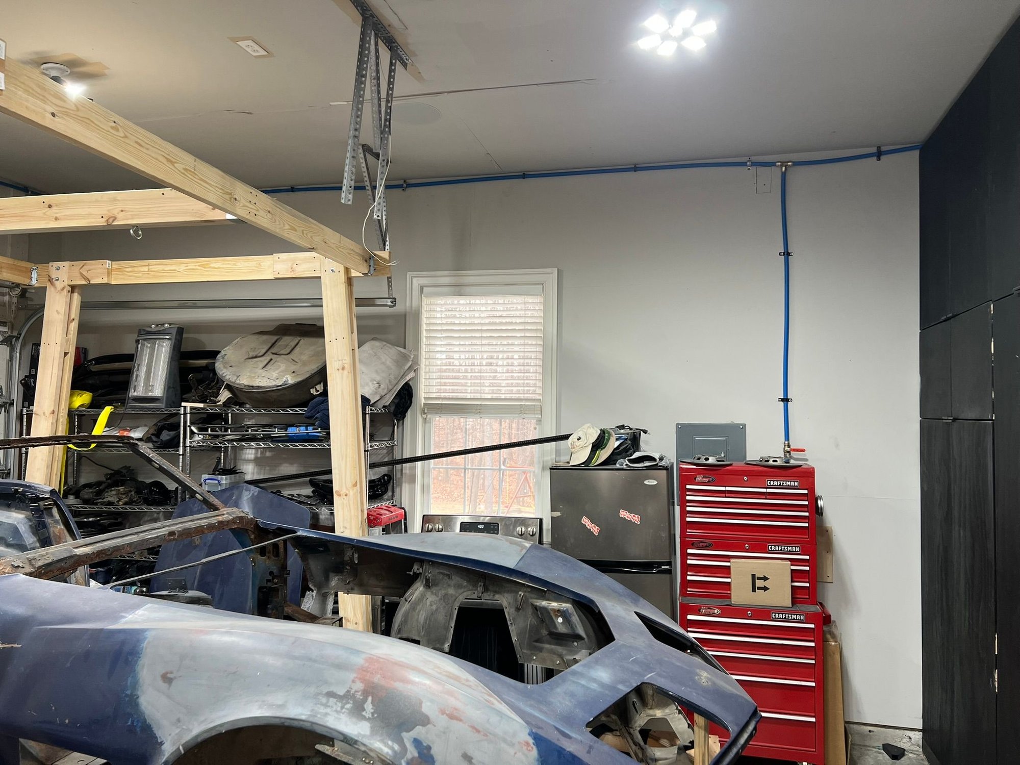

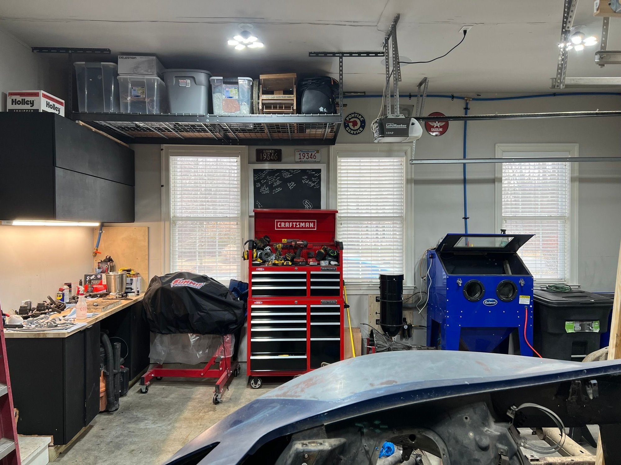

Ok, I didn't disappear, I just finally had a chance to get the garage back together. As promised, here's my air setup...
First, I have the compressor in a cabinet. I built the custom cabinets and setup along the back wall of the garage, and specifically included a spot for the compressor in the cabinet. The intention was to keep it neat and to reduce noise. Anyone that has one can tell you this doesn't work when it's cranking, b/c it gets warm and needs to vent. That means I have to leave the door open to have air flow, so it's just as loud anyway. It does look a lot better with the door closed, and it helps to keep the garage clean. Here's it in its cabinet on the back wall:
It runs up from the interior of the cabinet and around the top of the wall across the 3 walls of the garage. Moving to the left, I have one drop behind the toolbox on this wall. I don't use it much, but it was in case the blast cabinet ends up moving to this wall. It's also just easier to add drops during installation than try to go back later, as I found out this past week.
The next wall to the left again is the garage entrance. I added another drop here to be able to use air in the driveway. This is where I'm planning to add the hose reel this weekend, since the retracting air hose is more of a PITA than a help.
The last wall is where the blast cabinet is. The run used to end in a 90 degree drop to the cabinet here, but I just replaced it with a T this week. I was constantly dragging a line over to the workbench to the left, so I decided to extend and add another drop. I have the pex run over there and a shutoff in front of some plywood I just attached. The plan is to add another regulator / condenser on that plywood and have a 1/4 nipple there for using air tools on the bench.
Now that the garage is back together it's time to do some more blasting and powdercoating! I'm almost where I want to be right now, just a few more pieces to do. I also ordered the replacement windshield frame components. I don't know if I'll get to that before Christmas (2 of the kids' birthdays are also in December), but I'm hoping to get it fixed before the end of January.
We should have a couple of nice days (> 50) in the next week. If/when that happens the plan is to drag the frame outside to pressure wash it. That'll allow me to inspect it, see if any repairs need to be made, and tighten up some of the stitch welds. If I can get that done the frame will head to the powder coaters this month.

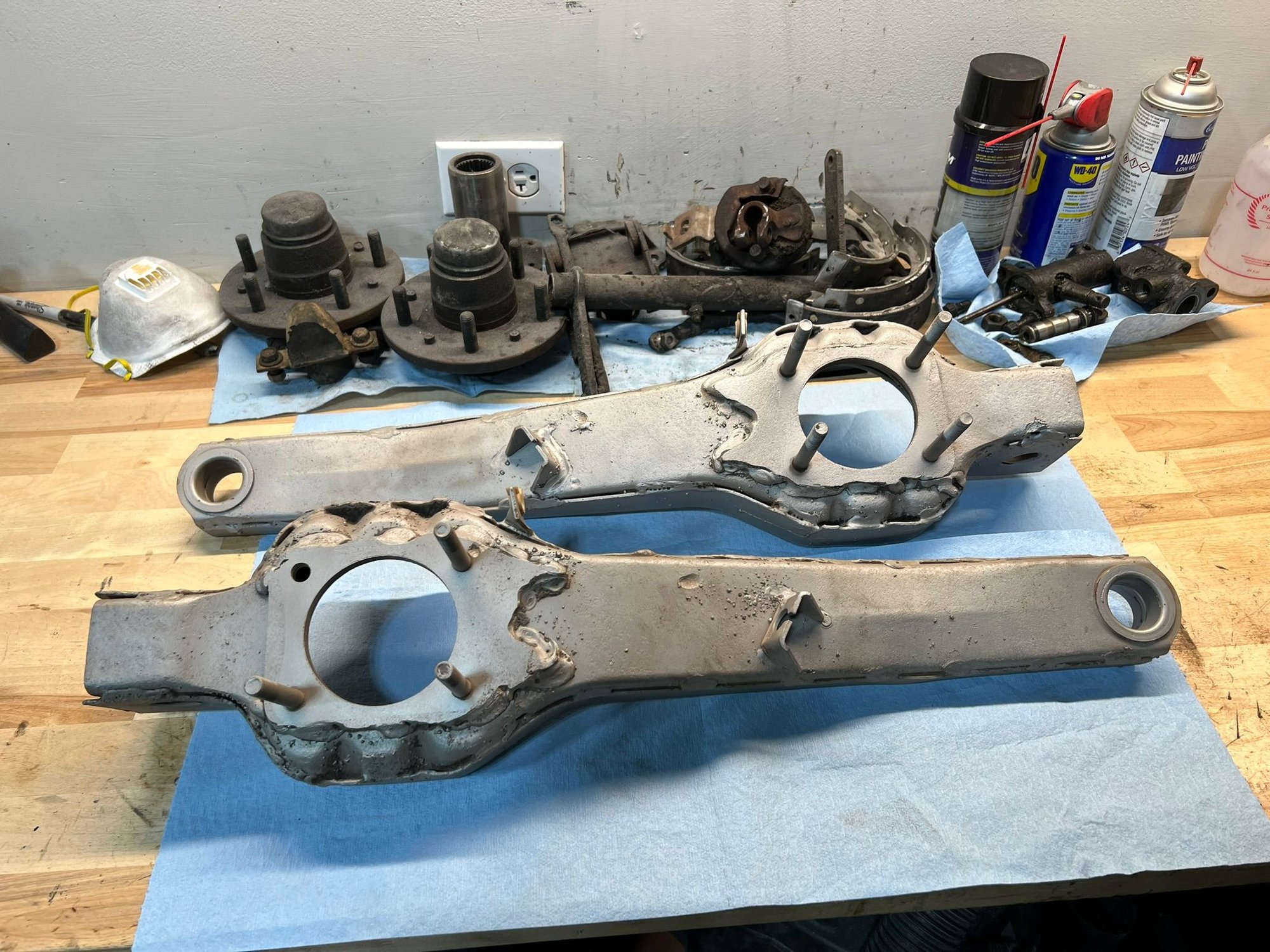

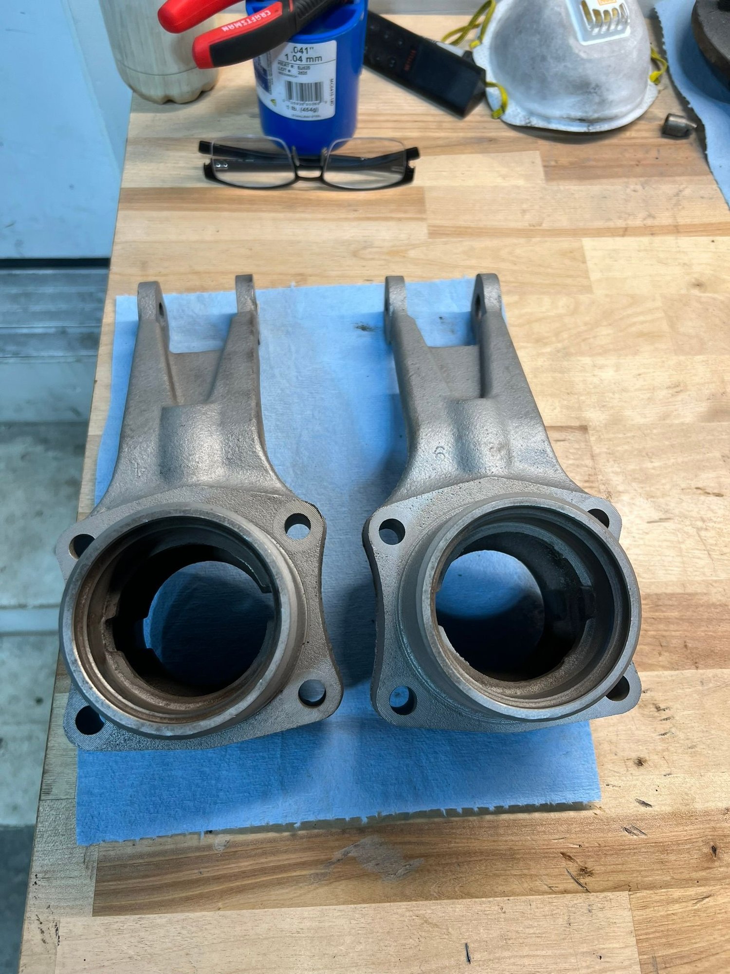

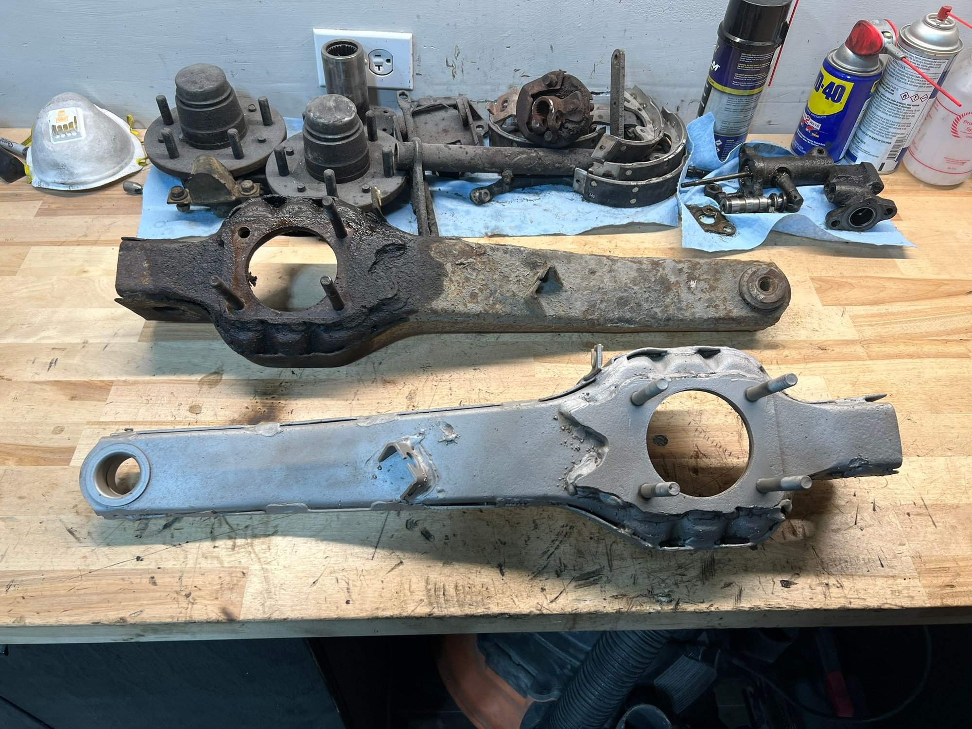

Thanks! Getting it fixed motivated me to continue the fight to disassemble the trailing arms. They were pretty trashed looking but I think they'll look ok once they're cleaned and coated.
Both lower shock mounts were STUCK, even after soaking them daily for a week. I ended up just pulling out the 3lb mallet and banging on them til they released, then had to cut the ends off to push it the rest of the way through. They're the first victims that'll have to be replaced.
Removing the two halves of the trailing arm wasn't that bad, and the bearings came out.
Before and after:
Both blasted:
The trailing arms, you can see what they both looked like to start.
And after blasting the second.
These were a huge PITA, probably the most annoying thing I've blasted yet. So many nooks and crannies, and the stitch welding is terrible. There's weld splatter all over these things! They're so nasty that it makes me feel better about my own skills and what results I can get...

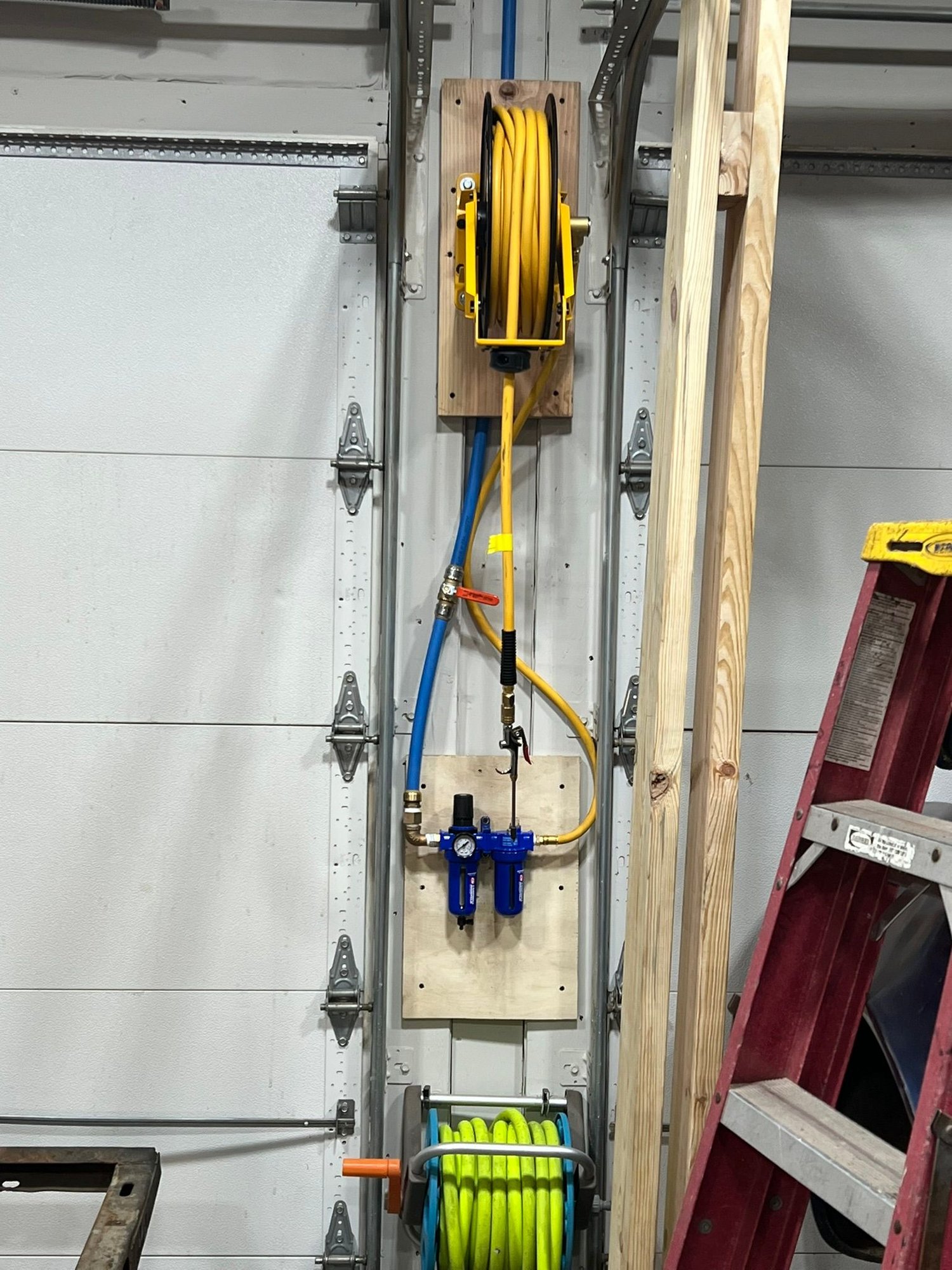

Thanks gents! I picked up the remaining parts that I needed, so the air system is done (for now).
Tool bench:
Garage door:

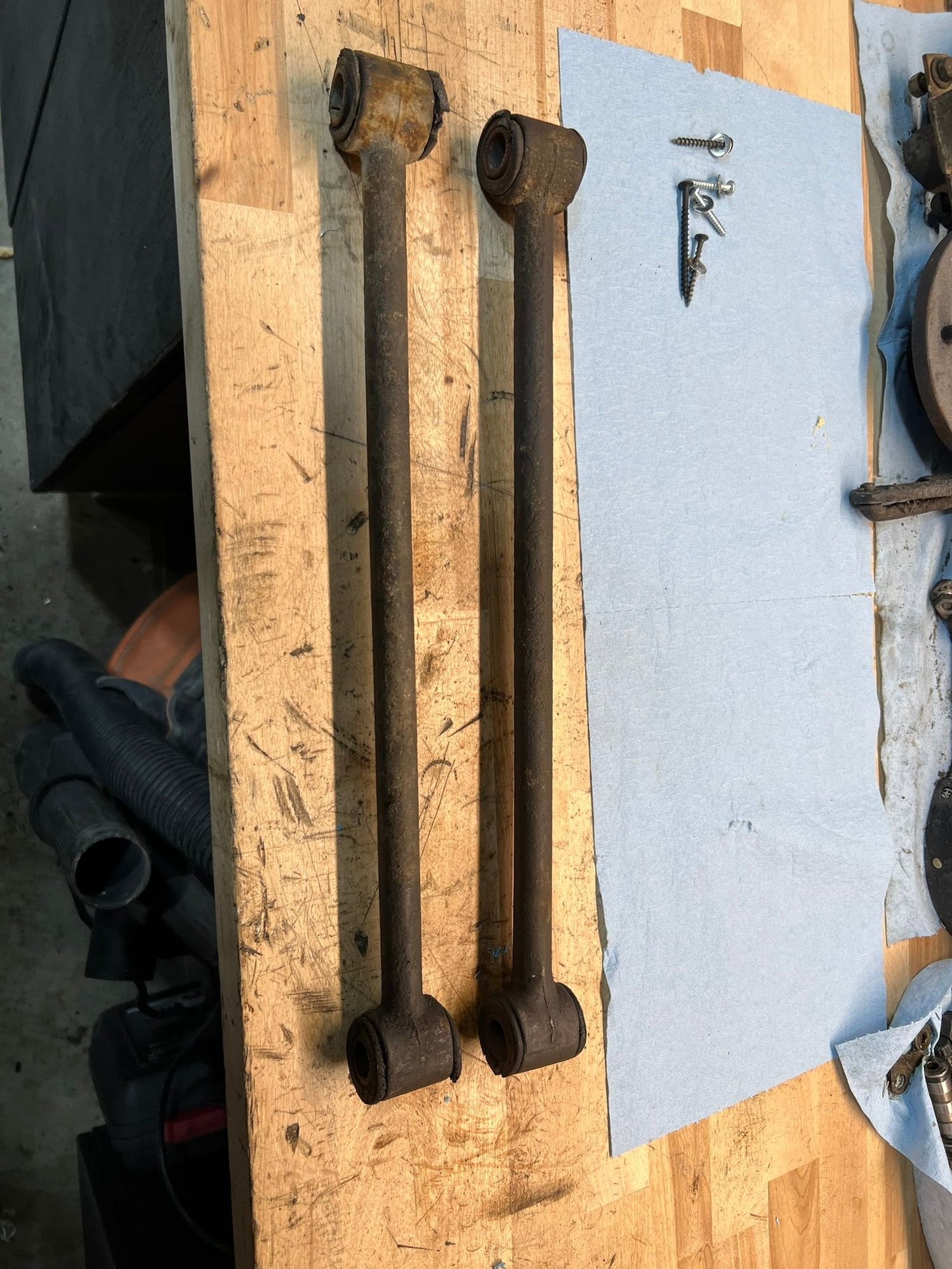

Got some work done on the strut rods. Before:
During:
After:

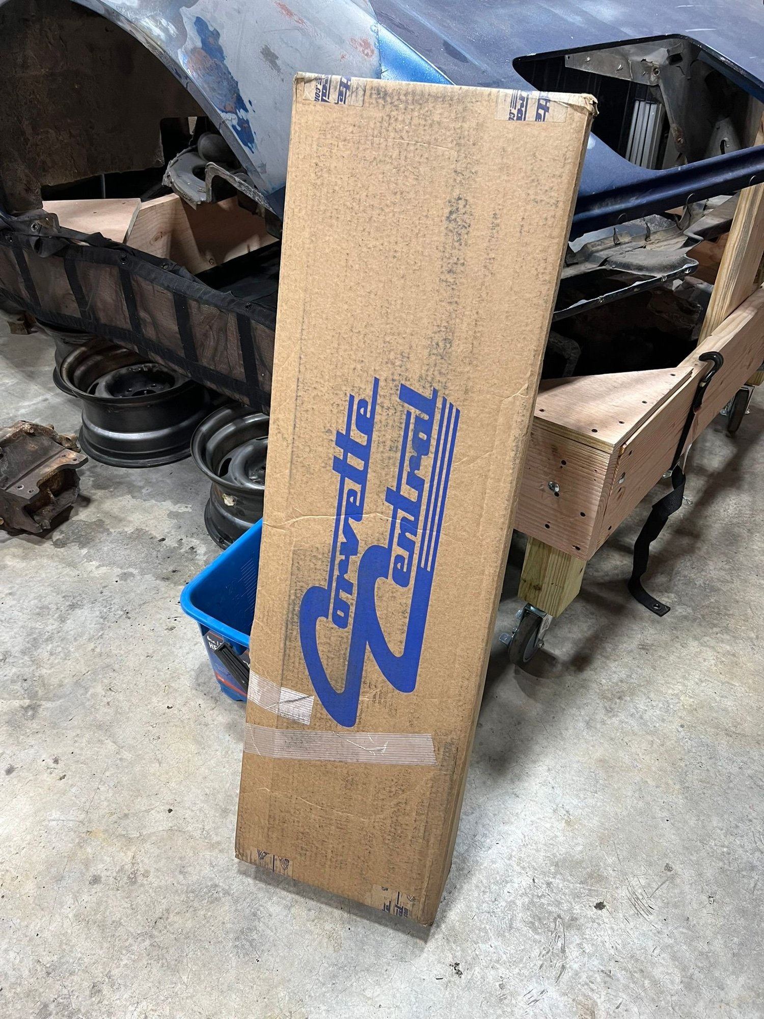

Also got a delivery for the next major project...
It's all the parts to remove and replace the rotten windshield. It's an upper center, both upper corners, both side posts, both outer lower corners.

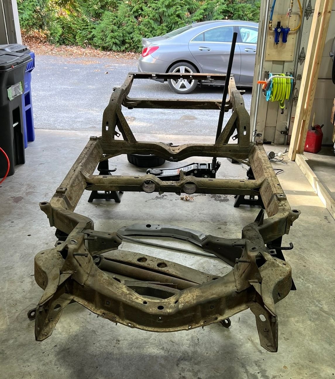

Surprise 57 degree day in December??? Time to bust out the pressure washer!
Before: Not bad, just covered in 50+ years of dirt and grease, so I can't really tell the condition of the frame. Plus, I've never seen the bottom...
I took it out to the driveway, and foamed the heck out of it!
I pressure washed it off, scraped some of the more gunked on spots (behind where the PS pump was), then flipped it over and repeated the process on the bottom.
Similar results on the bottom. Good news: no scary surprises waiting for me on the bottom of the frame. All looked pretty good.
Back inside the garage after air drying outside for 4ish hours. Definitely cleaner, definitely a bunch of flash rust.
No worries though, it'll probably go for blasting and powder coating before Christmas. I didn't see anything scary or unexpected, so all in all I'd say it was absolutely worth the hour it took to check things out. The last thing I did on each side (top and bottom) was to do a thorough wall through with a video to document everything. I may not need it later, but it didn't hurt to do.

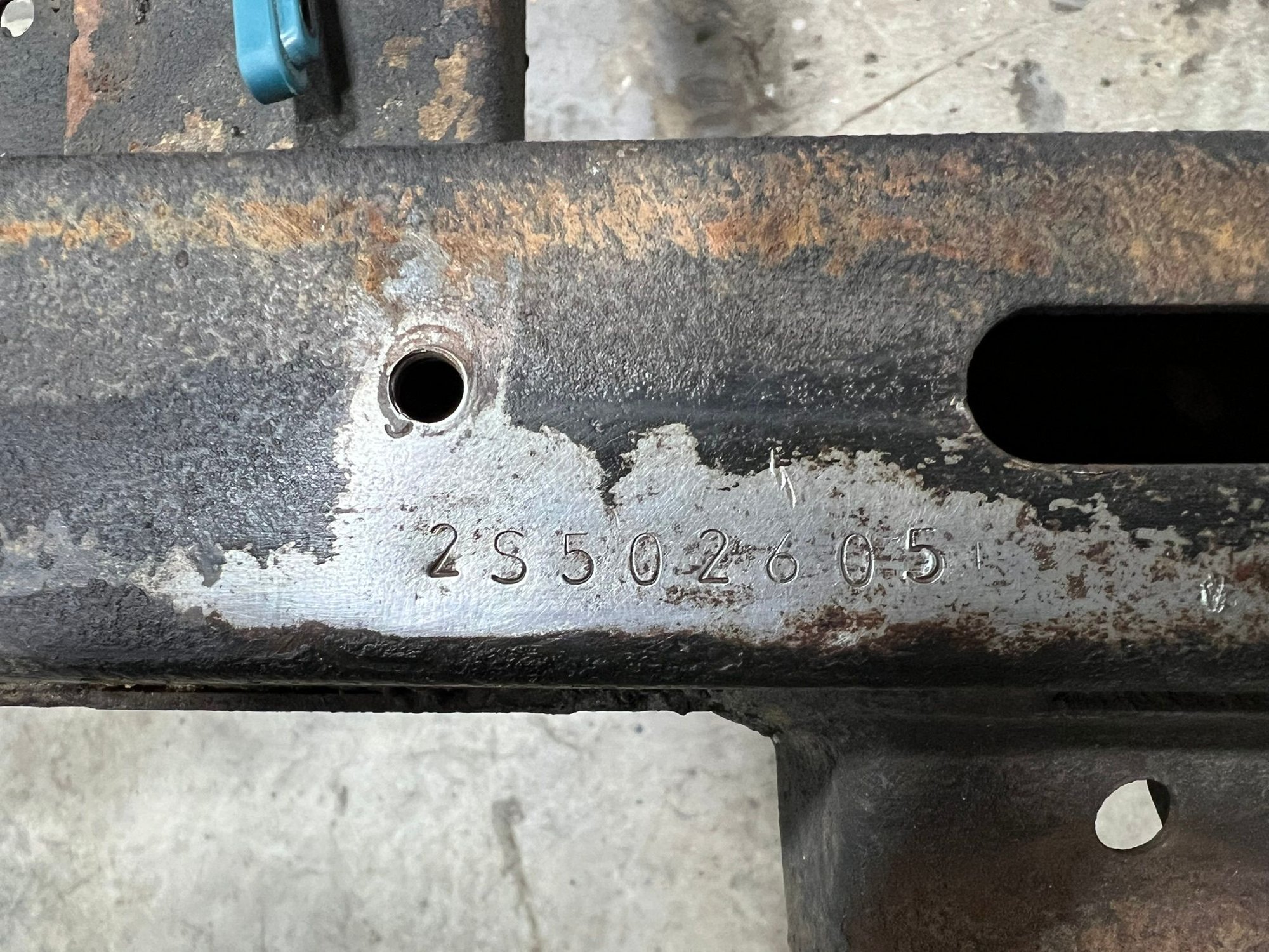

I believe there's a VIN somewhere on the frame rail. Good time to take a picture of it, I regret not doing that with mine.
The VIN stamp on my frame was on the top of the drivers side frame rail, just around the location of the rear wheel well.
It will be barely visible.

That's awesome advice, I wasn't tracking that. I found some writing that I need to photograph, but I didn't know the VIN was on it.
How big is it? Is it as small as on a VIN plate, or larger than that?? 1/8" tall letters? Larger?

Wow, your timing was psychic: I was *just* about to post that I'd found it!
I went over the whole frame, flashlight in hand, looking. I never found it, so I decided to just start randomly cleaning spots with a wire brush that other pics showed it. It really only took a couple of minutes to find the first digit, and 10 minutes with a small wire toothbrush to uncover it.
I'm a little nervous to try to clean it off any better, but it's the right number!

Yeah, it definitely does. Given the shape of the car, I'd have been *really* surprised if someone had done a frame swap on it!
Originally Posted by nwav8tor
I covered the VIN on my frame before coating it so it would still show afterwards. I did spray it with a few coats of clear after the whole frame was coated. I don't think having such a small area without the"heavy" coating will be detrimental...
That's a cool idea, I'll have to check it out.
The only thing better than finding the VIN was seeing how nice of shape the steel around it is.
