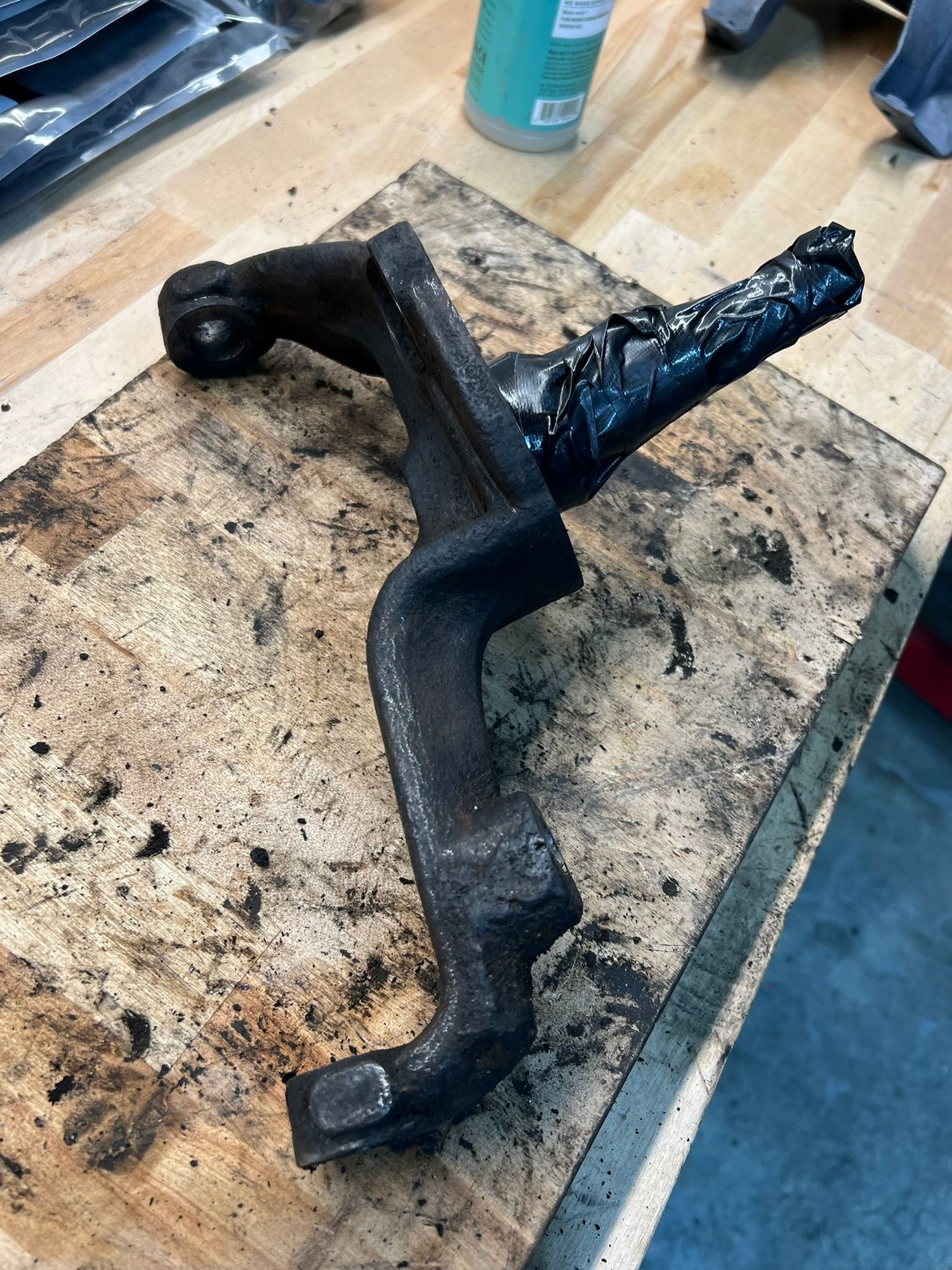

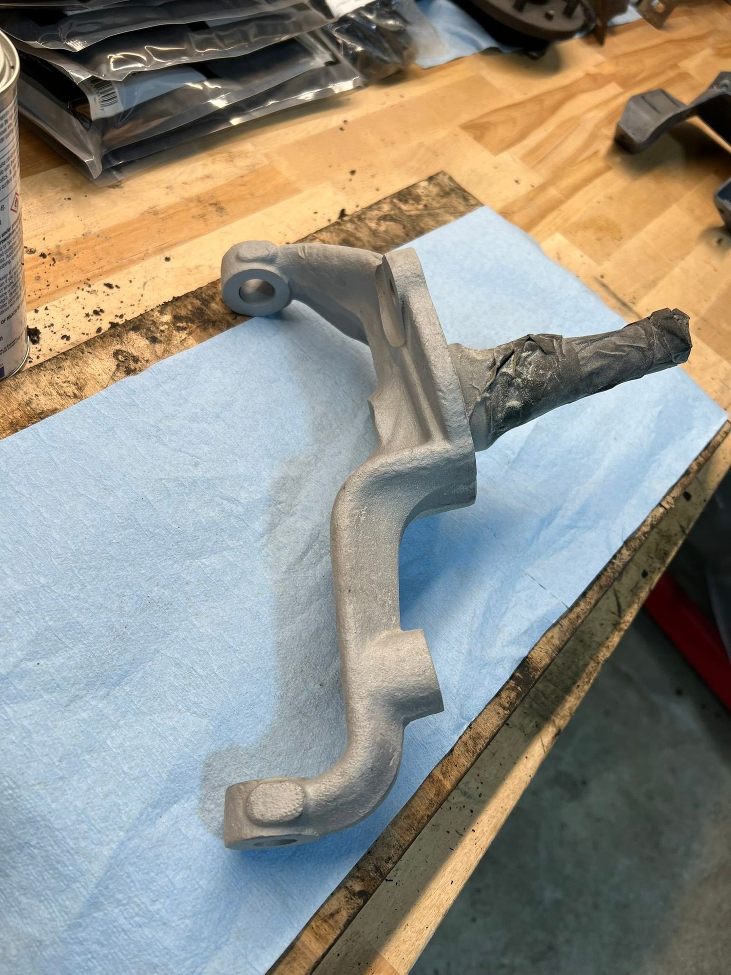

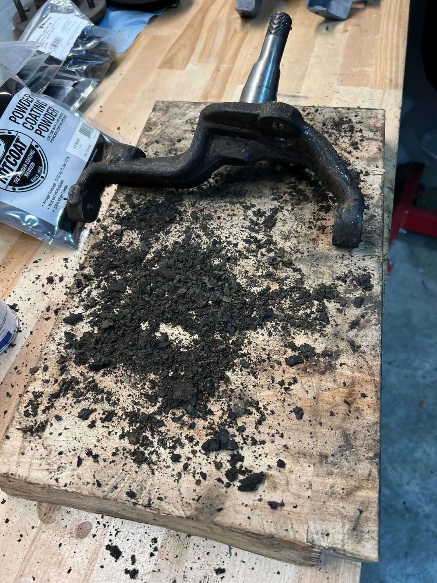

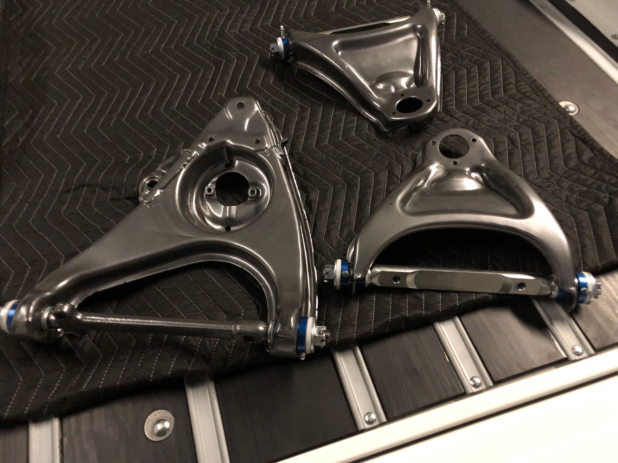

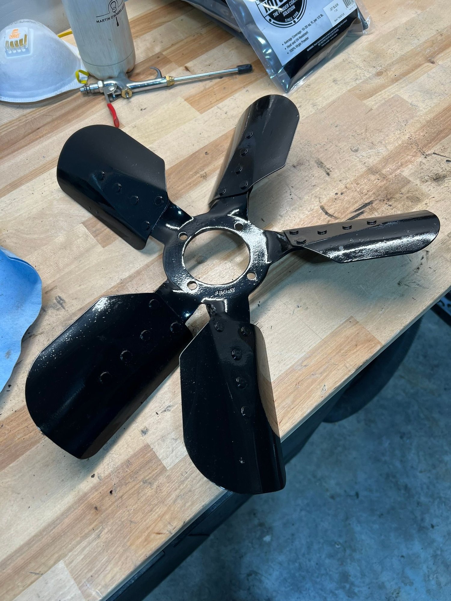

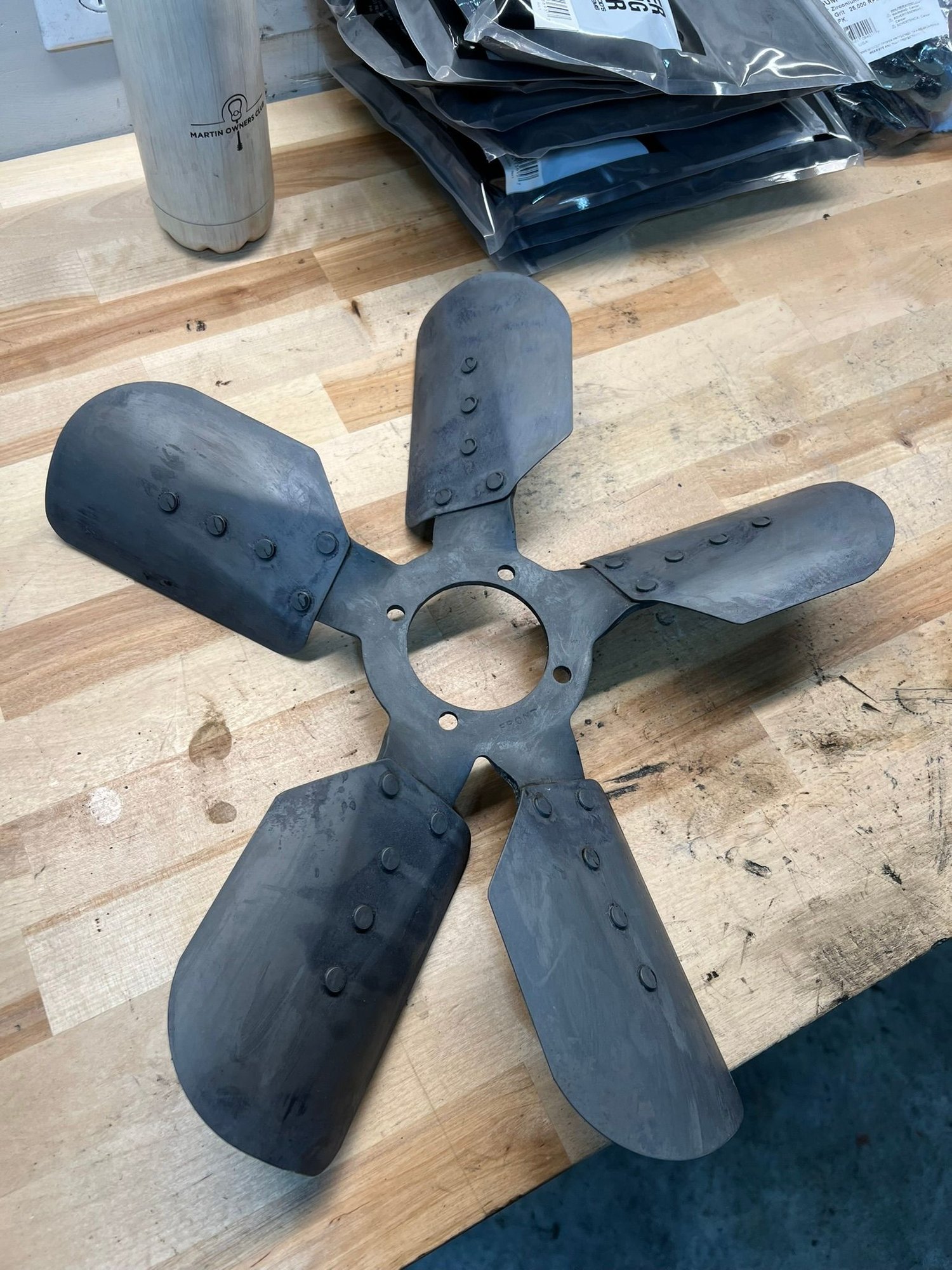

Meanwhile, back at the powder coating oven...

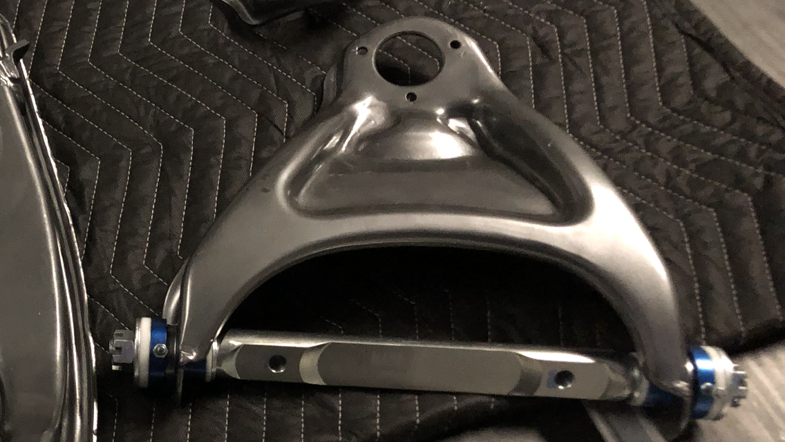

Before: blasted a couple of months ago, sprayed with fast etch.
I wiped it down with pre, coated it, and cooked it for 30 mins.
Definitely not my best results. I think I'm going to have to try to clean things better that have been sitting with fast etch on them...
Next, cleaning off the last few front end suspension parts. I spent 10-15 minutes scraping dirt and grease off the spindle. That pile is ONE spindle's built up gunk...
Then I wipe it down with degreaser and wrapped heavy duty duct tape around the spindle. All the prep keeps most of the junk out of the blasting cabinet. That's a good thing for continued re-use of the media and keeping it from gumming up over time.
Lastly, results after just 15 minutes or so in the blast cabinet.
Trying to decide whether or not to PC it before or after I run it over to a machine shop? It's not in the worst shape, but not perfect either. I'm thinking about seeing if they can polish it up. Thoughts?
All that's left to clean up from the front suspension are the front rotors. They'll likely be taking a trip over to see if they can be resurfaced. I'm thinking of blasting and PC them first, but have the same questions there as on the spindles.

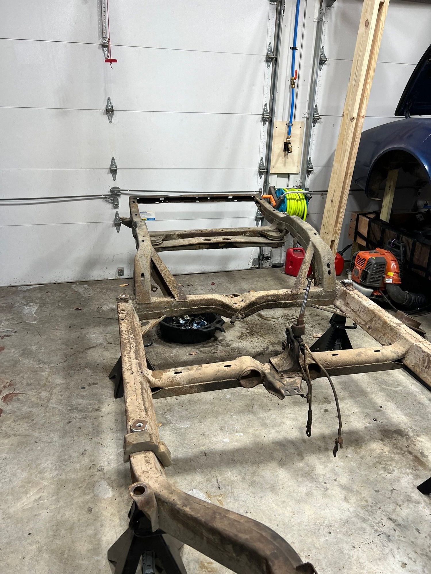

Yesterday's work: A whole new pile of parts to finish disassembling, cleanup, PC.
Almost a completely stripped frame, just a couple more things to remove before I start the once-over and consider next step on it. The goal was to have it ready for re-assembly when it warms up in the spring, and I should make it no problem.

Thanks everyone!!! I'm still having a ton of fun, so it's easy to get back out to the garage. I think it's my OCD, but removing nasty looking parts, blasting them clean and powdercoating them to look better than new is fun for me. I was reading through the assembly guide over the weekend and it was pretty overwhelming! I'm going to focus on just doing one small thing at a time and see where that gets us.
I'm taking a couple of days off for Thanksgiving and I'm hoping to keep making progress. The short term goals are:
  • Remove the rear crossmember. That **** is stuck on, so I need to do some research on strategies to remove it
  • Take the frame outside and pressure wash it. There's a ton of dirt and grime on it still and I want to get a good look at it.
  • Give the frame a whole once-over, then practice my new welding skills fixing up anything wrong with the frame (I haven't found anything yet, so cross your fingers for me when I flip it over
If I can get all that done by the end of the weekend I can try to schedule dropping the frame for PCing drop off in the next week or two. I'll be happy if I can get to that point by the end of the year.

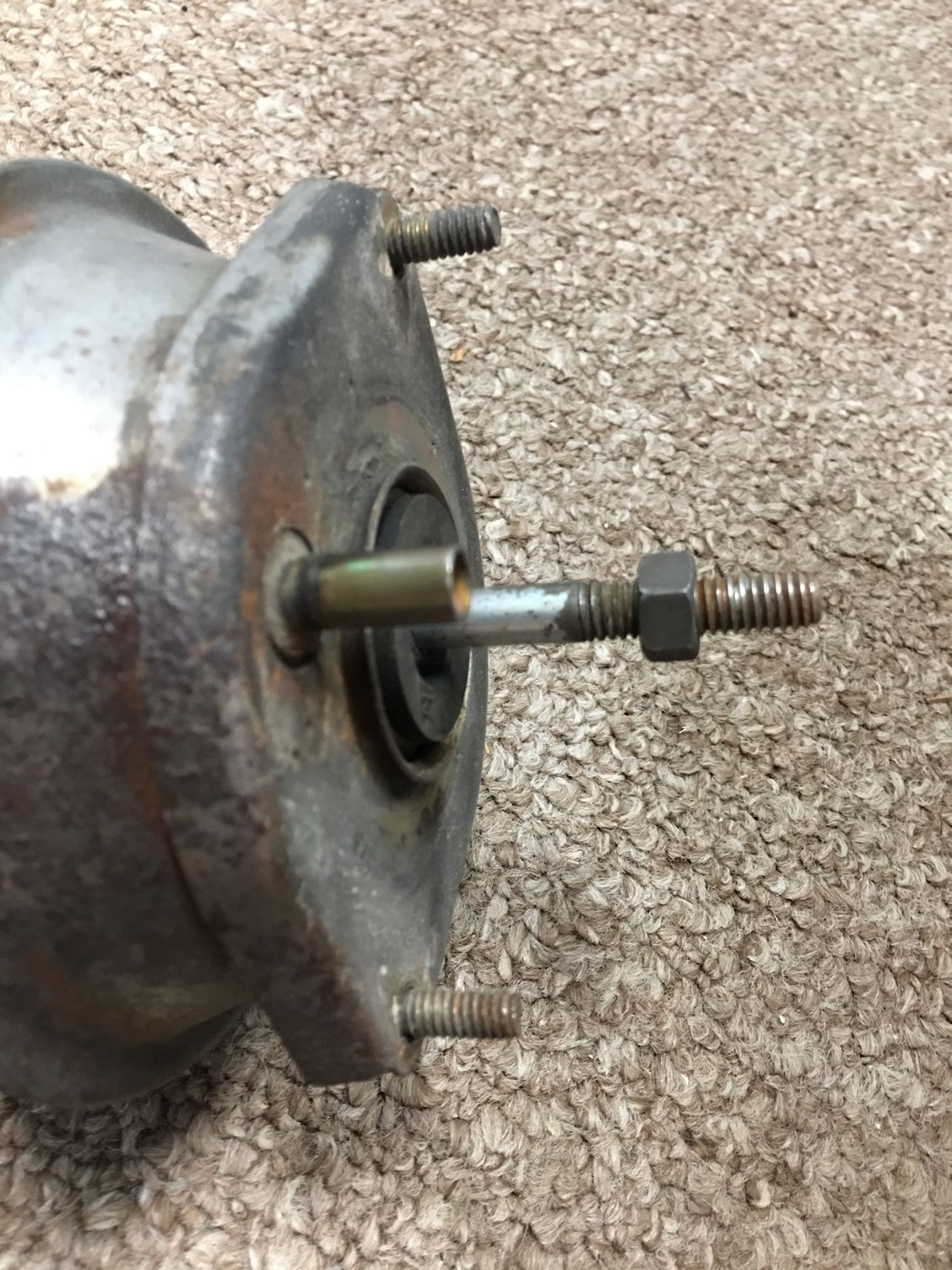

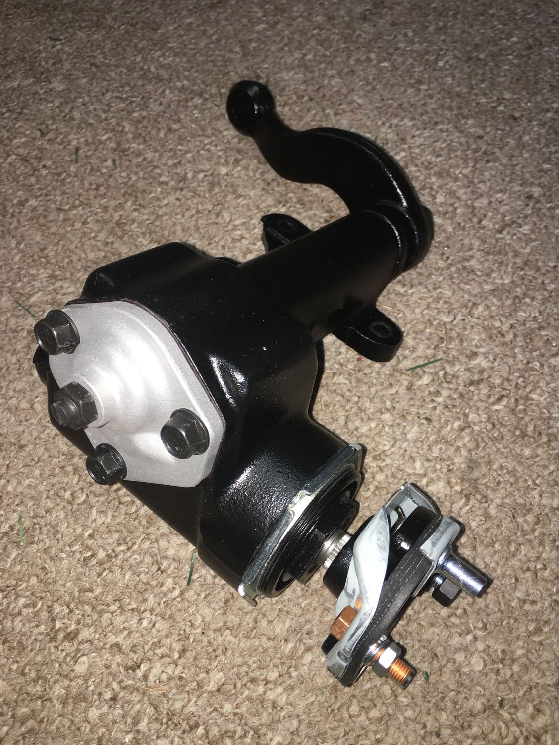

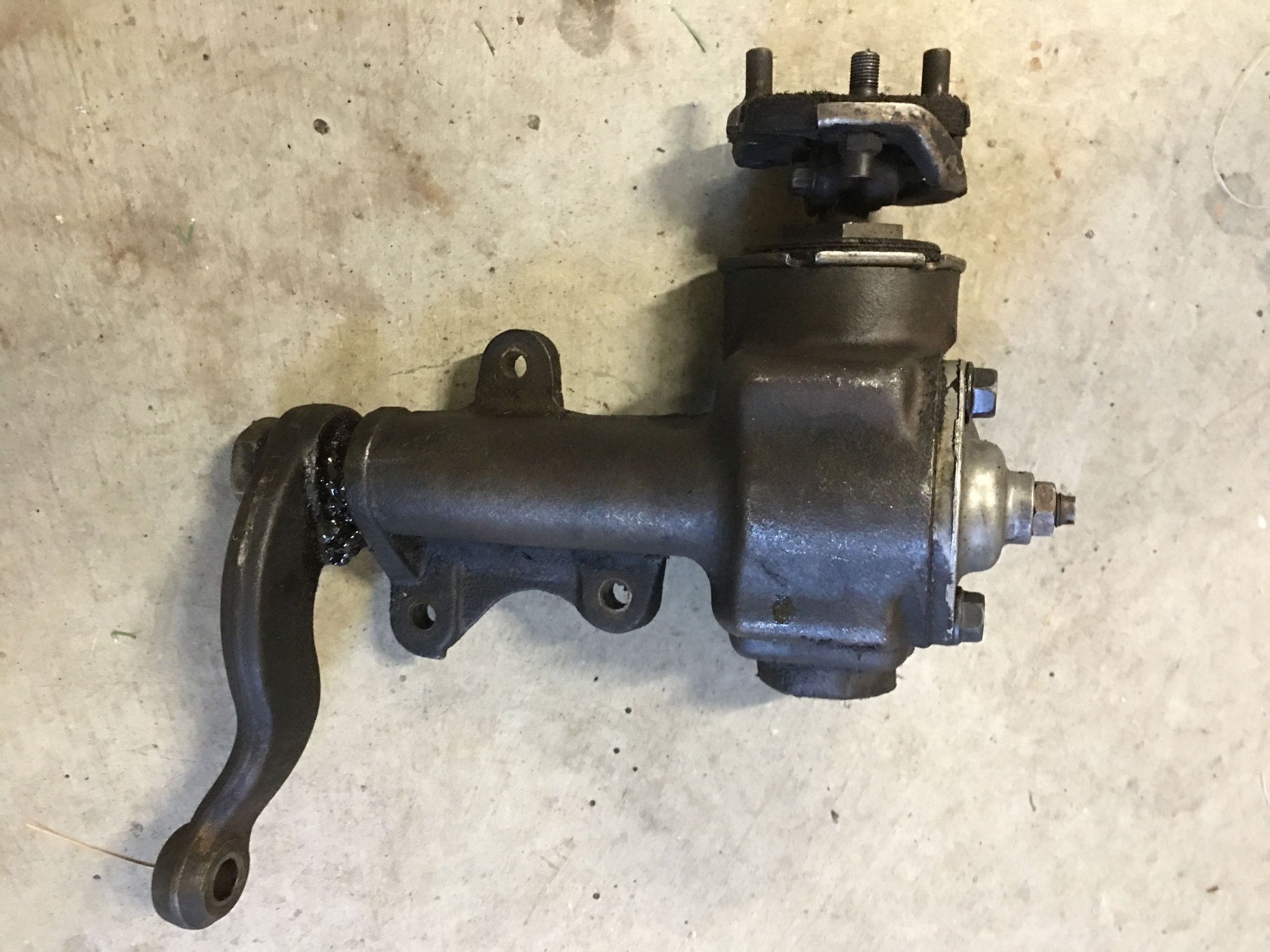

For rebuilding your steering gear (unless you plan to DIY), check out Bair's Corvettes - http://www.bairscorvette.com/service...eeringbox.html
Here's before and after from our '72. The steering feel was greatly improved, with all 'slop' removed -

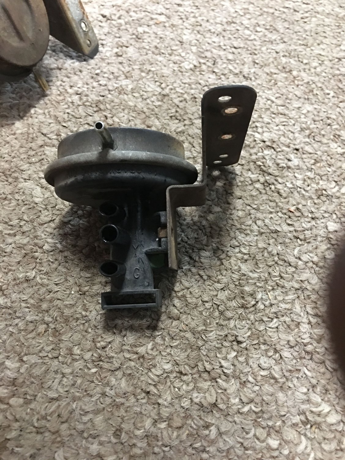

Also, if you want your headlight vacuum relays or wiper door cannister restored, contact Bob Demmel in Texas - bdemmel34@gmail.com
B4 and after -

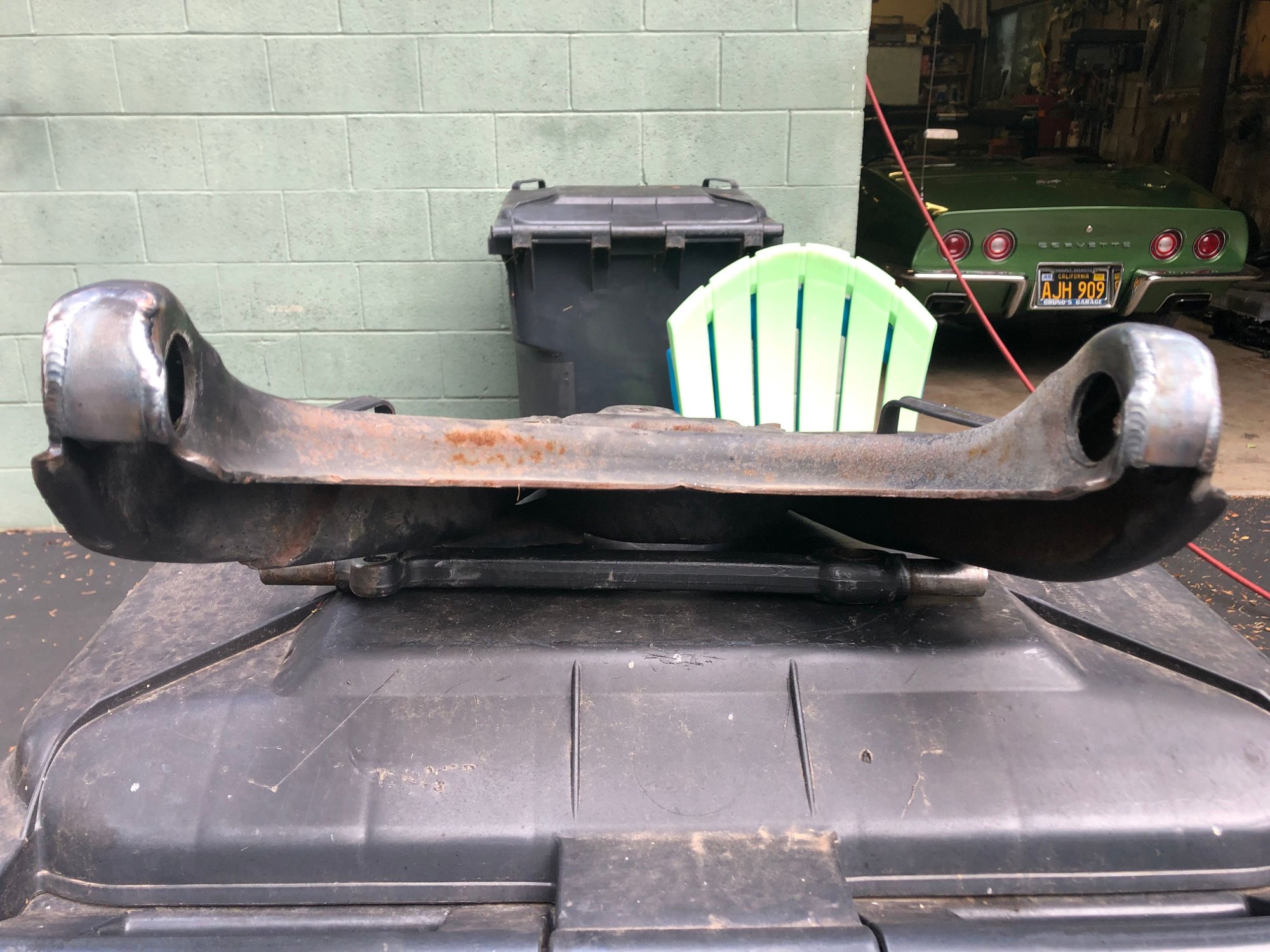

I read all the horror stories on how people had issues getting the rear crossmember separated from the chassis.
I thought about how I would do mine while expecting the worst scenario.
I used the weight of the rear differential to assist me.
I bolted the rear center section back onto the crossmember and put a hydraulic floor jack under it to hold it up and put a chain around the differential and jack to hold everything tight. (A strap would also work)
I loosened the bolts that attach the crossmember bushings and sprayed the bushings and hats with PB Blaster.
Then I slowly lowered the jack a slight amount, just enough to take the weight off the jack but still keep contact between the center section and the jack, then I walked away.
I actually used my hydraulic transmission jack, but it’s the same thing.
I came back in a couple hours, loosened the bolts a little more sprayed everything again, dropped the jack a little more, then walked away.
I did this several times and I think it was by the forth time the weight of the differential pulled the bushings out of the hats and I didn’t need to pry on anything.
You will need to place some counter weight onto the front of the frame.
I used some weights I had plus the wheels and tires.
Personally, I'd send it to GTR1999 like I did for mine.
His work on steering boxes is every bit as good as his well-known differential work. Great quality, attention to details, progress updates & photos and reasonable prices.
B4 and after -
Wow, those are both impressive results! I think I need to re-check my expectations on my own results!
Thanks for that write-up. After my post this morning I did some Google searching, which led me right back here. There's a really good thread from ~ 20 years ago, where one of them recommended a gear puller. I picked up a new one today (while at Eastwood to get more glass bead), so I'm going to try that. If it doesn't work I'll be using your method next!
Thanks for the second referral. I'm still holding out hope I can try to tackle it on my own, but it's good to know there are guys out there that I can go to if it proves to be beyond me.
