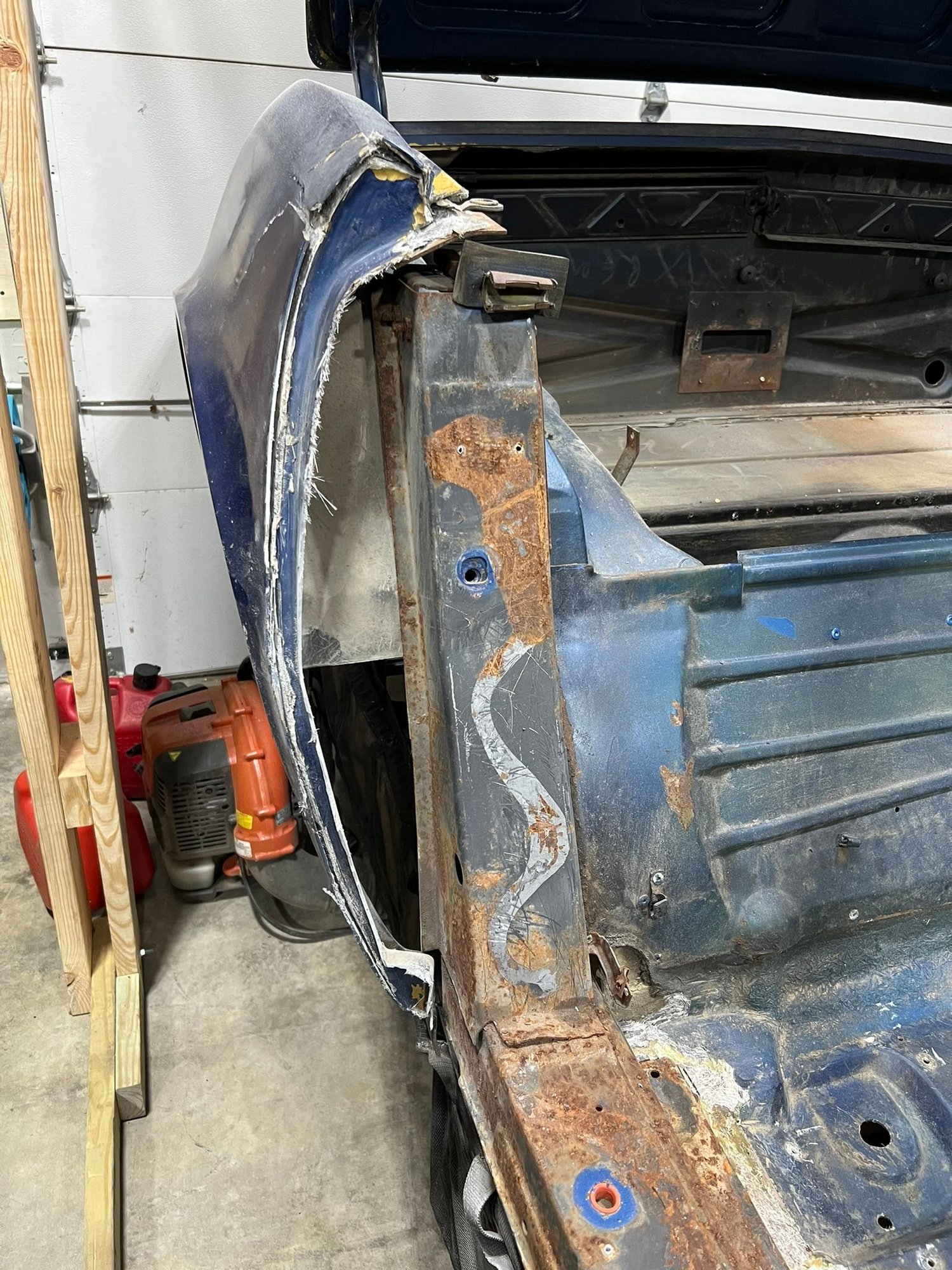

Ok, I have been defeated...
I spent a long time finding the seam between the rear quarter panel and the lock pillar cover. I worked it up and down, all the way back through the top, split the bonding strip, worked it around the top. Trusty heat gun by my side. Figuring out how the bottom wrapped around. Figured out how the top was riveted (twice).
It. Would. Not. Break. Loose.
It cracked the rear fender lower at the bonding strip.
It defeated me.
It didn't stand a chance against my cutoff wheel though...
Now I have to go back and figure out how to get it out of there. Once I could see back in there I realized that the lower half is in a U channel of the rear fender. I have no idea how I'm supposed to separate that out without cutting it out. On a happy note, the latch pillar actually looks pretty damn good.
The driver side I didn't even fool around, just cut it out. That pillar looks even better.

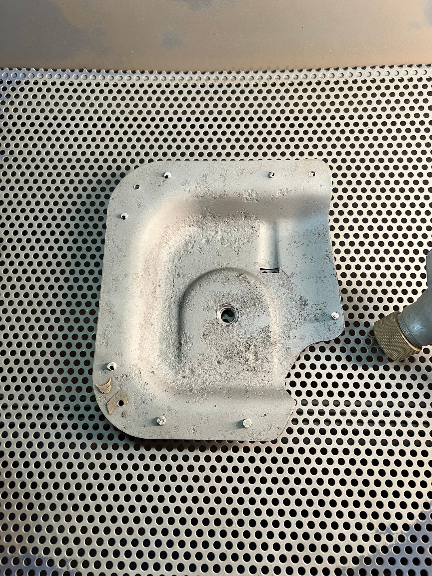

I think I have the sickness, because now I'm thinking: Do I keep going and remove the rear fender lowers so I can get to every inch of the birdcage?
I'm thinking NOT, so I moved onto something more fun:

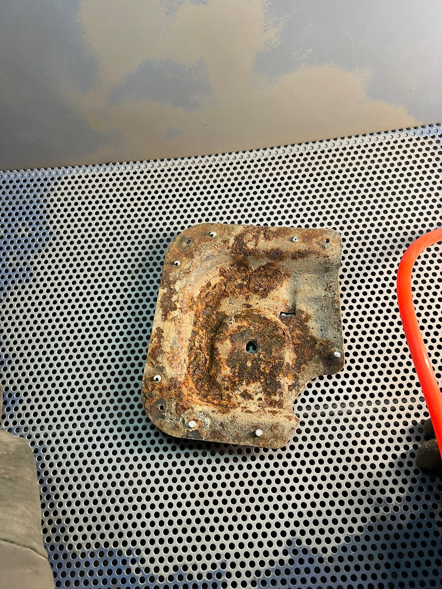

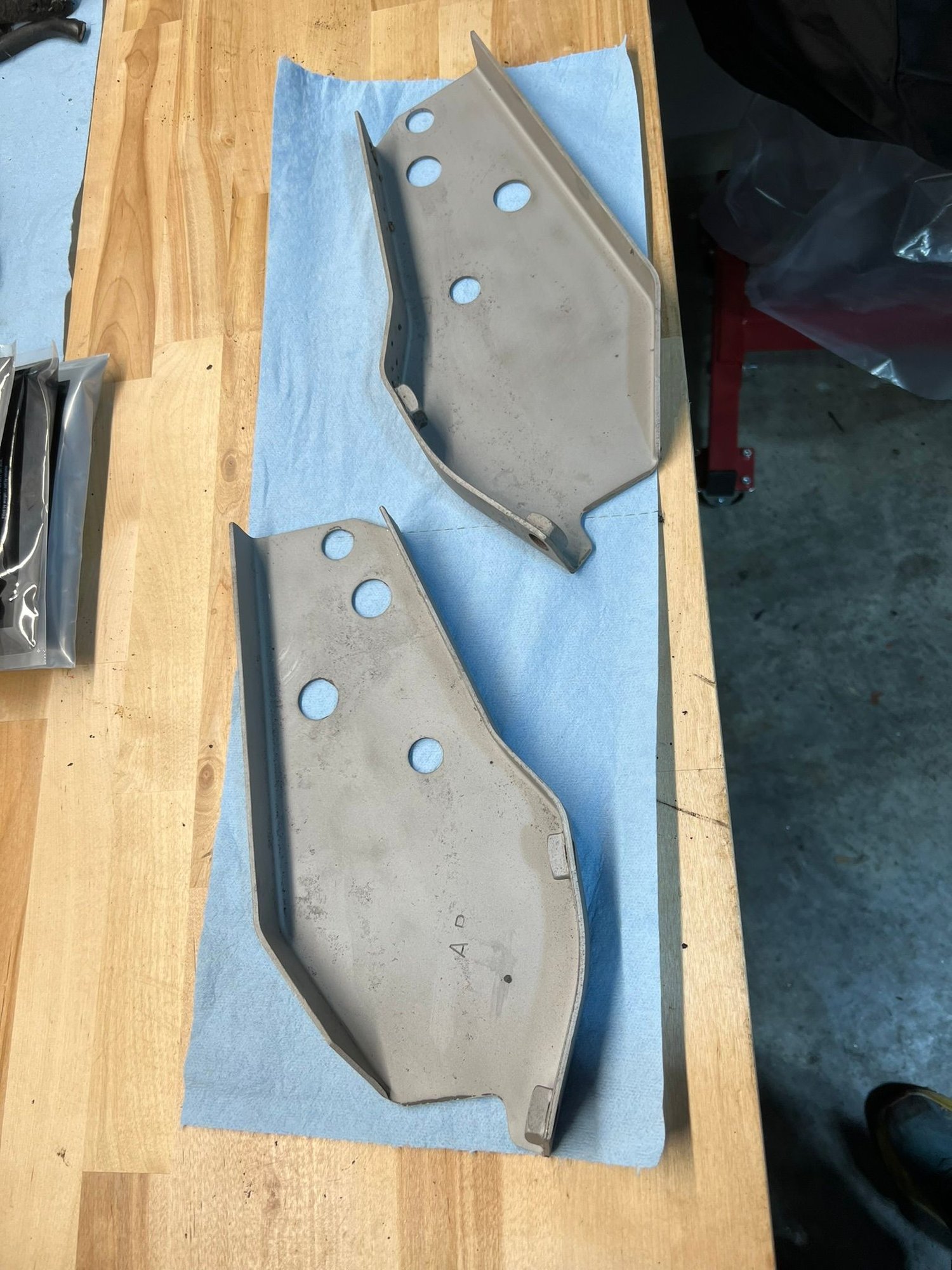

Cleaning seatbelt retention plates. The before and after is just shocking.

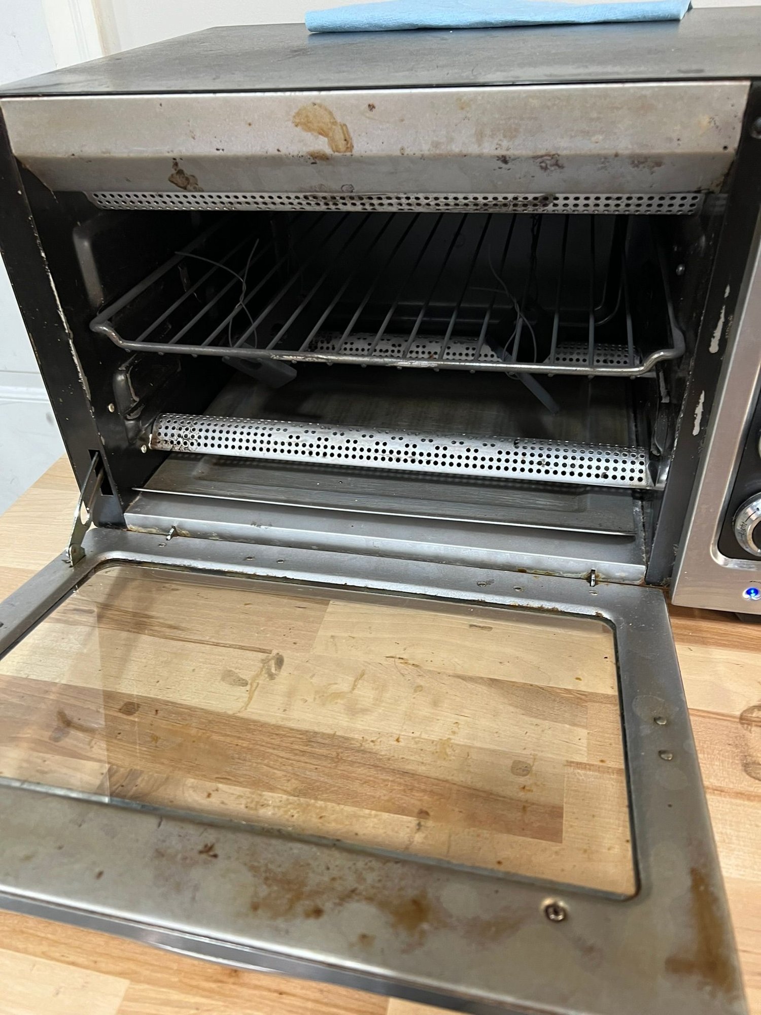

I couldn't find a cheap enough oven on FB marketplace, so I bought that little toaster oven for $30. It should get up to and hold 400 degrees, so the plan is to try a couple of simpler pieces before committing to running a whole new circuit to power an oven in the garage...

That newly exposed (striker panel) part does look really good. Dang shame it took so much glass cutting to get at it only to discover it. I think I have that very same toaster oven, given to me after helping my wife’s co worker install a new microwave over their stove. I am looking forward to seeing your powder coating. I’m convinced on it’s superiority. I have always been a primer/sealer/paint guy and intend to never let mine see a damp road, but would feel a lot better if everything was powder coated. Seat belt plate came dang clean. Too bad that get’s hidden, because I’m sure it will look night and day once done.

Good luck getting the chassis into that toaster oven!
A lot of guys have bought freestanding stove/ovens used and have them in the garage for powder coating.
I wish I had the room in my small garage for the equipment I need so I wouldn’t have to keep paying other people.

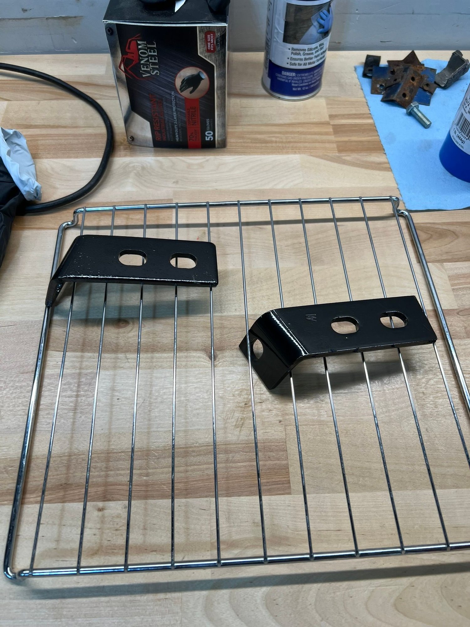

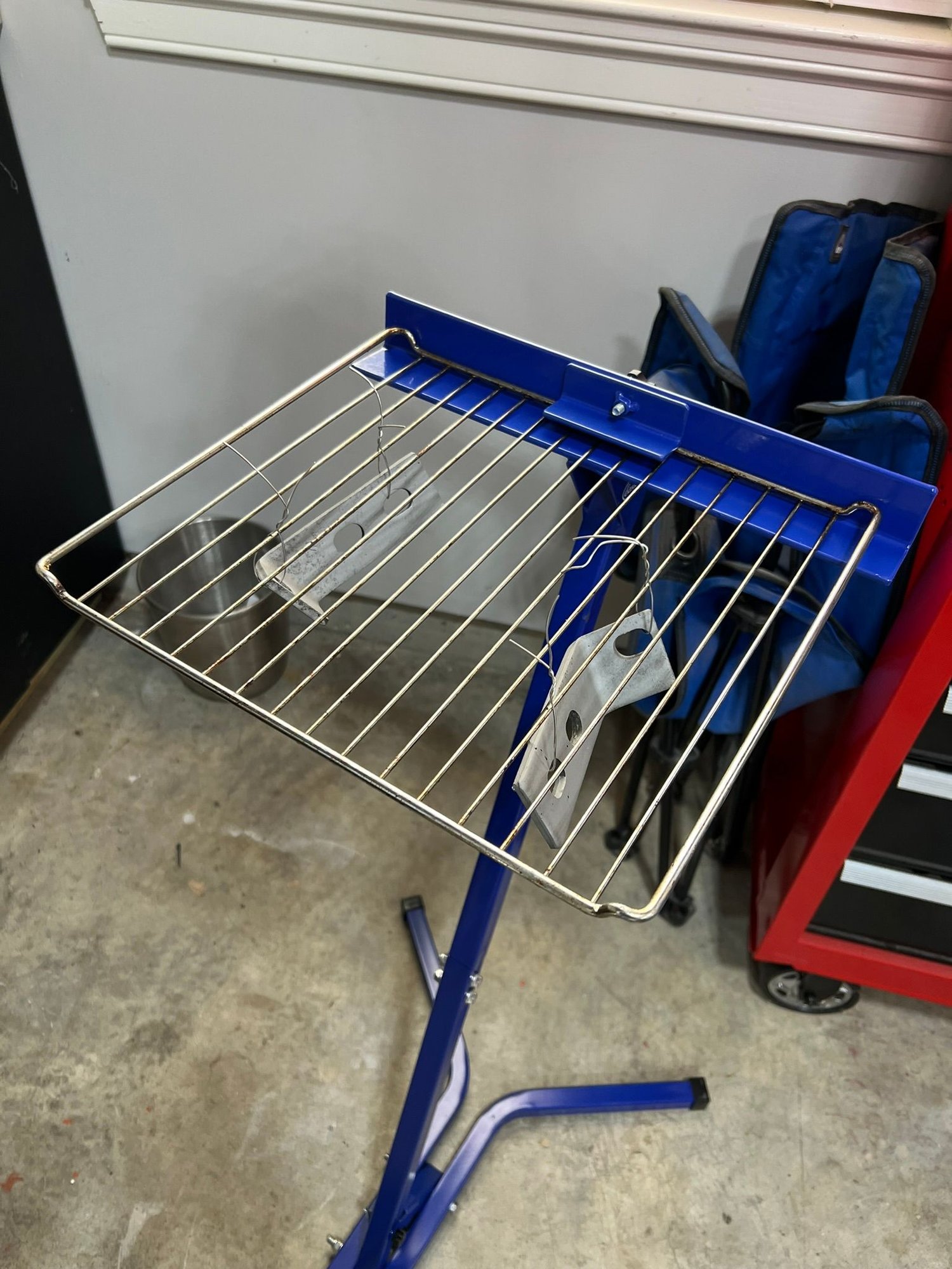

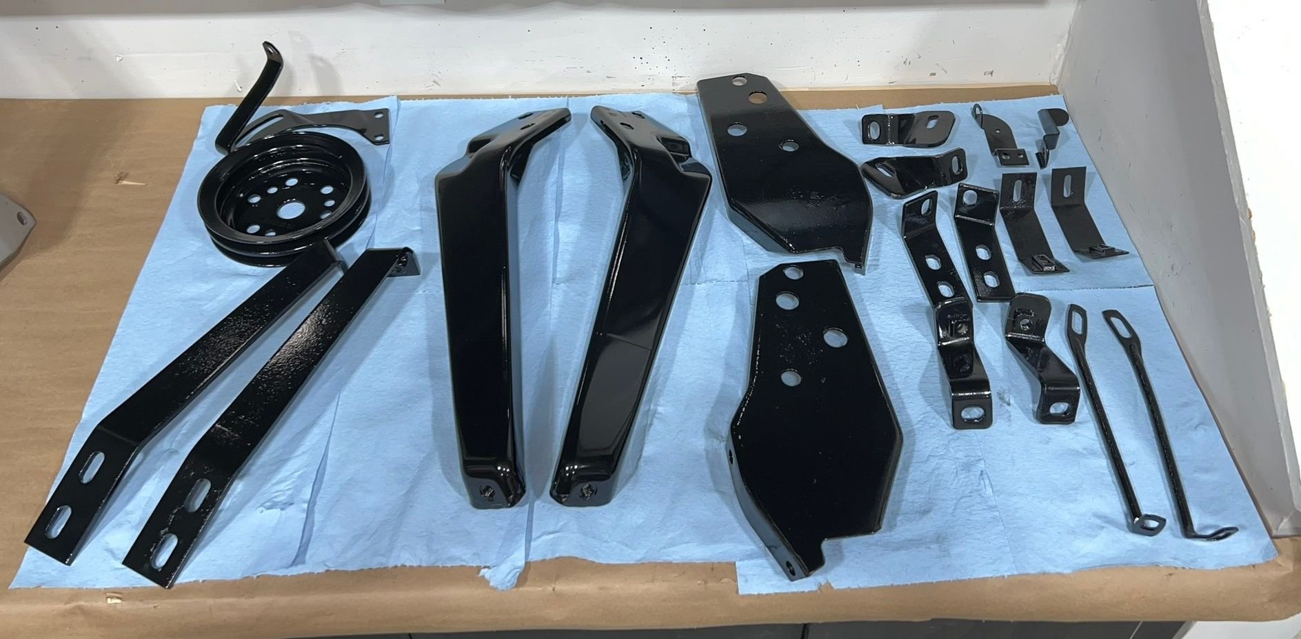

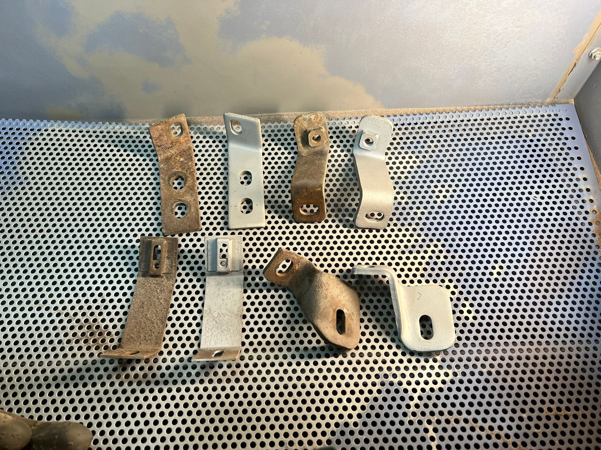

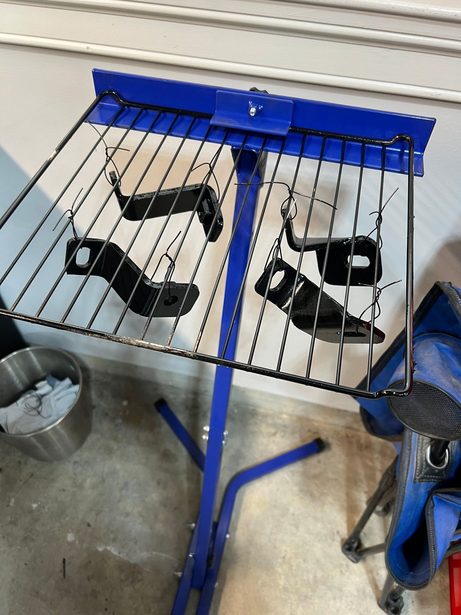

Yup, that's my plan. I've been keeping an eye out of FB marketplace for a decent one, and planning for a new outlet in the garage to support it. I found this cheapo on FB close to my house so I could start playing with the kit...
I spent an hour or two working on it, and it really IS as simple and awesome as it looks.

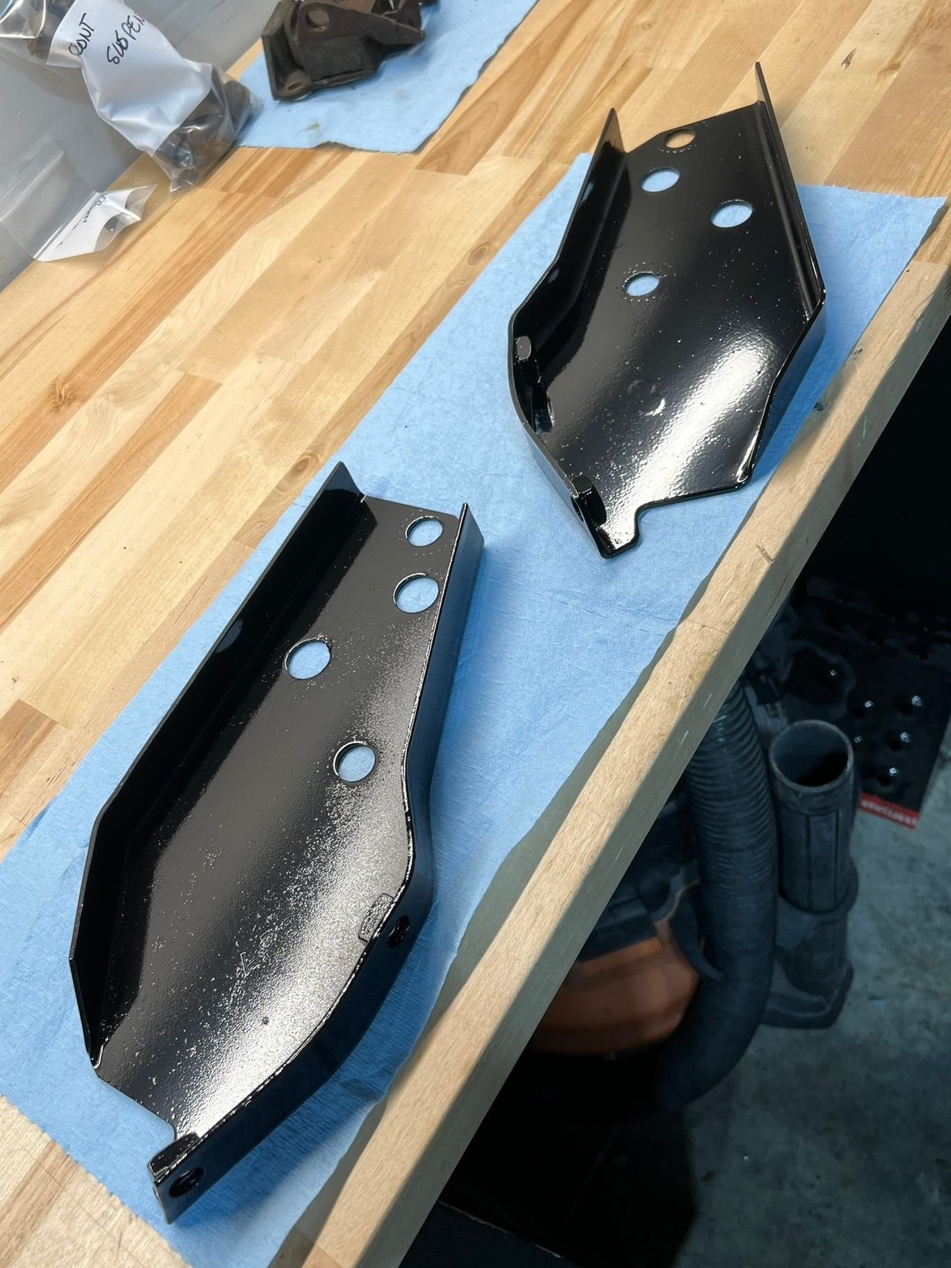

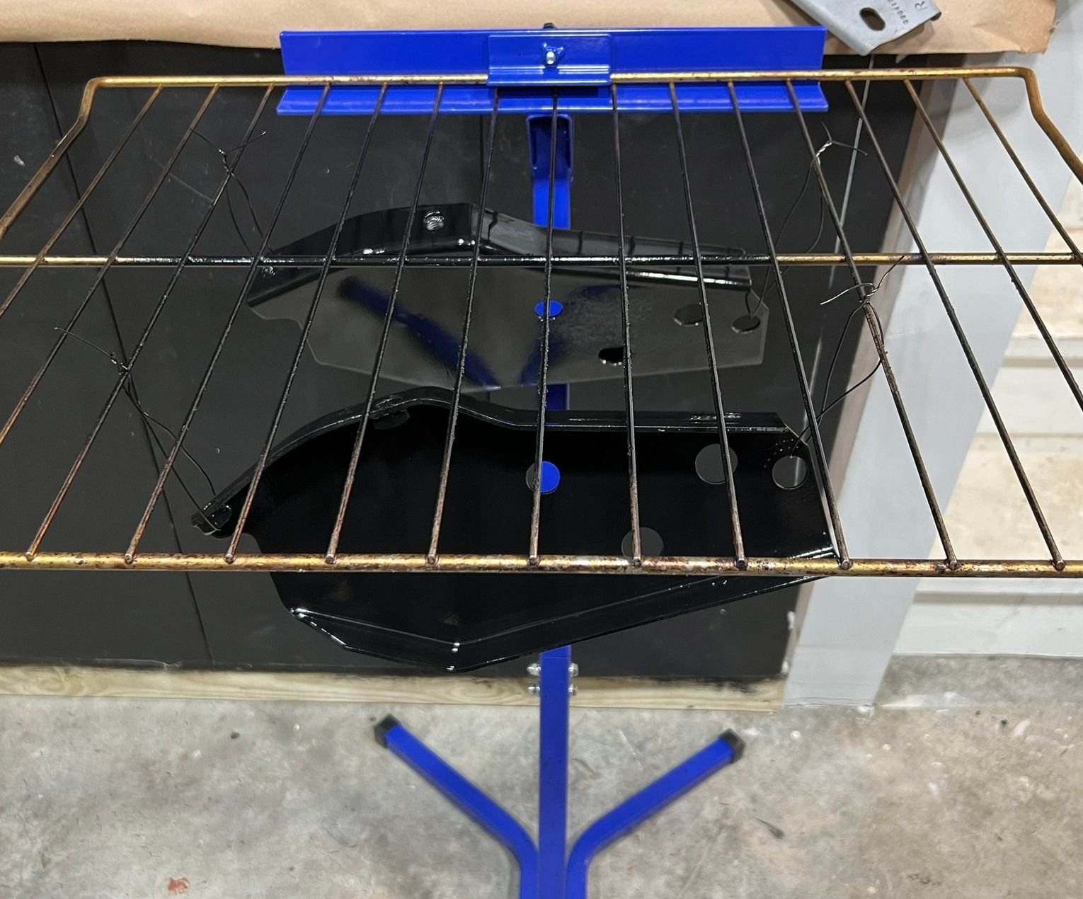

First I degreased parts using Eastwoods Pre, then I hung them from the rack:

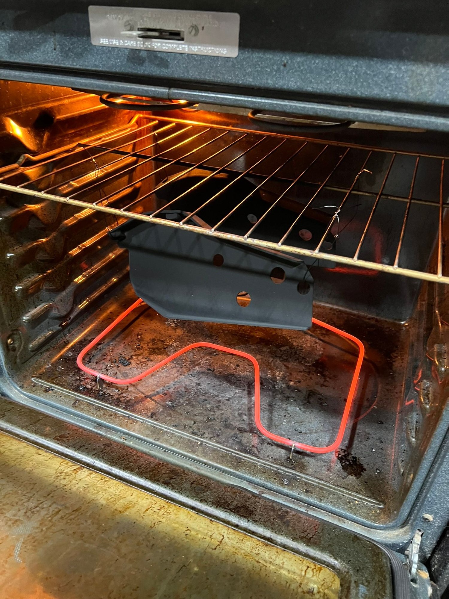

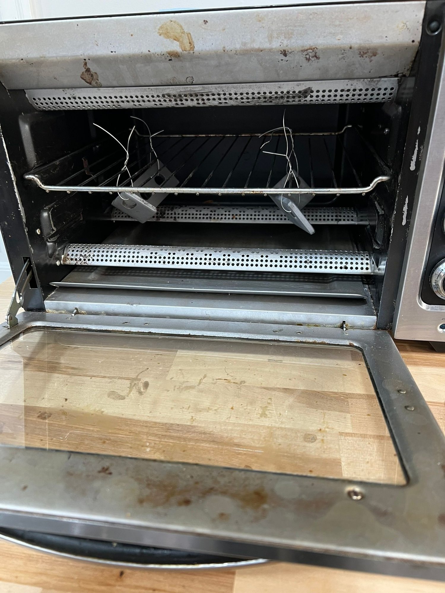

These were my first run, so I put the setup in the oven to see how it fit. They look like they're touching the element, but they're not.

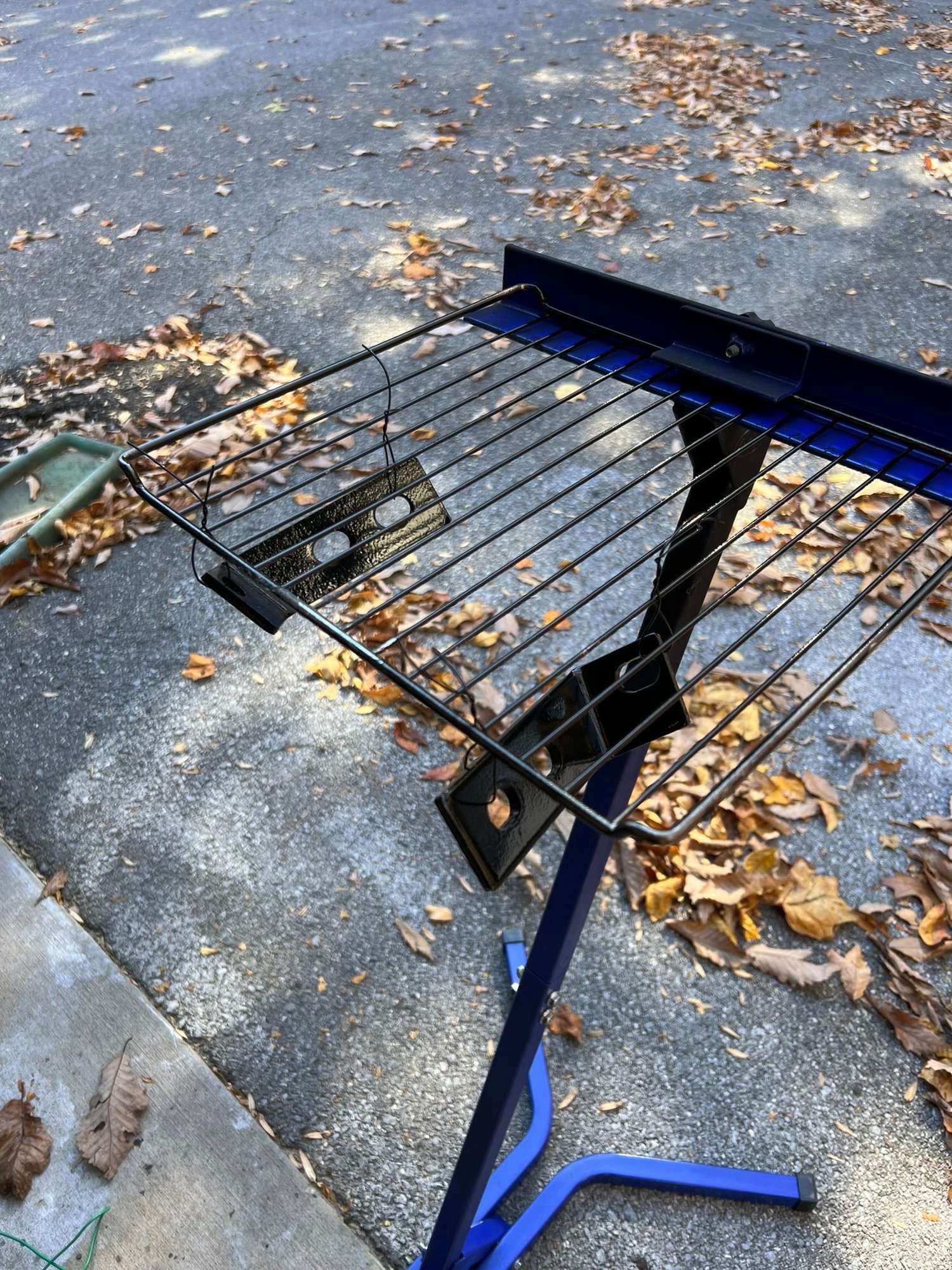

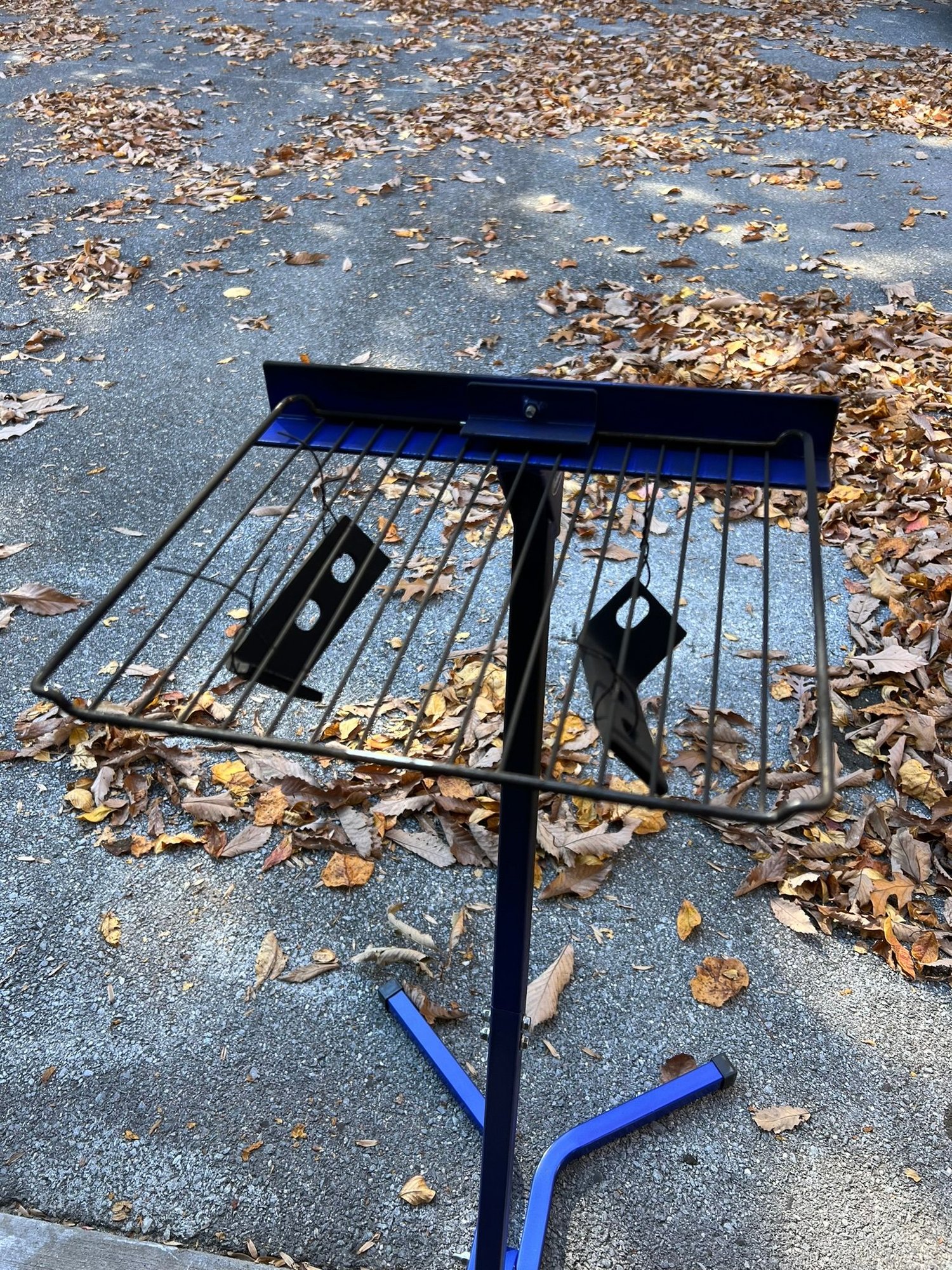

I took the rack back outside, and spent a bit of time learning how the gun works, then coated them. It's pretty simple, once you get used to using 2 hands at once and learning how to move the tip of the gun to get good coverage. I coated them outside because I didn't want to worry about cleanup, and I'm glad I did. It wasn't too bad but it's nice to not worry about it at all.
Next, back in the oven for 25 minutes. The first 5 at 450 degrees, until the powder heated up and went shiny, then another 20 minutes with the temperature lowered to 400 degrees to cure.
This is what they look like out of the oven. Back outside to cool down a bit, it's about 55 degrees here. I also stuck a second batch in the oven while these cooled.
Reminder, here's the parts getting blasted, these are the top left set. These were all pairs, so I did one of each to show before and after. The first of each pair is (obvs) before blasting, the second is after blasting.
Back on the workbench on another rack to rest once they were cool enough to touch. The transformation from before to after is pretty amazing! Aside from some roughness from the removed rust, they look almost brand new now!! This is the finished product, after one coat. I'll probably try a second, just to see if I notice a difference.
Here's the second batch, just out of the oven and cooling.
I learned a few things here about prep, setup, and getting working. I'm definitely a convert to Powder Coating, I can't believe the results AND how simple it is! I will say though that this tiny oven won't cut it in the long run. I have a good bunch of parts that are already waiting to be coated and the majority of them (> 80%) won't fit in this little thing.
It looks like I'm going to have to pick up the pace on finding a full sized oven...

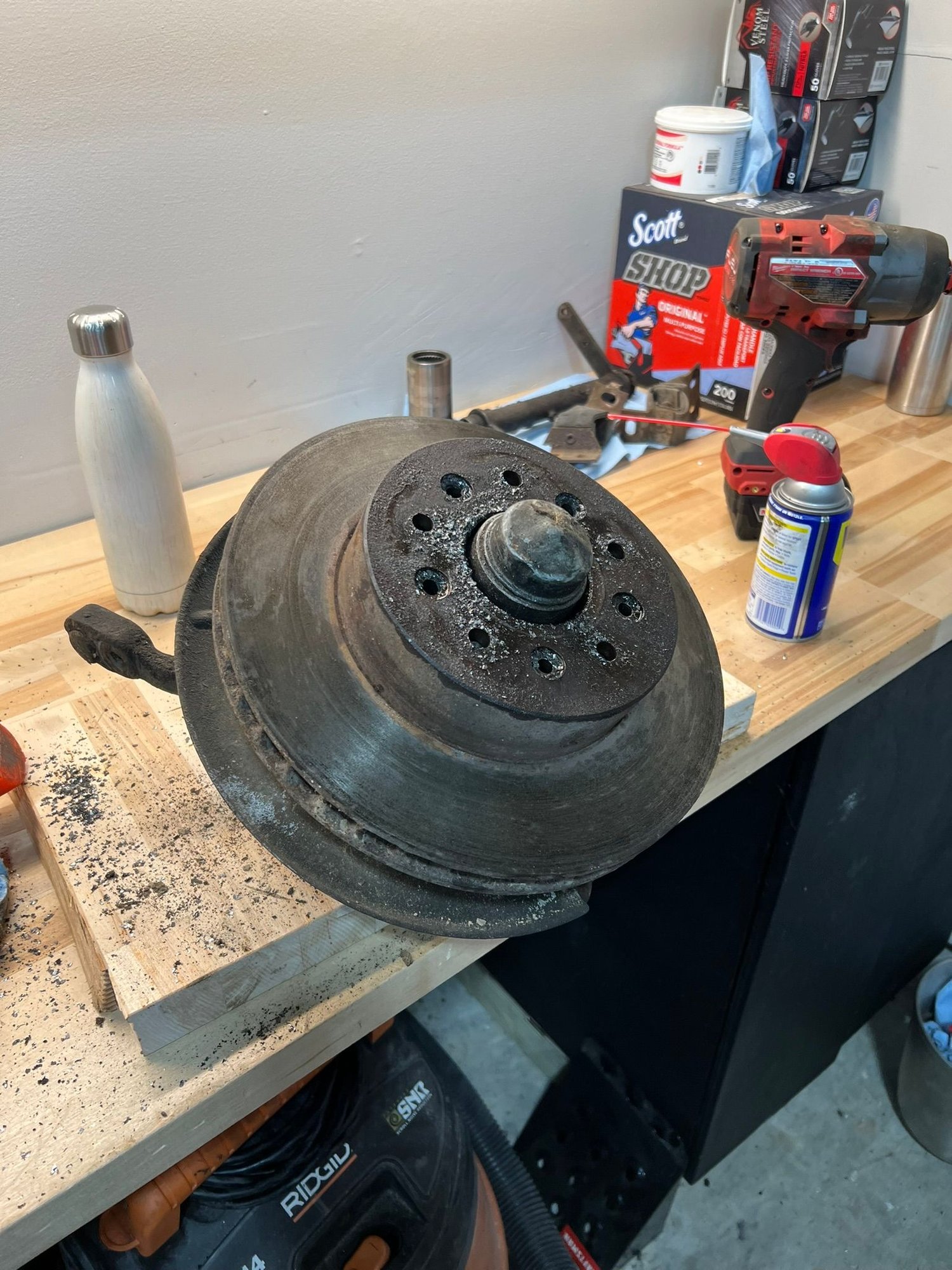

Thanks gents! The hope is that it not only looks great but also protects the parts. I called a PC company and they gave me a quote to get the whole frame blasted and coated. I'm seriously considering it...

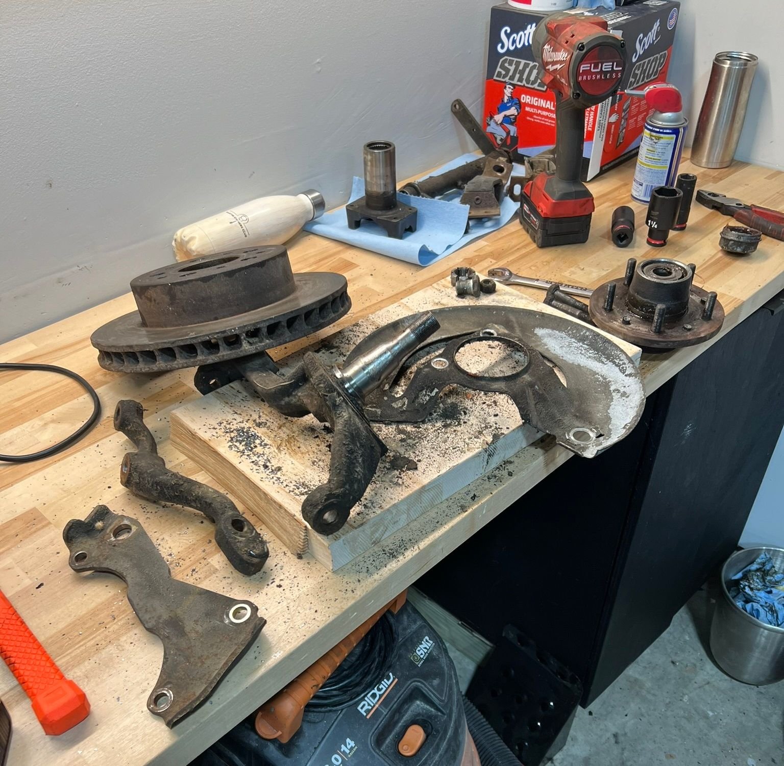

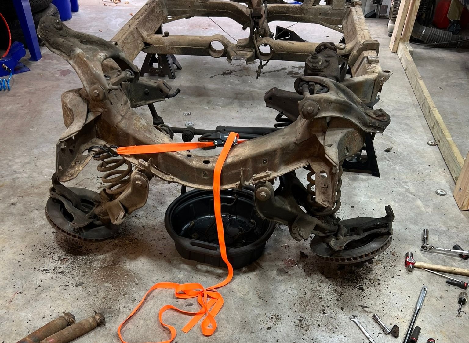

Today I got most of the day to myself for The Birthday, so we made more progress on stripping the frame. The front suspension is off!

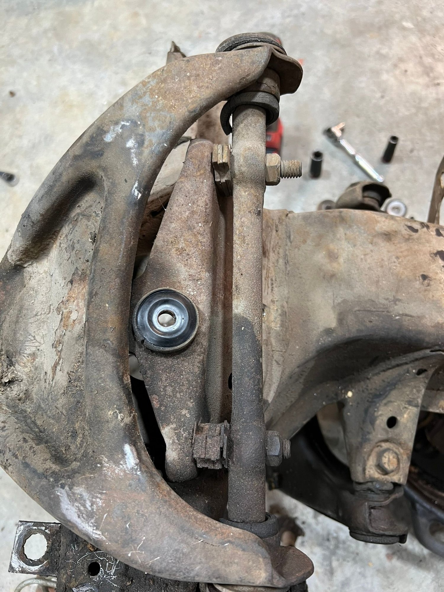

I started by removing the shocks, then using a ratchet strap to keep the spring contained while removing the upper ball joint castle nut. I had my floor jack up under the lower arm to keep it from dropping while I worked. After the nut was all the way out I used a 5lb mallet as The Pursuader to whack the upper arm a couple of times until it dropped out.
I took good pics of the upper arm shims before removing each of them so I at least have a baseline for reassembly.

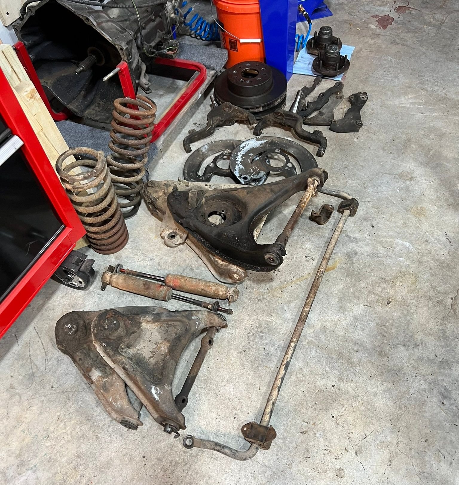

After both arms were off I had to disassemble everything, starting by drilling out the old rotor rivets.
Disassembly was pretty simple after that.
Both sides completely disassembled. I'll be blasting all the parts and powder coating them.

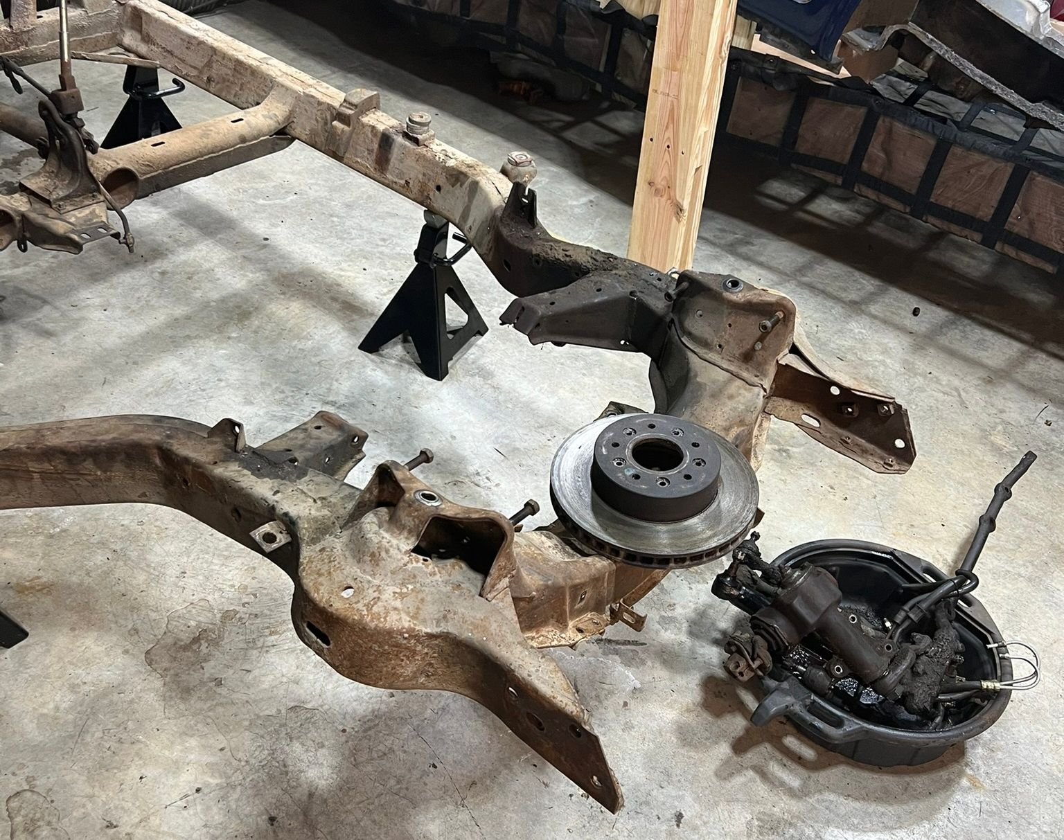

After that the power steering system came out and the whole front end was nekkid.
Yes, the rotor is sitting on the front of the car on purpose. With the whole front end disassembled and the rear still on the car, it's so back heavy that when I removed the power steering pump the front started lifting up. The rotor is all that's keeping it from flipping up.
Tomorrow being Veterans Day is another play day for me. I found a used oven, so I'm picking that up first thing, then a trip to Home Depot to get the supplies to add a new outlet for it in the garage. I'm also planning to hit Eastwood for more powder coat on the way home and I'm hoping to coat some of the larger pieces tomorrow.

I powder coated my frame and it came out amazing.
Before you do, download one or get a copy of Jim Shea’s Chevrolet Corvette Power Book.
There are numerous things in the Power Book you’ll want to do to the frame while the body is off, such as welding the stitch seams and adding gussets for strength.
Especially if you plan adding a little hp to the drivetrain.
If you are thinking about upgrading the suspension or steering research if there are any brackets or pieces welded to the frame.
Also if you plan to swap transmissions will there be any necessary welding.
I thought I had everything covered but didn’t realize I needed to weld on the clutch z bar bracket to the frame until after it was powder coated.
A couple tips on powder coating:
See it the shop will zinc prime the bare metal prior to coating.
Make sure to mark every hole or threaded nut so they do not coat the holes or threads, otherwise you’ll add a lot of your time cleaning coating out of clearance holes and threads.

So, to finish the story:
I got the new box cut and set in the wall, ran the romex into the garage panel, started stripping the wire to install the outlet and...
I got 6/2 romex instead of 6/3.
The oven outlet (and it'll do double duty for a welder) needs 240, so I need 6/3. And it was the ELECTRICAL SUPPLY STORE that gave me the wrong romex, not Home Depot.
So I called them to get the right wire set aside, showered, and ran to lunch at the kids school.
I came home after lunch, changed, and threw the wheels and tires into the truck. Ran over to Mr Tire, dropped the wheels, ran BACK to the electrical supply, got the right romex. Ran home, got the wire run, just about done when I realized I got the *wrong circuit breaker* (Square D vs Square D Home).
I called a local mom & pop hardware store, ran out to get the breaker, stopped by Mr Tire to pick up the rims without tires on them, and went home to finish the outlet install.
New (to me, REALLY needs to be cleaned up) oven:
First large pieces.
They fit easily in the oven, which REALLY needs to be cleaned inside.
Cooling on the rack
Have I mentioned how much I love powder coating??
The current haul. The smallest pieces on the right were done in the toaster oven, all of the pieces to the left of those were done today in the new oven.
Once I finish powdercoating everything else that I've got lined up, these bad boys are next.
I picked up a few different color powders. I plan to do the wheels and brake dust shields in a chrome, and I want to hit the brake calipers in red.
Soooo, I *did* get a lot done today, but...
Imagine how many more things I could've knocked out without so many wasted trips!!
