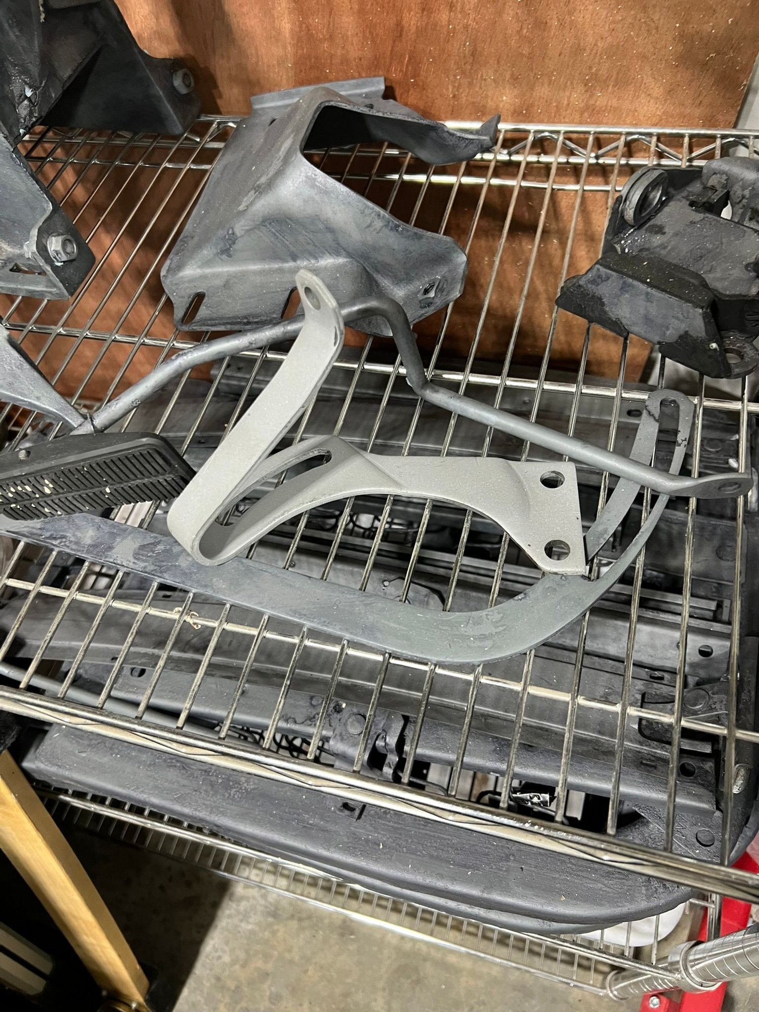

Yeah, it's definitely not that bad here, unless it's spring. I noticed surface rust on the first few pieces where I touched them if they weren't treated, but the fast etch got rid of it and kept new rust from forming. Now I just handle them with gloves when I'm done or use a shop towel.
This is most of the currently treated parts:
That darker color is the coating the Fast Etch leaves behind. All of those are more than a month sitting on the self, and not a speck of rust.
This is one of the newly blasted brackets sitting in the middle, you can see it's a lot lighter in color.

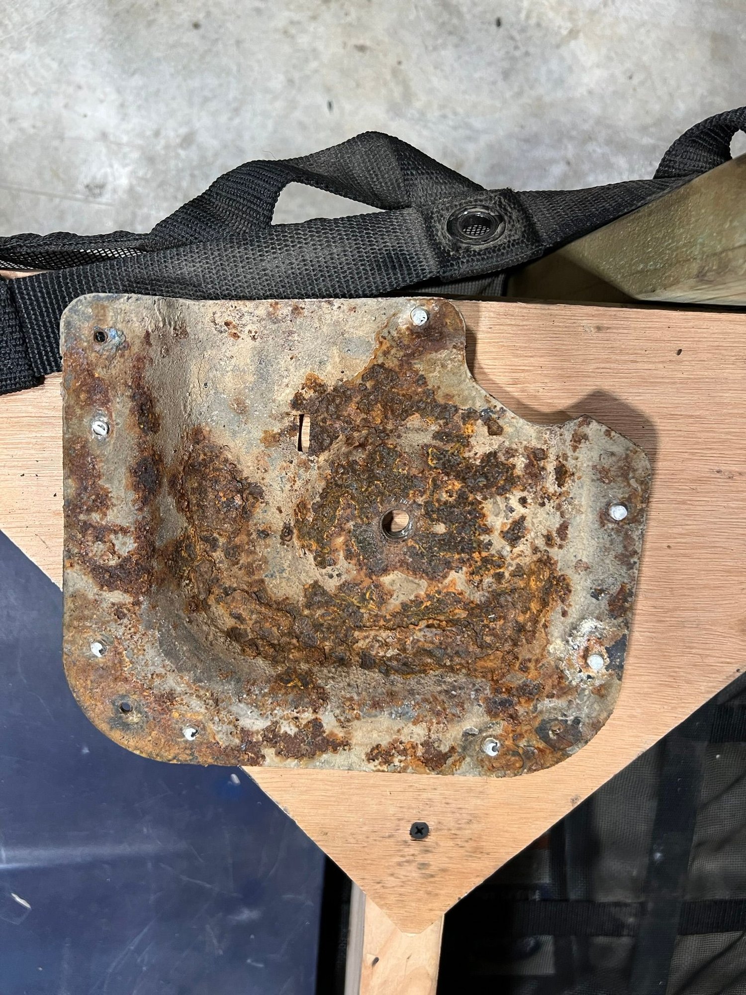

Ok, break time is over, continuing to remove fiberglass...
The good news:
I figured out how the rocker covers were attached to the floor and front pillar
The rockers aren't completely toast
The bad news:
The rockers aren't as good as I hoped
I think I need to take off the door latch pillar fiberglass to check out the rest of the birdcage
More good news:
I have "the opportunity" to blast the plate and see how purty I can make it before reinstallation.
Methinks it may end up being replaced.
I'm going to take off the other rocker cover next, but first I need to build up a bit more support from the dolly to reinforce the floor. Without the two rocker covers it'll just be hanging in the air and at least deform, if not snap.
After that I can remove the two latch pillar panels and finally get a first look at the entire birdcage front to back.
Wish me luck...

Good luck! I dunno man, I’m just seeing scale in the plate and rocker area. I do believe many (do you know Many?) would be happy at this point. Looking like luck is on your side. I could be wrong of course, but looking good from here. I’m like you in that as far as you’ve gone, pulling those striker panels would be in order. To get everything else in ship shape condition and just not know what’s under there would take the fire, zing, zip from all other accomplishments. It would just sit on my slightly ocd mind. BTW, I’m sure your well executed pictorial documentation of all of this is not only helping others, but it is also going to pay you back financially on that future day when you decide to let her go.

Glad to hear that. My initial reaction was "Ugh, all I see is rust", which turned into "Actually, there's a lot of paint still there". Then we went back to "I don't like it, I better hold judgement until I have some time with the wire brush" before settling on "Huh, the paint multi tool isn't even denting it, that metal is still strong. Let's post the pics on the forum and see what The Experts think."

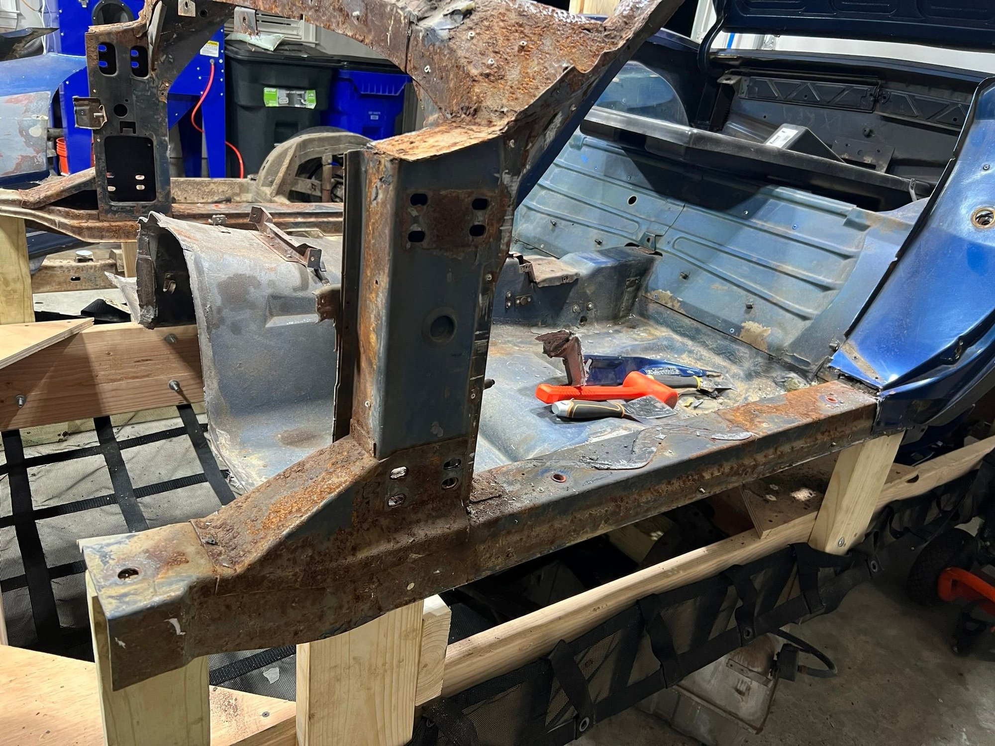

Speaking of disassembly: Today's handiwork...
Driver's side rocker cover removed. This side looks even better than the passenger.
Both sides removed, the floor being held up by some new 2x6 supports. Not that I thought I needed that much, but leftover from building the gantry.
Hopefully I can find a decent video or pictures for separating the latch pillar panels from the rear fender, so those can come out tomorrow. Peeking in the rear tubs, the birdcage doesn't look that bad by the #3 mounts.
