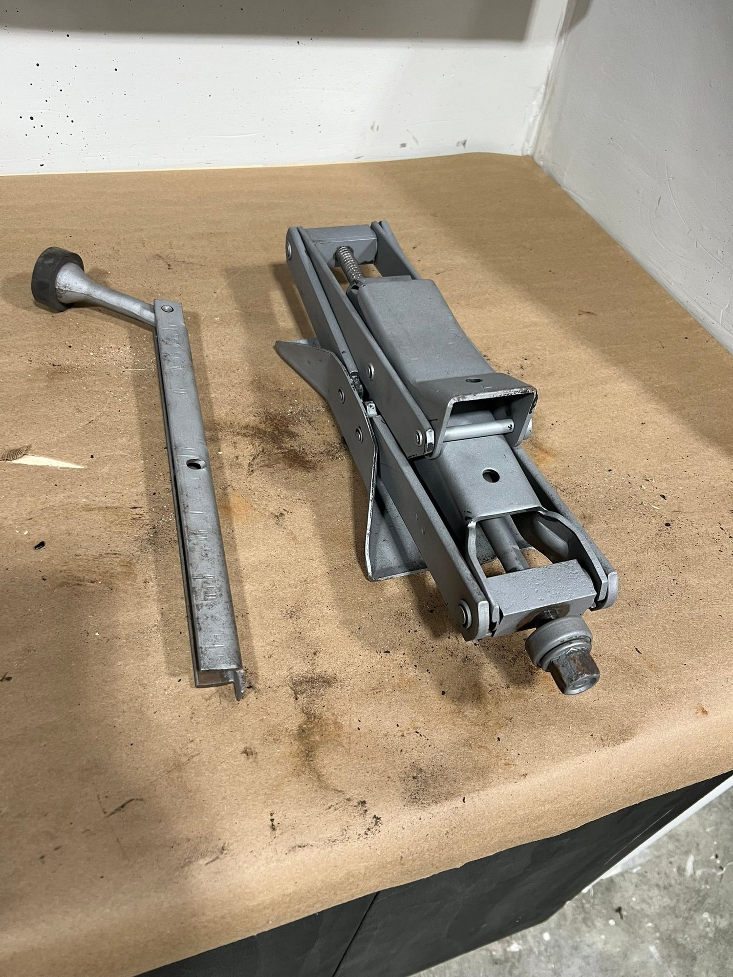

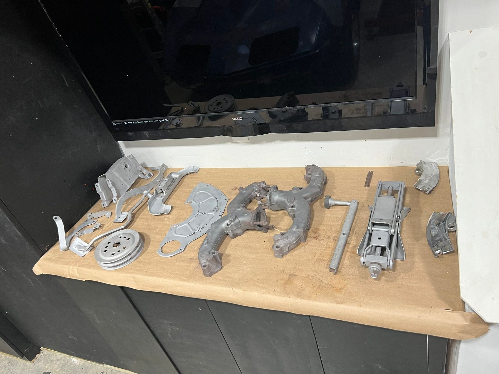

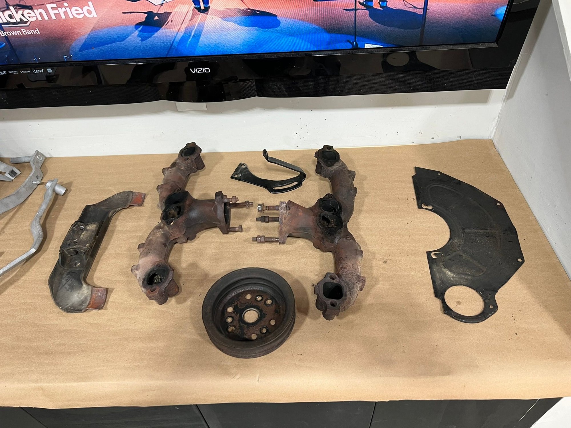

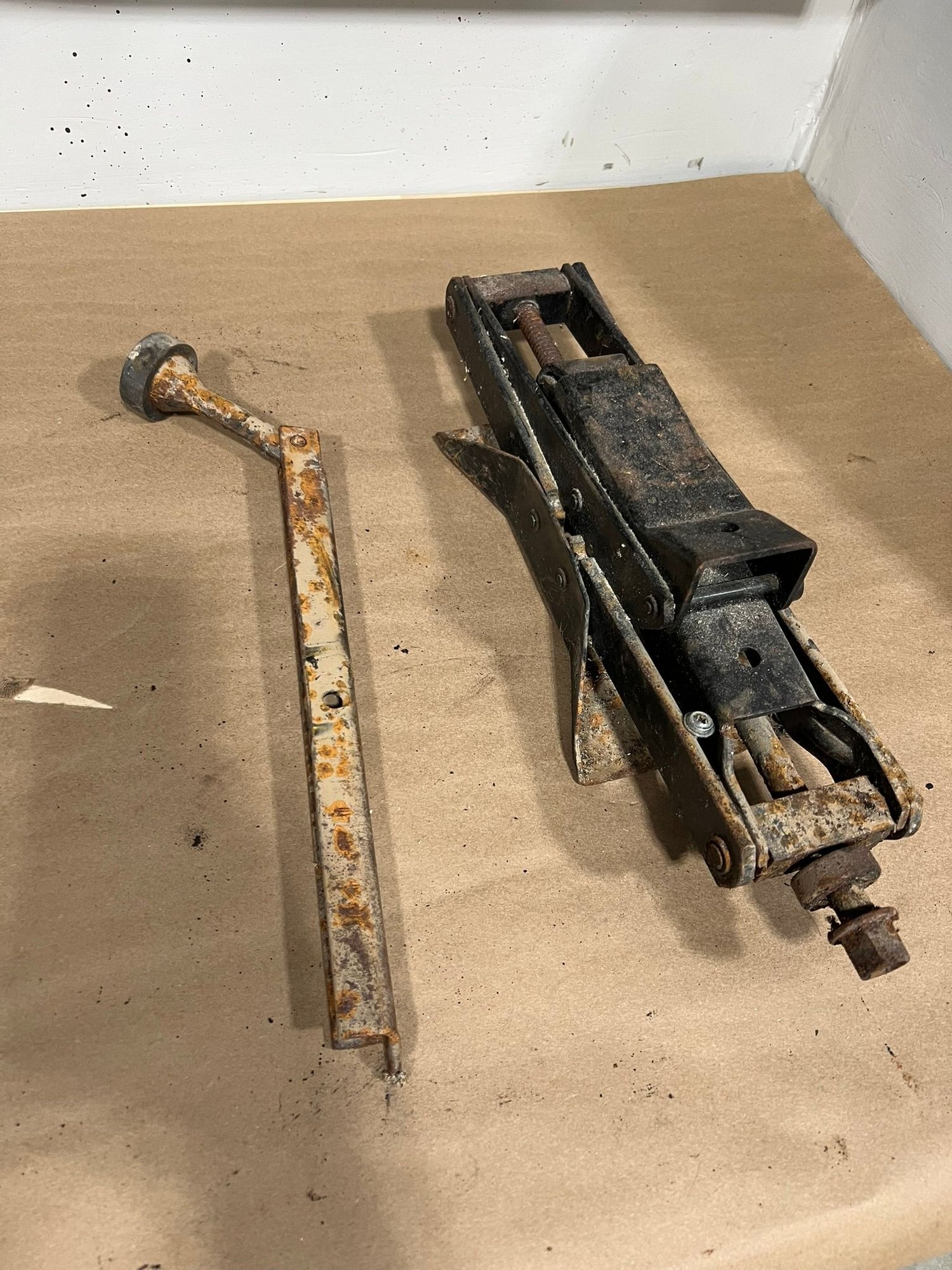

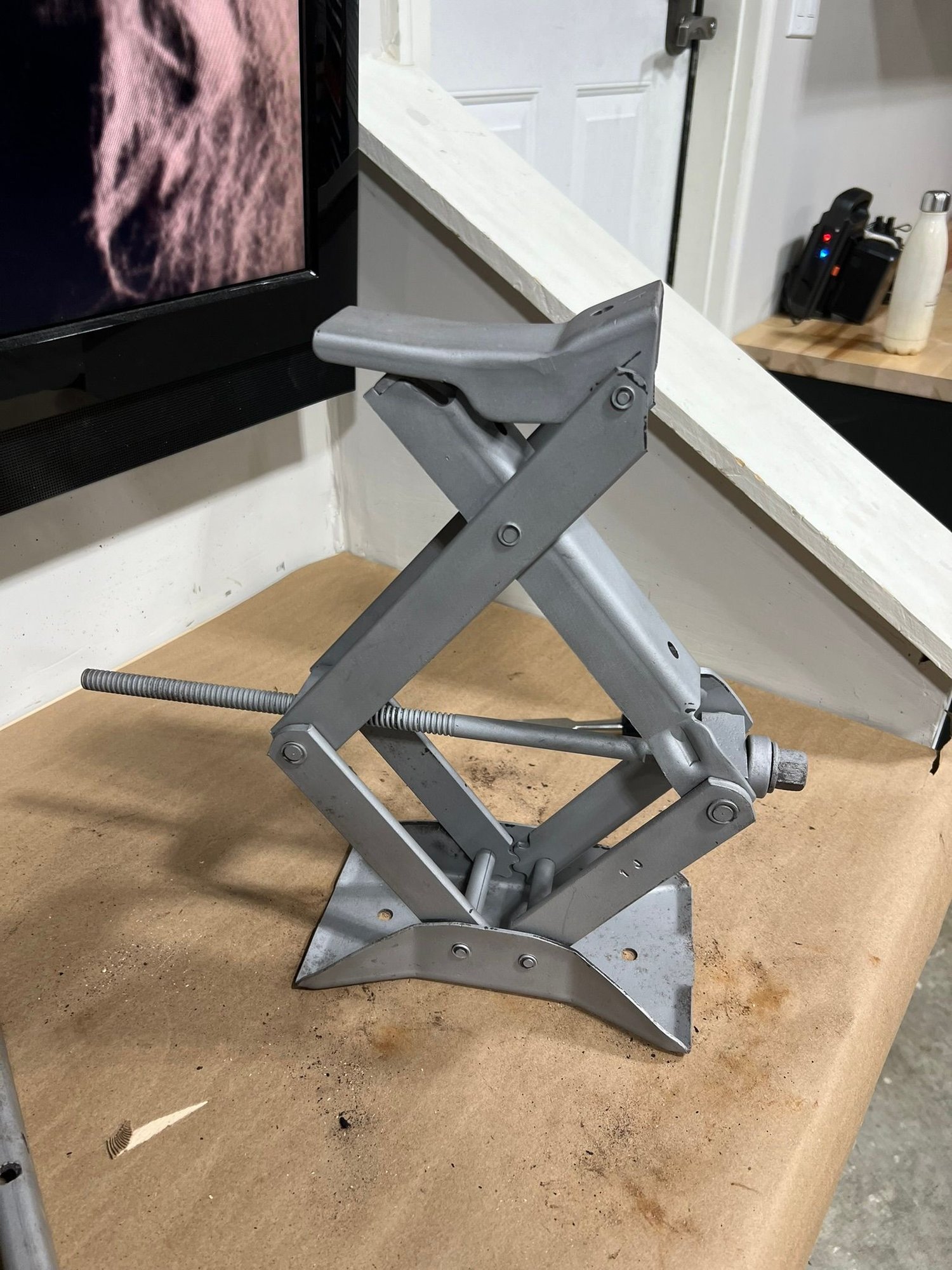

I've also been doing a bunch more blasting of old parts. I'm particularly happy with how the jack cleaned up:
Latest batch:

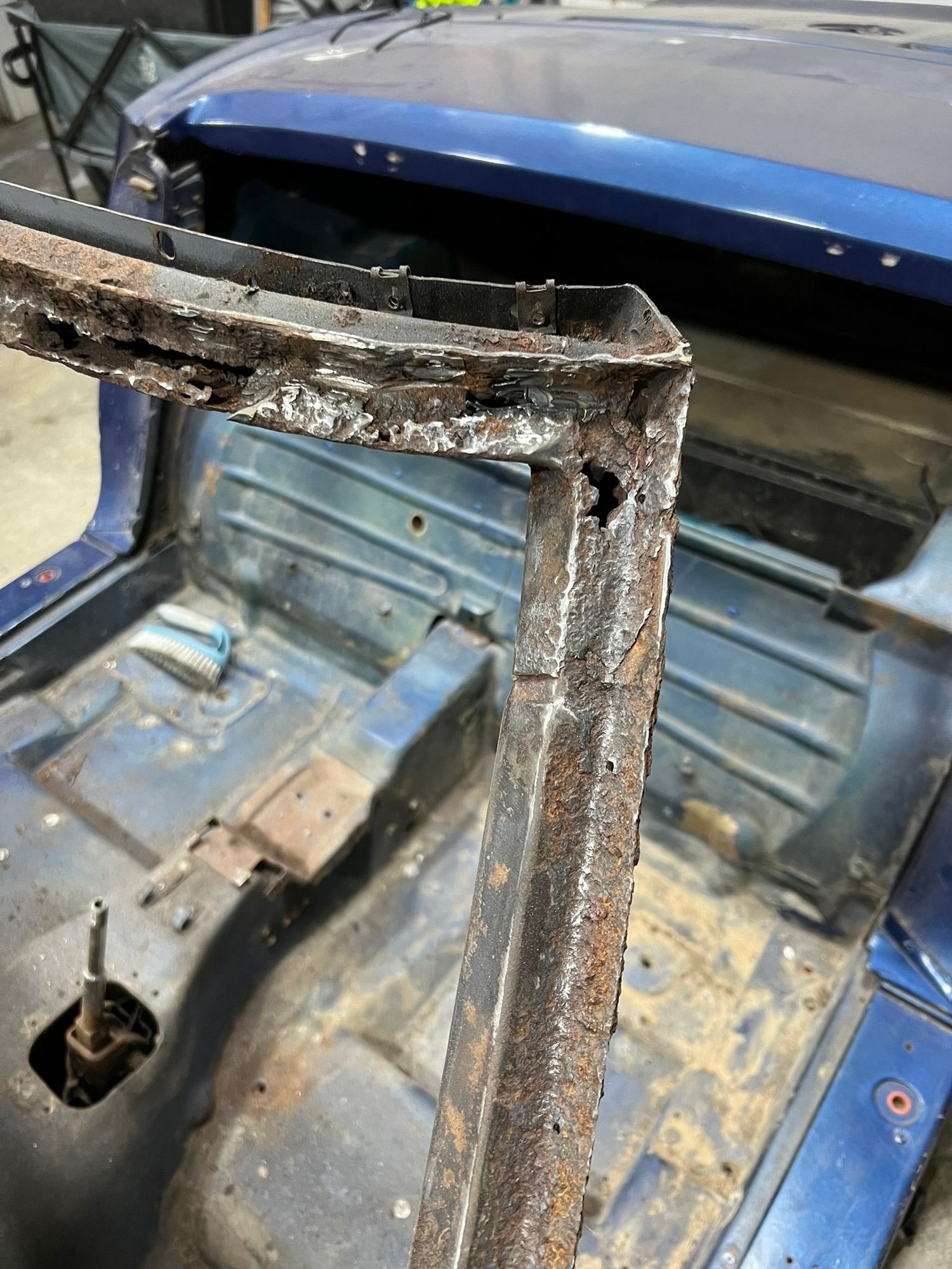

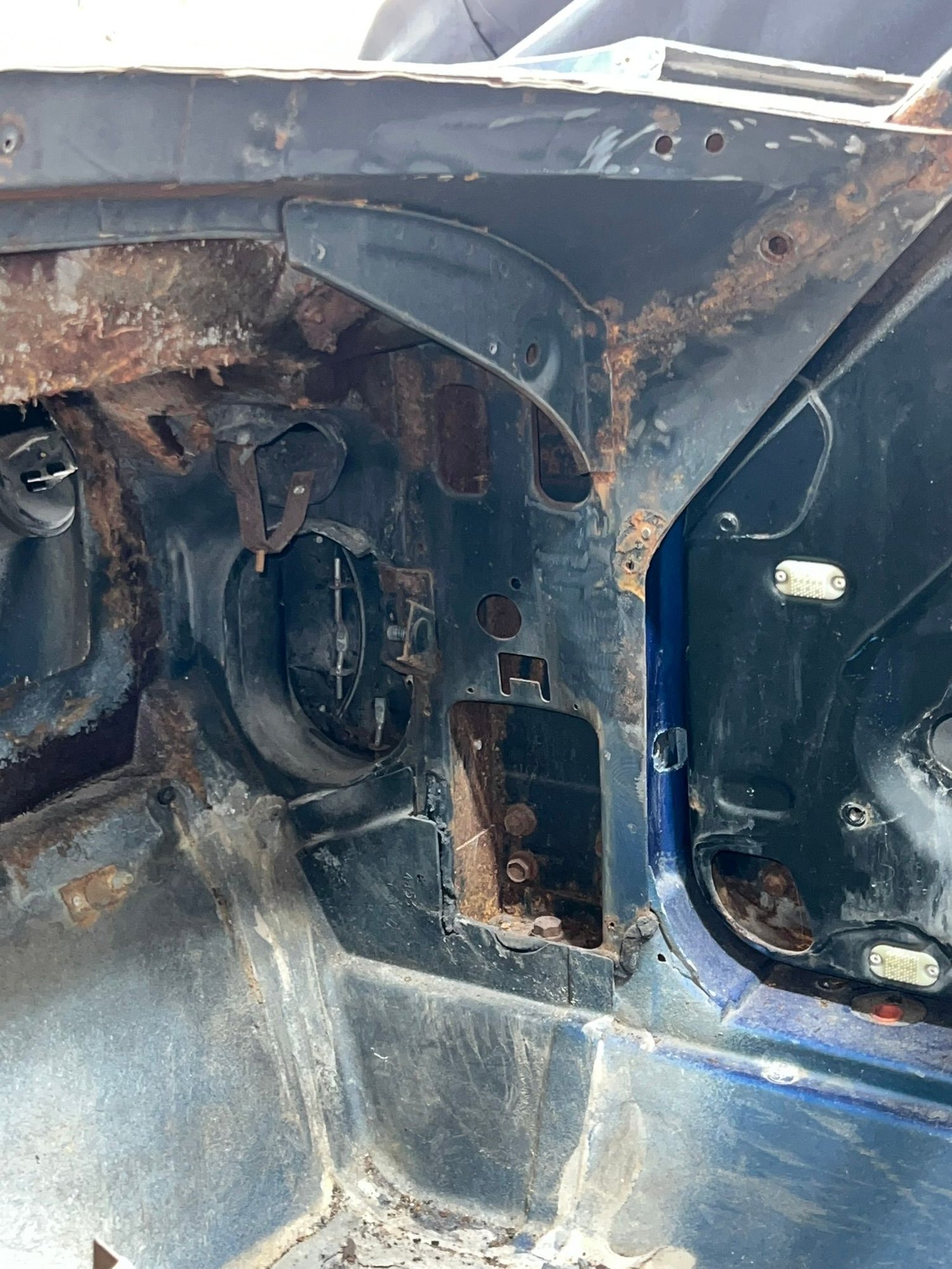

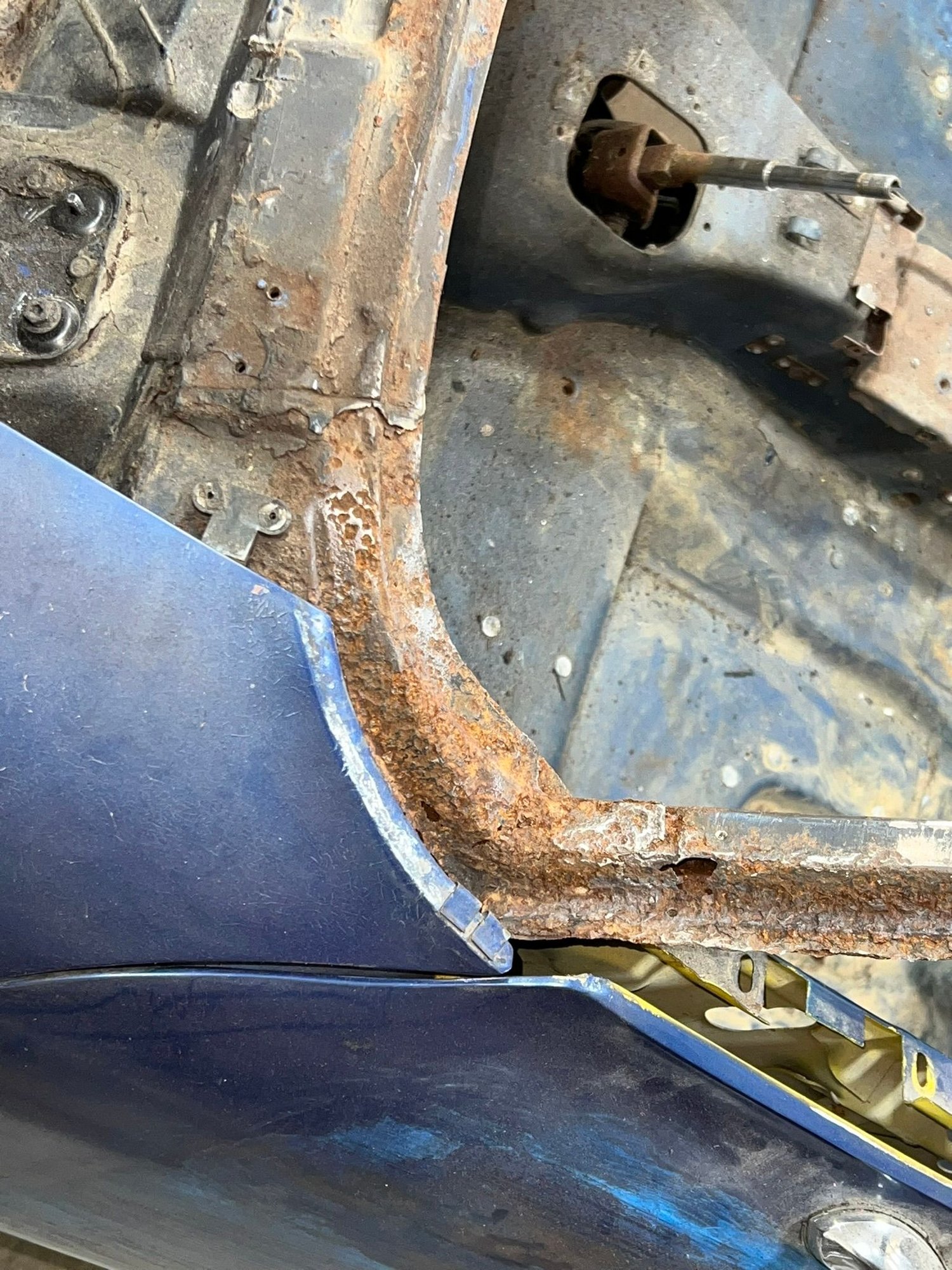

Man that is nasty. I would be really worried with the amount of rust the frame has moved around more than just a little. So can make a jig off of a solid none rusted car and transfer to your project?
Welding thin sheet metal takes a fair amount practice. I like and use Miller welders gas only no flux. Practice on 16 gauge sheet metal. .030 wire at the most.
Just thought but locally there is a mobile welding service that does mig and tig welding at your place. Maybe its an option to use some one like that to do some pro welding?

You're doing great work! I just finished the windshield frame and lower corner repairs on my '71. I'm not a great welder and had some ugly welds, but they all grinded down to smooth metal! I wouldn't try to use that windshield frame, that's really bad! I have a rust free full windshield frame I bought from a donor, and didn't use because I just had to patch a couple of holes. I'd be happy to sell it to you for what I paid, save you a ton of time!

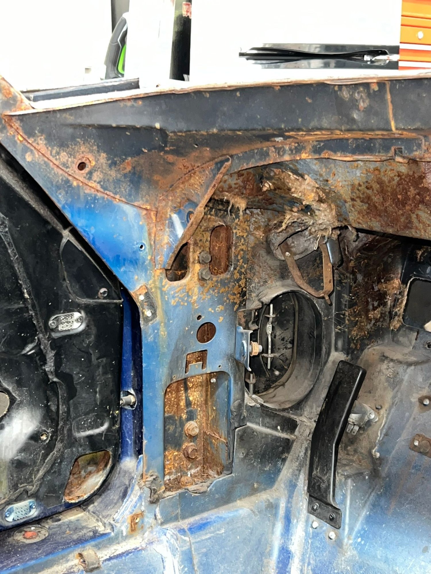

I like your spirit! You are taking on new challenges and learning new things. Looking at your body mount areas down in the kick panel wells, I’ve seen worse. Just looks like scaling down there. I could be wrong, but you may be lucky in that area. Great job and best wishes moving forward. You sure have done a lot so far. I bet it will look AMAZING once you are done.

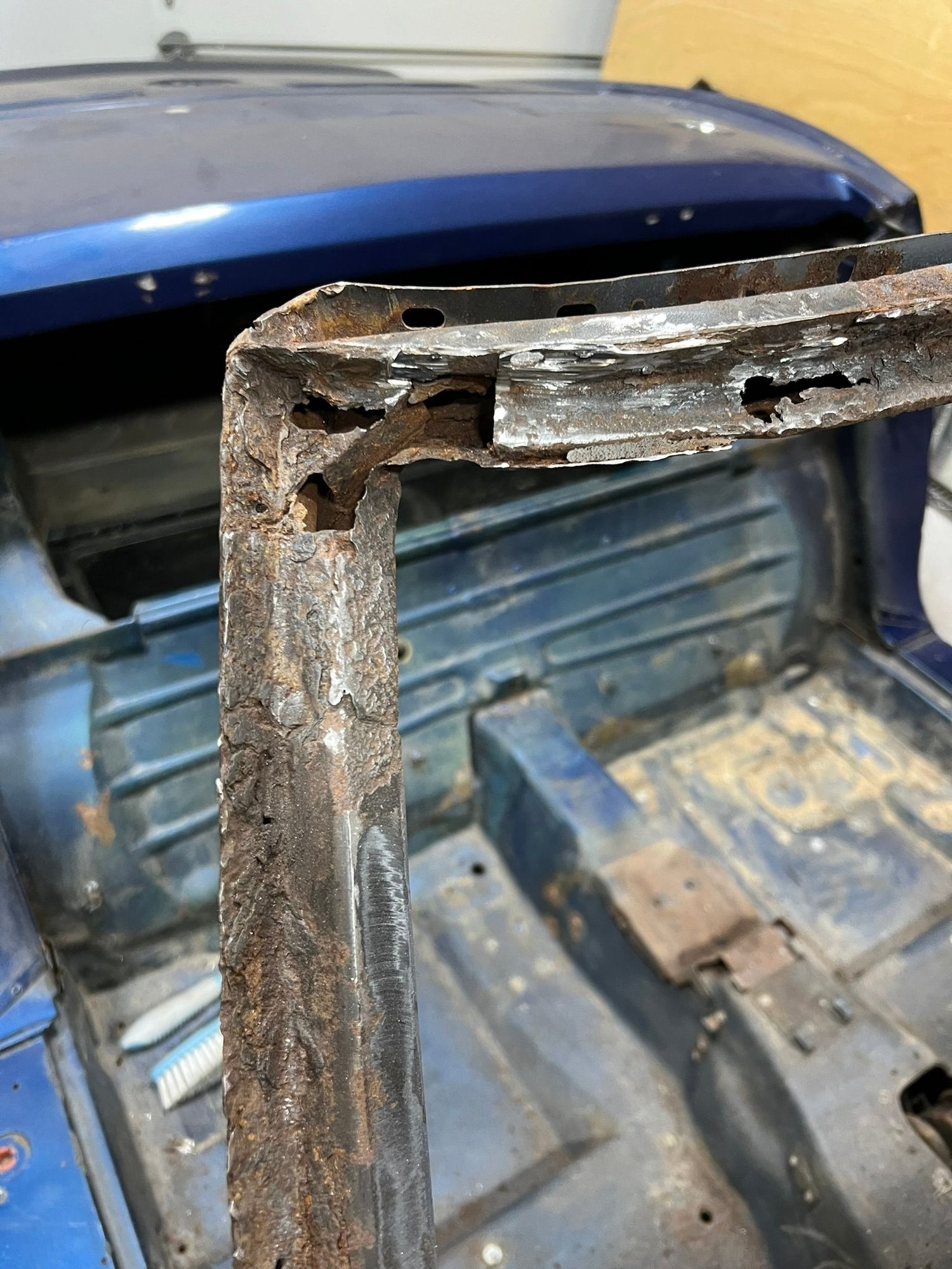

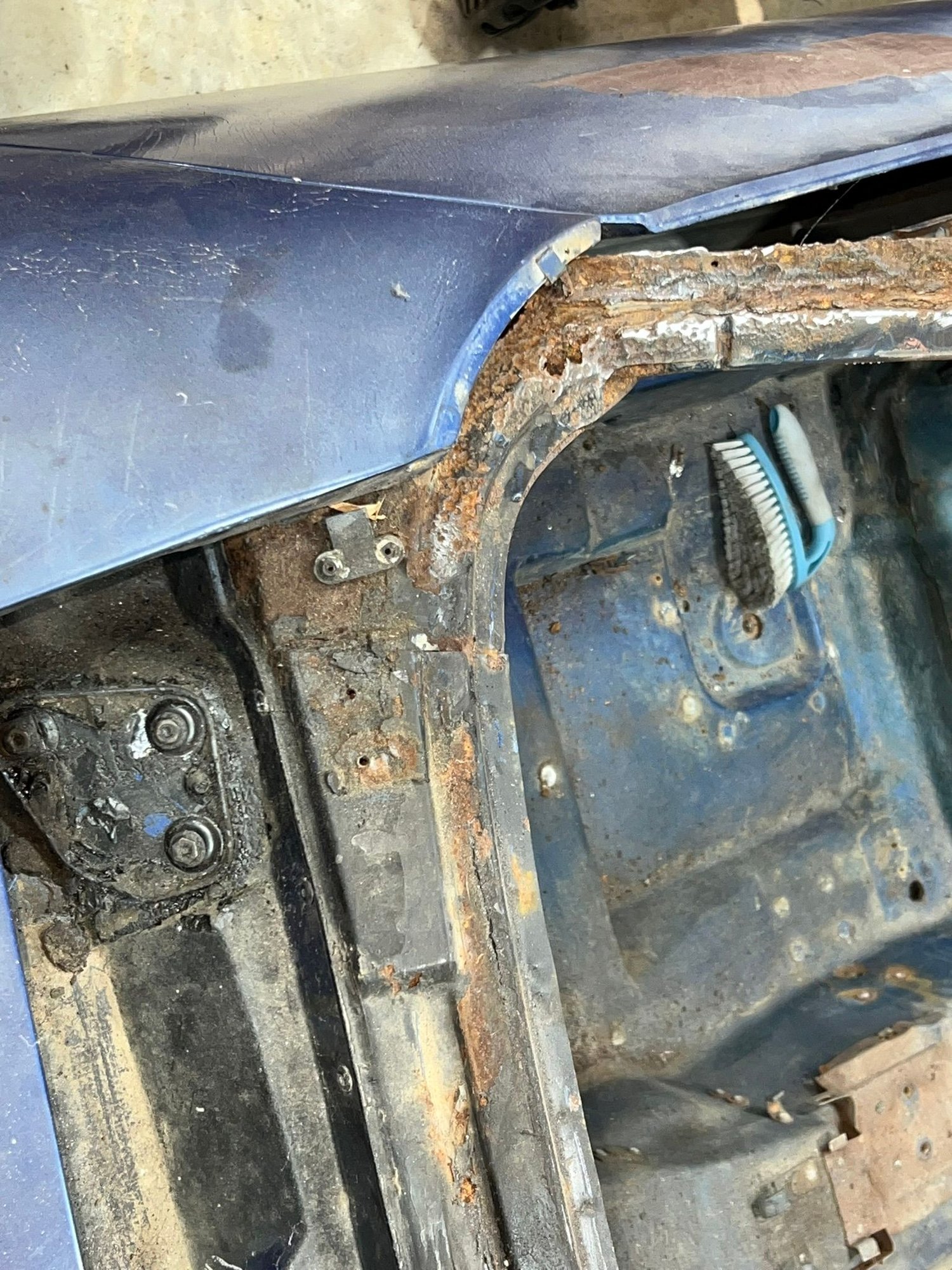

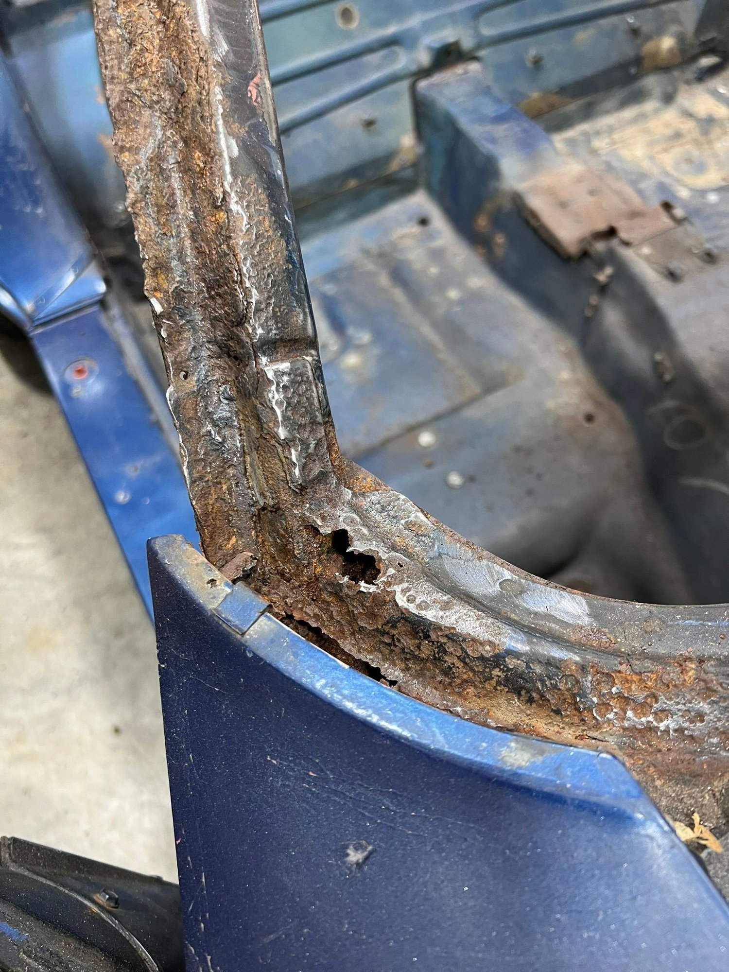

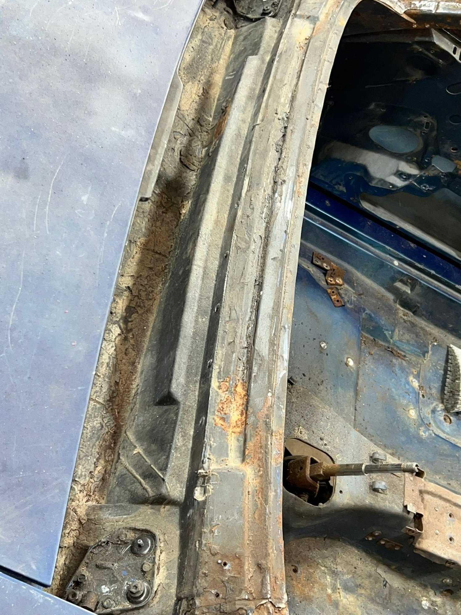

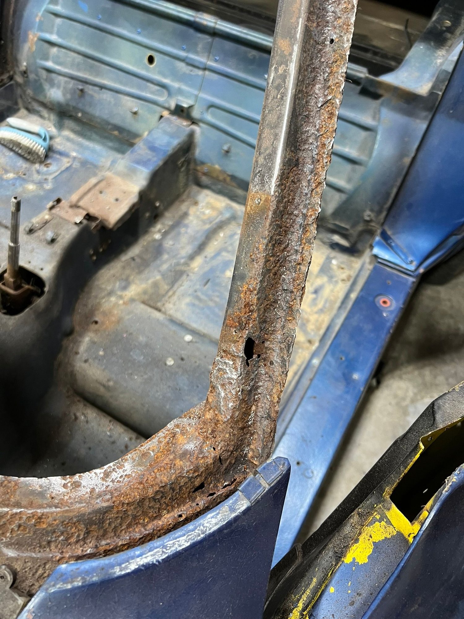

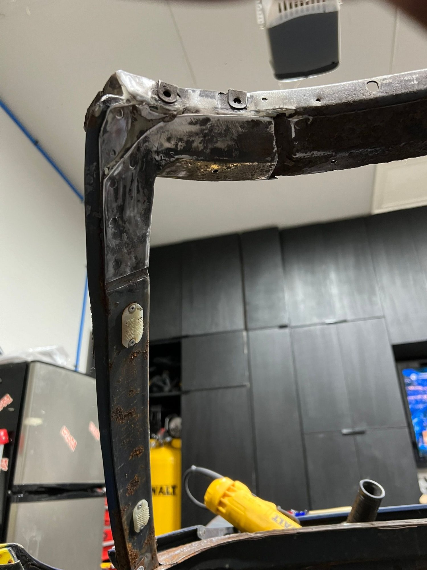

I took a few more pictures to show the rest of the windshield / frame.
First off, the two door mount pillars. They don't look perfect, but they also don't look horrible. I'm holding out hope they can be cleaned up and hopefully only need minor patching.
Then looking at the lower inside corners and supports, same story. From the interior they look like they could be ok, but I'll really know once I get the outside corners off and see what the other side of them looks like.
The front lower windshield doesn't seem to be that bad either. I'll clean it up once I get the firewall off, but I think there's a good chance I'll just be able to treat it and keep it.
Lastly, a closer look at the exterior lower corners. I don't like the look of either of them and I'm planning to replace them.

Dang, this is an advertisement for buying a sand blaster for our shops! Holy cow that is awesome!!!
Yeah, I'll say it's not exactly cheap but it's definitely worth it. I have no doubt that the cabinet, air filtration, and pedal (3 separate kits from Eastwood) have been paid for with the parts I'm not re-buying. The compressor is a big 80 gal unit from Dewalt that I got for my Christmas present, and I'm probably working off (or done) it's cost plus all the pex piping to hook up the garage too.

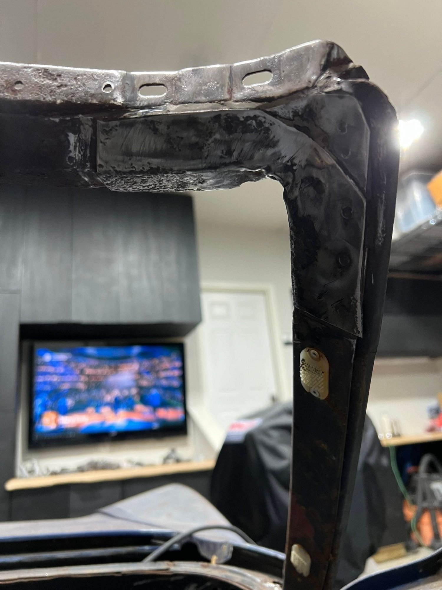

I emailed pics of the windshield frame . I don't know what it'd cost to ship , i'd guestimate $50 - 90 ? It's not heavy.
You don't know how bad the lower corners are until you open it up . If the damage goes down to the lower edge at the cowl then you need the clip and cowl removed to do it properly. Also , they do not make the corners for 69-72 , I had to use later ones. So I had to massage the metal to make it all fit, but it looks right and the windshield fit!

Thanks for the pictures. It looks like the top and both upper corners are good, but I can't tell if the side frames are complete or cut off at the lower? I've found repros for later (on CSC Corvette, are they any good?), and it looks like I'm going to have to do that same messaging...
The frame I have is cut at the very bottom , so would have to cut windshield off at base and weld this one into the same place. You would need to make a jog to ensure it's properly aligned and fitted.
