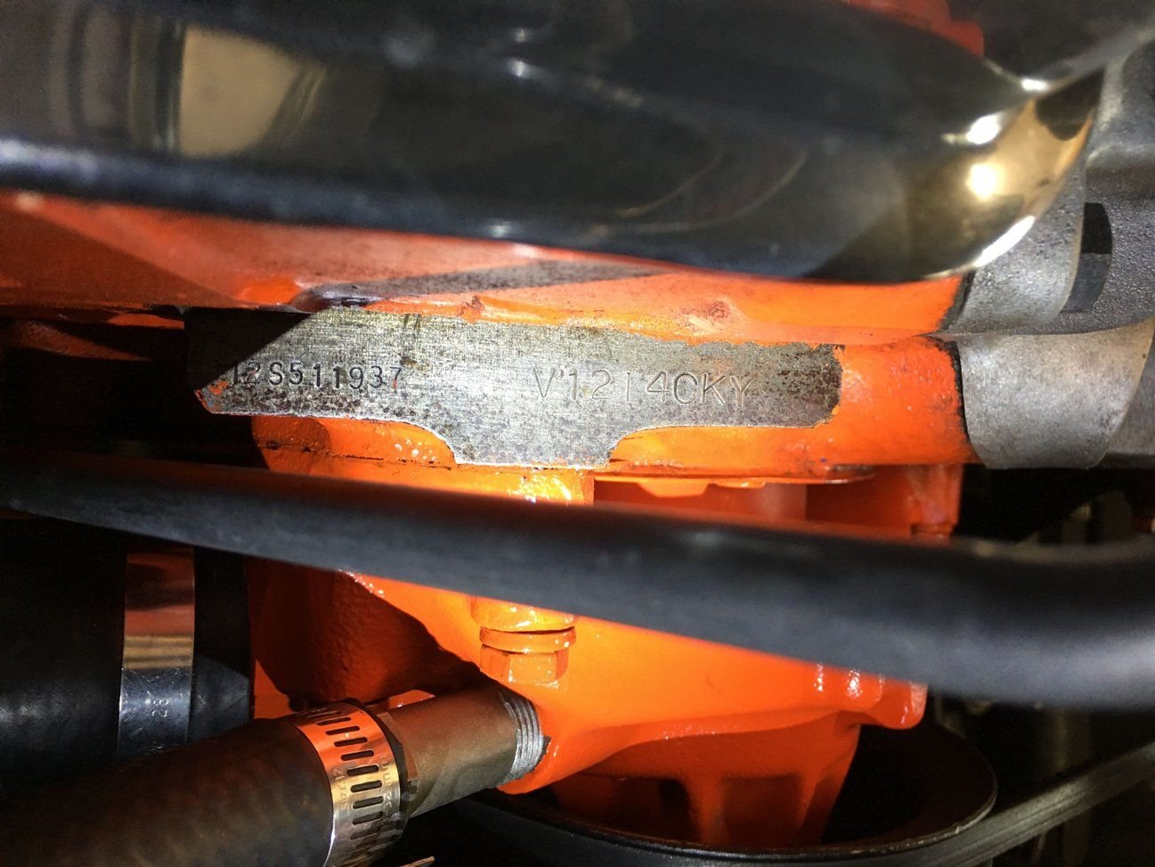

Coincidentally, we used to own a 1972 LT-1 coupe, 1Z37L2S511937, built just 92 cars after the one you're looking at. Our body build date was F20, January 20.
