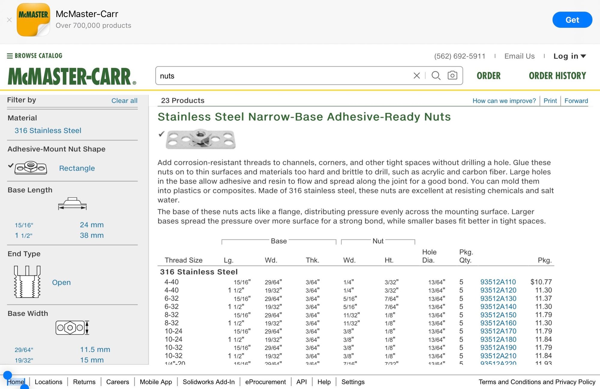

I used these adhesive ready nuts to bolt the vintage Air firewall cover plate to the firewall on my 73.
You could epoxy these to the inside of the door in alignment with the mirror holes and they should work.
