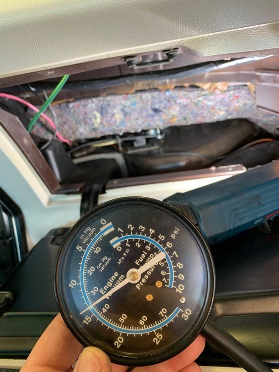

Ok, sorry for the delay. But, the vacuum at the hot water shut off valve is 5 psi of vacuum and it's solid.

5 inches of vacuum is extremely low you do know? Correct?
your engine idles at how many inches of vacuum? A totally stock setup around 18 inches.
A car with a nice street performance cam, around 14 inches of vacuum.
So, you have vacuum to the hot water shut off valve although it is VERY slight. Have you tested if it is actually able to shut the hot water off? Those heater hoses should remain cool to the touch if no water is flowing through them.

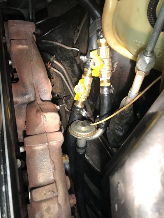

Those vacuum water valves are crap. I tried several on my 82 and they always flowed water. I also installed a shut off valve and it really made a huge difference in the heat by my feet.
I installed one with a bar type handle I could remove in the summer for cosmetic reasons. I would hit the occasional car show with 82CE. I just put it back on the fall/winter. If you look close you can see it.
