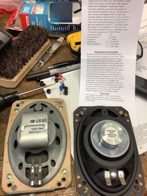

https://www.smelectrotech.com
pretty sure same..send them a note.
i think son took over…
i think mine were these..see description

Another happy customer with https://www.smelectrotech.com/ and my factory radio.

Me too. These are the ones to use if you stick with the factory radio. Has the right impedance so you don't trash the factory radio. Got the rear ones as well.
