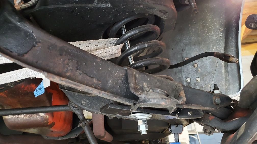

Threaded rod through the shock absorber hole.
Cheap N' Easy Coil Spring Compressor

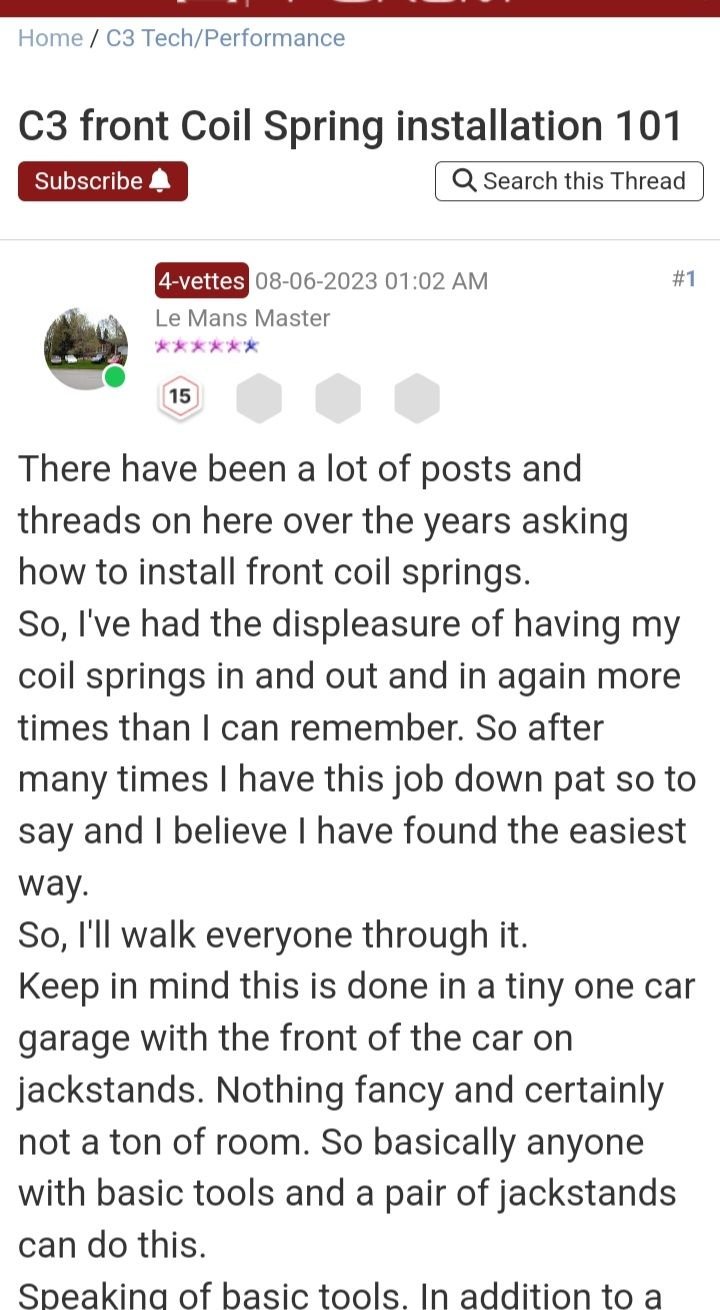

I suck at posting links on my phone. So here's a screen shot of a thread you should be able to find.
Take a look see if you can find this. You may find it helpful.

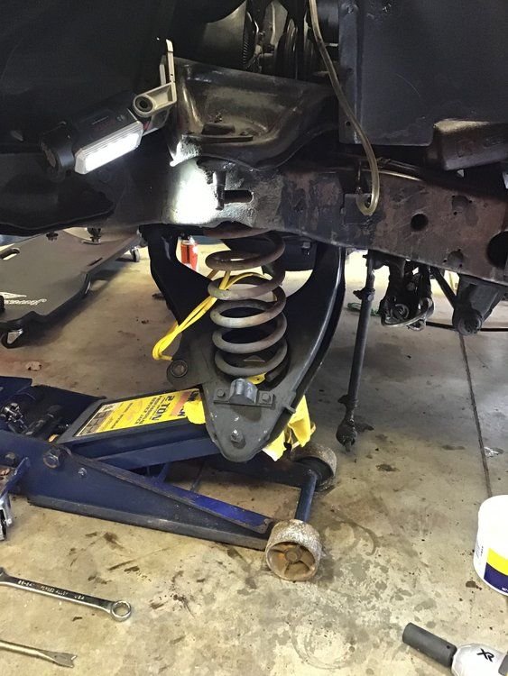

I didn’t use a compressor, just the jack under a arm then lower to let spring out..
then reverse.
here is my learnings
good time for bushings if needed
https://www.corvetteforum.com/forums...rs-method.html

Originally Posted by 71 Vert LS1
But just in case put a piece of chain thru the spring and around the frame to make sure the spring doesn't "jiggy" as you pry it out.
i used Romex in pic 12g looped through! Lol

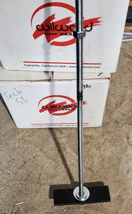

Here's mine. Ten bucks.
