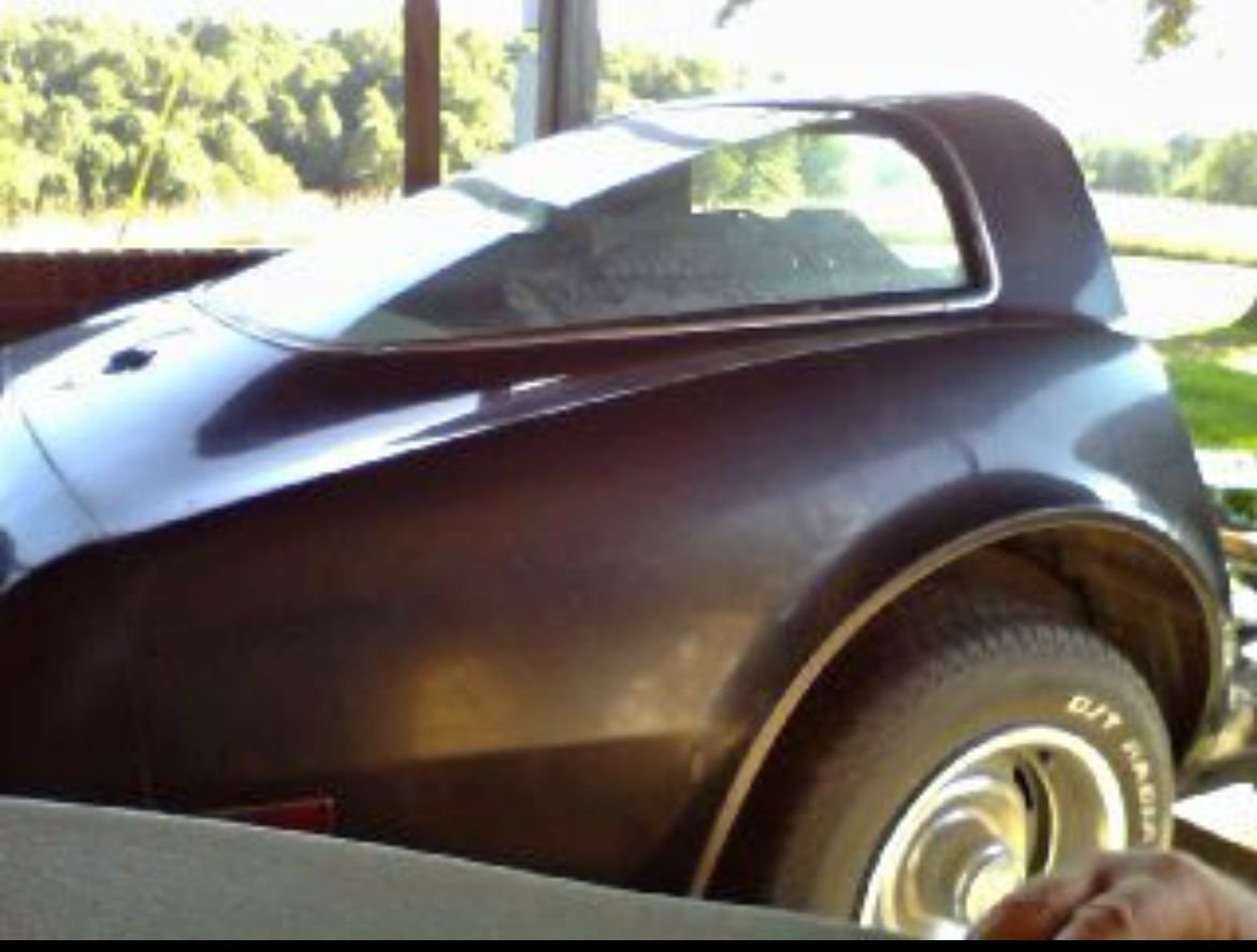

Doing a complete overhaul of the rear suspension and diff on my 1972.
My question is, I'm thinking about buying the back half of a 1978. Guy is asking $400 complete with body, glass, fuel tank, lights, rally wheels, diff, trailing arms, half shafts, the works. Too cheap to pass up unless there are any fitment issues, I'd like to rebuild the 78 parts and swap them in to minimize down time. Originality is not a concern. Any fitment issues i should be aware of before i pull the trigger on the parts car?

The differential and trailing arms are all the same from 65-79. The half shafts, rear spring and differential cover are slightly different.
Your 72 has 2 1/2" diameter half shafts, the ones in the 78 rear are 3" diameter, but the universals are the same. You can use either half shafts, they are interchangeable. Some people claim the 3" ones are stronger, but I don't think so because I've been told they were made from thinner wall steel.
The 78-79 rear spring is 2 1/2" wide, your 72 has a 2 1/4" wide spring, and the 78's spring "dog bone" mounting plate and rear differential cover are different to mate to the wider spring. You can use your rear spring by using the rear cover off of your 72's differential, or use the spring from the 78 with the other 78 parts.
That's all I can think of off the top of my head, but if I missed something I'm sure someone will add it here.
$400's a steal, you can get that back from the rear glass and moldings.

Perfect. This is exactly what i was looking for. Thank you.
