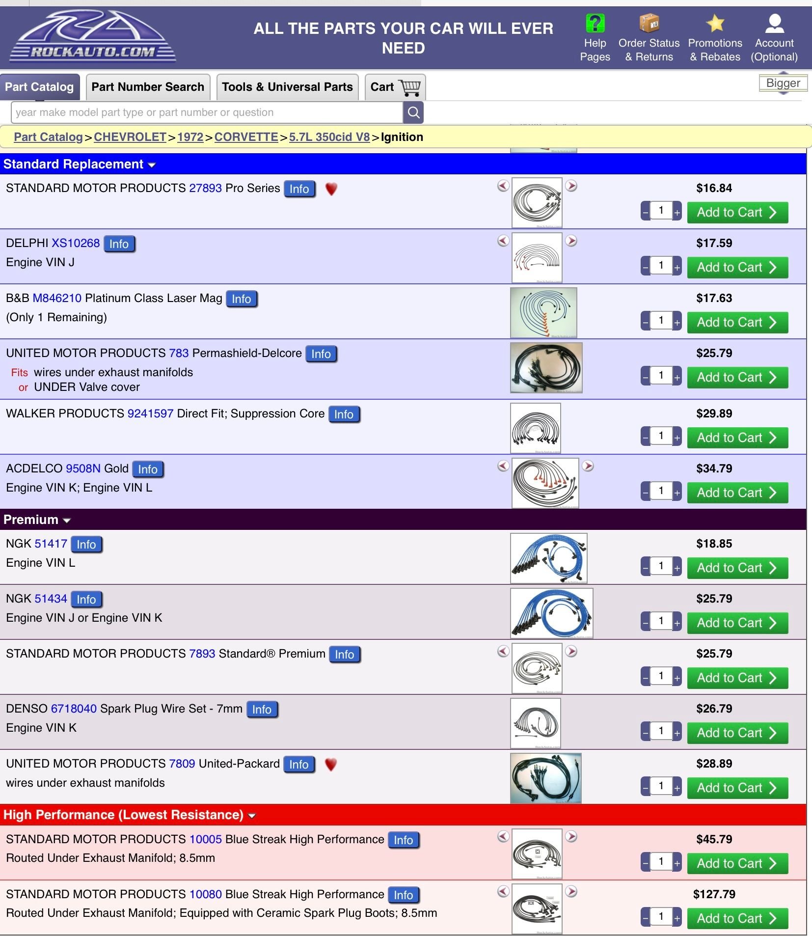

I am seeing mostly wires with elbow boots for the plug ends and what I've got now are the longer straight boots. Which did the '72 sbc come with? I replaced these once and don't imagine I bought anything different than what it had when I got it. Are the ones with the elbow boots ok to use? Thanks
Oh, and what in the world does a $180 set of wires have that a $50 set doesn't, gold or something?

If you plan on selling the car anyway, by all means throw those $16 - $29 sets on there. Those sets will get the car down the road a ways.
What does a $180 set have? IDK know about those but anything over $120 has:
Longevity.
Thicker outer insulation.
A better core of strands.
Better terminals at both ends that "click" when installed fully.
Heat resistant boots good for 1200*
No misfires.
Less ohm resistance per foot.
Flexable for routing the wire, instead of cheap stiff units.
8.5mm diameter (fits most looms)

For those unaware: The small blocks (VIN K or L) should have 90° boots while the big block (VIN W) has 135° boots. The difference in application has to do with the small block wire routing behind the engine and below the exhaust manifolds; big blocks had the wires over the valve covers.
I used Summit-branded 8.5mm wires on my cars, using the 135° boots. So far, after a few years, they've performed well.
https://www.summitracing.com/parts/SUM-887806
