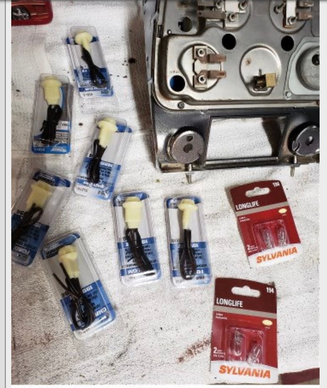

I also have used some of the "marker light sockets" as Old Car Bum is showing. They are the only thing that is available at your average auto parts store. I found that I had to trim the rubber a little with a razor knife to fit. I took one of the leads and stripped a little bit of wire and then looped it between the socket and the metal to provide the ground. Worked well.

You can get the sockets and bulbs from Rock Auto.
Pretty cheap.
If you order them, keep in mind the bulbs come in a two pack.
I now have a lifetime supply.

I purchased the bulbs and sockets Richard454 provided the link for.
I installed them in my 73’s center gauge cluster, tach and speedo housings.
They fit perfect and are much nicer than the oem’s.
Nice and snug so the bulbs won’t work loose and fall into the gauge clusters.
Did you use these on the two wire bulbs in the center of the Speedo and Tach?

I swapped everything in the dash and center gauge cluster to these type of bulbs.

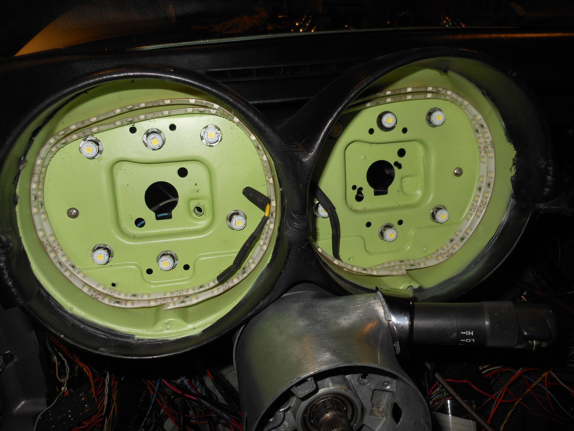

I used the two wire bulbs PLUS added some strip LEDs- nice and bright!
A trick -Kept them in place with hot glue- till the silicone set up.
