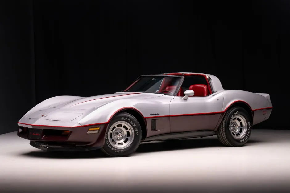

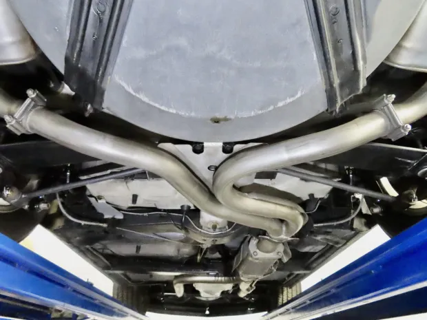

Yes.. the entire brake system was replaced….all rubber under the car actually. A LOT of money in this one…bought it recently restored as you see it here and am still working on it…lol
