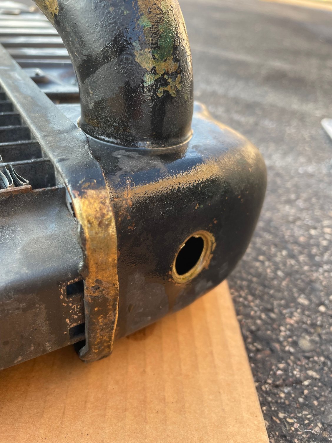

Radiator drain plug ripped! Help!

Originally Posted by Mark G
Like I say, just make a brass patch to cover the hole and solder in over the hole. The whole radiator is soldered....you don't need TIG (whaaaat??!). You need to remove it, wash it out, tip it upside down (repair-side-up). Clean the paint away around the hole with some steel wool. Degrease the area. Apply the flux and have at it. If you don't get it satisfactory the first time, clean and try again. I bet there are probably dozens of videos on how to do it.
I've soldered lots of radiator leaks in the last 30yrs. Just did one in my skid steer not that long ago. Not that difficult. I'm telling you this from experience. Why drive all over town and wait, go back...all that running around and pay a shop for something you could literally do in 20 min?
Probably dumb question, but in that case would I even need to remove Rad? I feel I could probably do all that with it in?
Old Oct 8, 2024 | 04:11 PM
Mark G's Avatar
Mark G
Joined: Jul 2005
Posts: 3,697
Likes: 833
From: WI
Definitely! You want to turn it repair-side-up. It has to be dry. You want a good work area...so you're working on it and it's not going to tip over or moisture drip down. You can't solder anything when there's even a drop of two or three of moisture. And coolant has inhibitors in it that aren't helpful for soldering too. So I would rinse the radiator out with water a couple times and let it sit and dry for a few hours...with the repair area 'up'.
The best would be to heat the hole up a bit with your propane torch ...to cook the paint around the hole (5-10 seconds), and then clean the paint off with steel wool once it cools. I would personally put some phosphoric acid cleaner HERE to the brass around the repair area (not whole radiator). Put some on a paper towel and get inside the hole to clean the underside (using yer finger or some tool). There could be deposits, etc. on the underside of the hole. The Phosphoric acid...will 'eat' away deposits, etc. It's similar to a strong bathroom cleaner only stronger. Not like battery acid. Won't hurt ya. I use it all the time. It'll eat away and deposits on the underside of the hole. Use a brush or paper towel maybe a rubber glove. Might sting yer fingers. I put it on the sinks and bathroom fixtures of our rentals (renters aren't the cleanest) and man it eats away all the lime etc with a little brushing and makes them look like new! It'll take rust of bolts if ya soak them. Good product. Hundreds of uses. Rust-Oleum has a similar gel product. Both are good but for different applications. Then neutralize the phosphoric acid and clean the area with some water on a sponge.
Then dry it. It has to be dry to do soldering. Put some soldering flux around the hole and the patch...and heat it up and apply your solder. Watch some videos on soldering copper pipes. It's easy. Go buy a couple copper pipe fittings at the home center and practice.
I'll make a plumber out of you yet! LOL

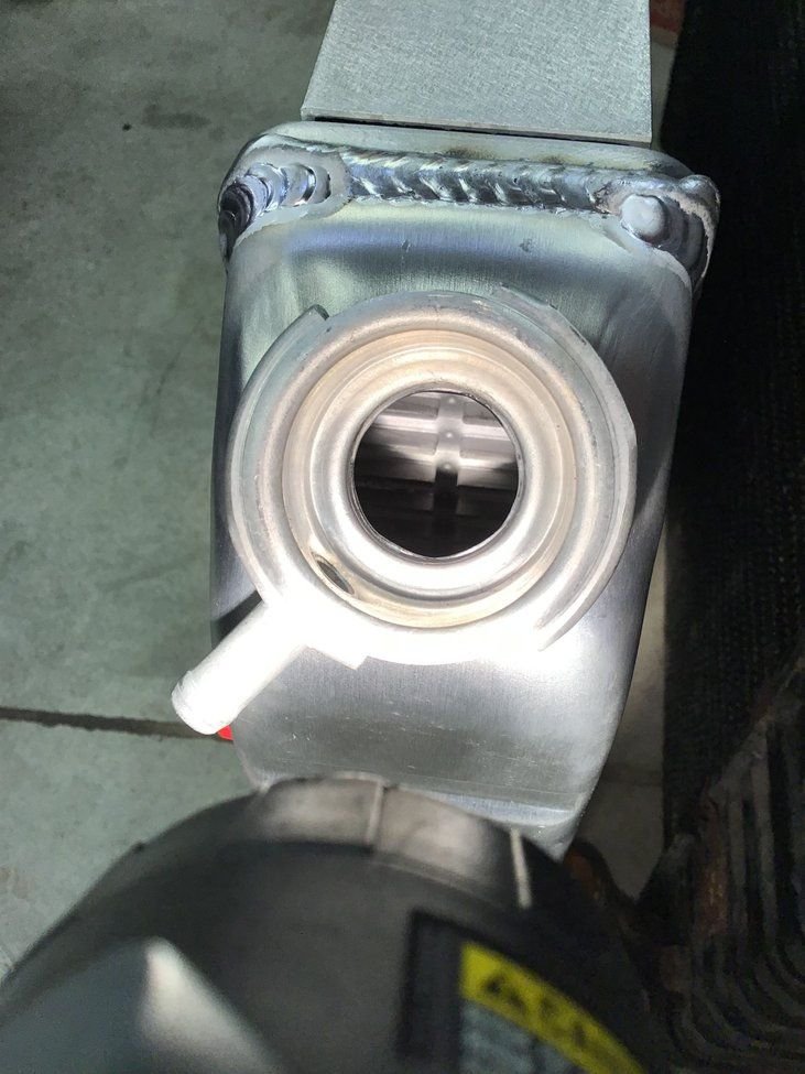

Just throwing this out there...
I would thoroughly inspect that radiator inside and out before getting repaired. If really good then repair it, if not...
i like to keep mine original but with newer aluminum radiators with higher efficiency and reliability (peace of mind not watching temp gauge) , i would seriously consider replacing it. You can store the old one in the shed .
here is my 40 year old radiator thread if helpful. Note the DeWitt's universal rad from USA made Zip is pretty good value for the 78-79 if still around (insert choice of rad suppliers) . For as bad as mine looked.. the drain opened right up. your metal may be thin?
https://www.corvetteforum.com/forums...nt-79-l82.html

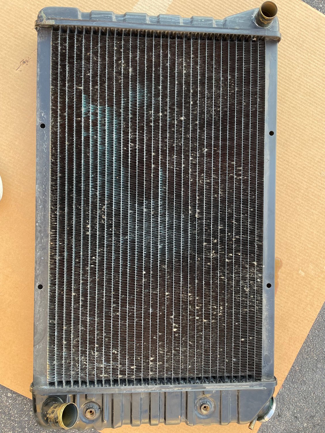

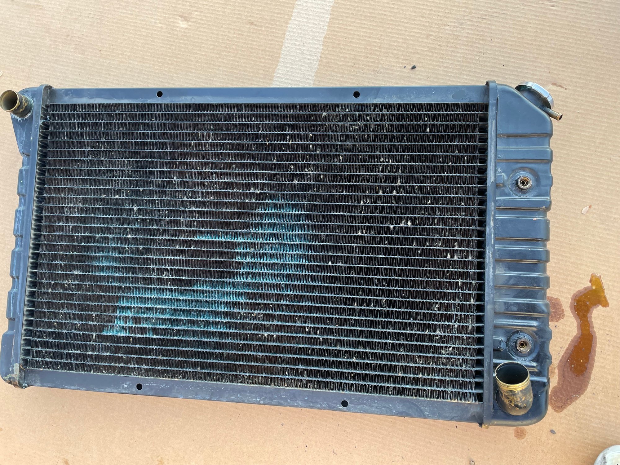

Thoughts on condition? Not sure how much rad shop will charge, yet.
Old Oct 9, 2024 | 07:55 PM
  #37
JC 78 Vette's Avatar
JC 78 Vette
Joined: Jun 2024
Posts: 100
Likes: 38
inside view
Old Oct 9, 2024 | 08:59 PM
  #38
HeadsU.P.'s Avatar
HeadsU.P.
Joined: Aug 2017
Posts: 8,336
Likes: 2,810
From: Cool Northern Michigan
Looks like some accidental overspray GM Corporate Blue engine paint on the back.
Looks like 20,000 miles of dirt roads on the front. Yikes! But will clean up easily.
Inside looks like somebody changed the coolant regularly and used distilled water mix.
That's good.
