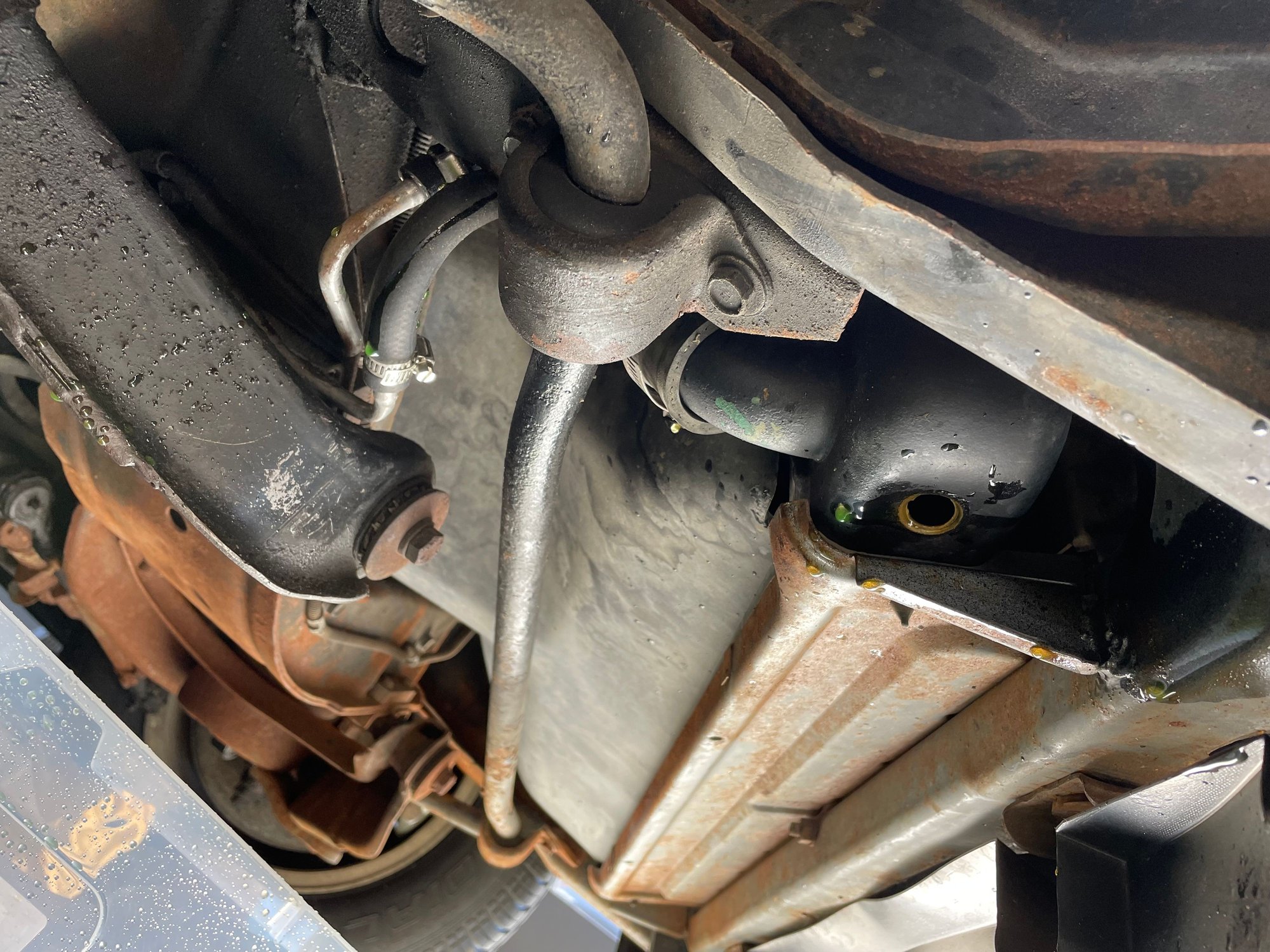

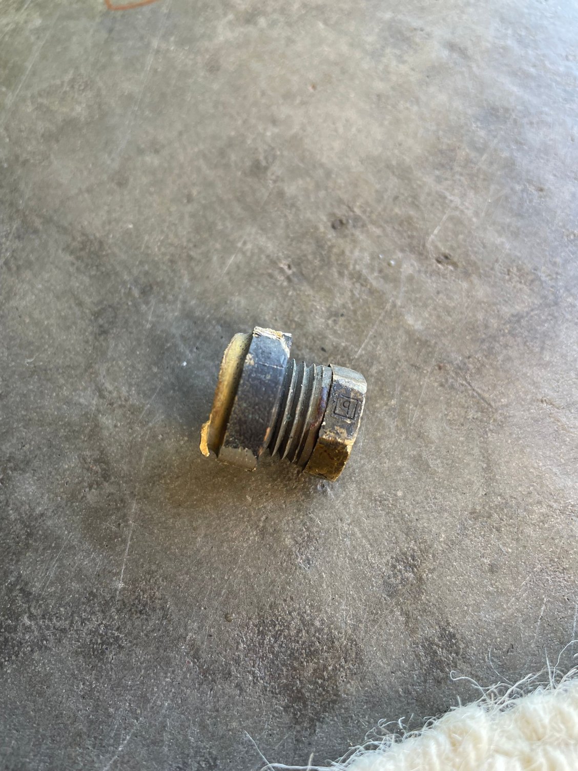

Of course!! What should have been the simplest of things now is a huge mess. Tried to unscrew radiator drain plug and then entire threading on the radiator just peeled off (without much force too boot). Drain plug is so damb tight I still can’t get off. Is there any solution? Am I screwed and just now have to replace the entire radiator. So $&@$ pissed off right now

Thats not what a radiator drain fitting looks like. I think the previous owner cross threaded that in there.....either you need avradiator shop or get a champion radiator off of Ebay if you are tight on cash

I just had this happen to me.
you have to heat the larger female nut part and then break it loose.
I put the male part in a vise.
Radiator shops carry a new part to solder in or I suppose you could try to do it yourself.

That an easy DIY for a guy with moderate soldering skills and a propane torch. Or It might be worthwhile to take it to a radiator shop and have them hot-tank it...and clean out the insides too. You could do a cooling system flush afterwards too on your own...and that does a good job usually. So you have a couple options.
If the radiator shop says it's no good, take it home and do it yourself. They're probably trying to sell you a new one. Brass radiator like that is really nice. Problem with aluminum is the pH requirements for aluminum and brass are very different. Brass is a noble metal. Aluminum isn't. I could go into the whole science, but you have mixed metals in your cooling system and heater core...and the only way for an aluminum radiator to last as long as that Brass radiator is to keep the pH of the coolant within a very narrow range (which nobody does). So, keep the brass radiator.
You can remove the paint in the area with a propane torch, and clean the area to be soldered with some phosphate cleaner on a rag ...which you can get at any Home Depot. Get a new drain off ebay. You could do it yourself for free in 30 minutes. But if you don't have any idea what you're doing, let a shop handle it.
I've soldered a bunch of radiators after having radiator shop do ****-poor jobs. It's not difficult for small repairs like that. But again, if you aren't feeling like you want to do it, have a radiator shop hot-tank it and they should be able to do a nice job.

That's what my '77 looks like also. Minus the damage.
Bad news: Fan, belts, shroud have to come out.
Good news: Should be an easy fix at a Rad Shop.
I would not put a petcock or that plug back in it after repairs.
Summit sells a sacrificial anode rod that fits the hole perfectly. This type of rod / drainplug will help with electrolysis issues of dissimilar metals in the cooling system also known as corrosion. You have iron, steel and aluminum parts = corrosion.
A dab of Permatex Water-pump & Water-neck RTV on the plugs threads will help next time.
Just noticed this is an automatic. Those Rads will require a lot more cussing to remove lines than manual trans. It's all doable. Good luck.

Option #1 - Replace Radiator
Option #2 - Take the radiator out and bring it to a Radiator Shop - they can solder a replacement fitting into the radiator. But - Good 'Ol Fashioned Radiator Shops are getting quite difficult to find, and while it isn't a "big job" - they do have to get the area they are working with clean - so the solder will adhere - so it's not going to be a super cheap job.

Did you have shop do it? I was able to get threaded plug off at least
