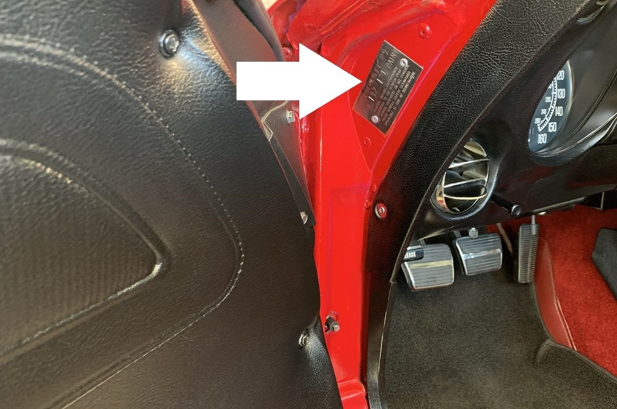

417 is saddle color in vinyl, 420 is saddle color in leather. There’s no light or dark for 1971.
You'll find your interior color trim tag on the front side of your driver side door jam.
