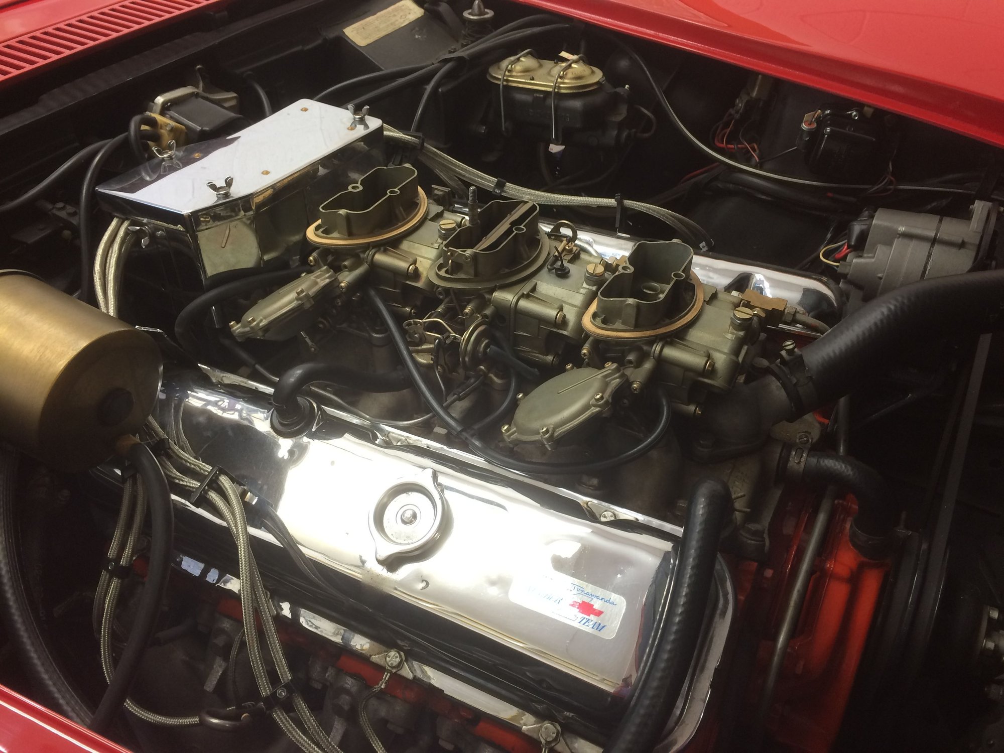

Uhhhhhhh that's what I get with this:
Something is very wrong, my guess bubbazised & not stock. You should get about 3x's that hwy !

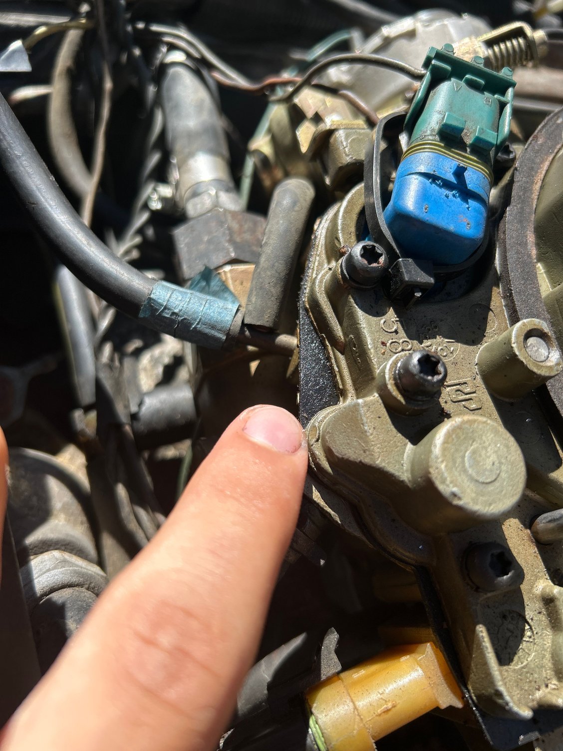

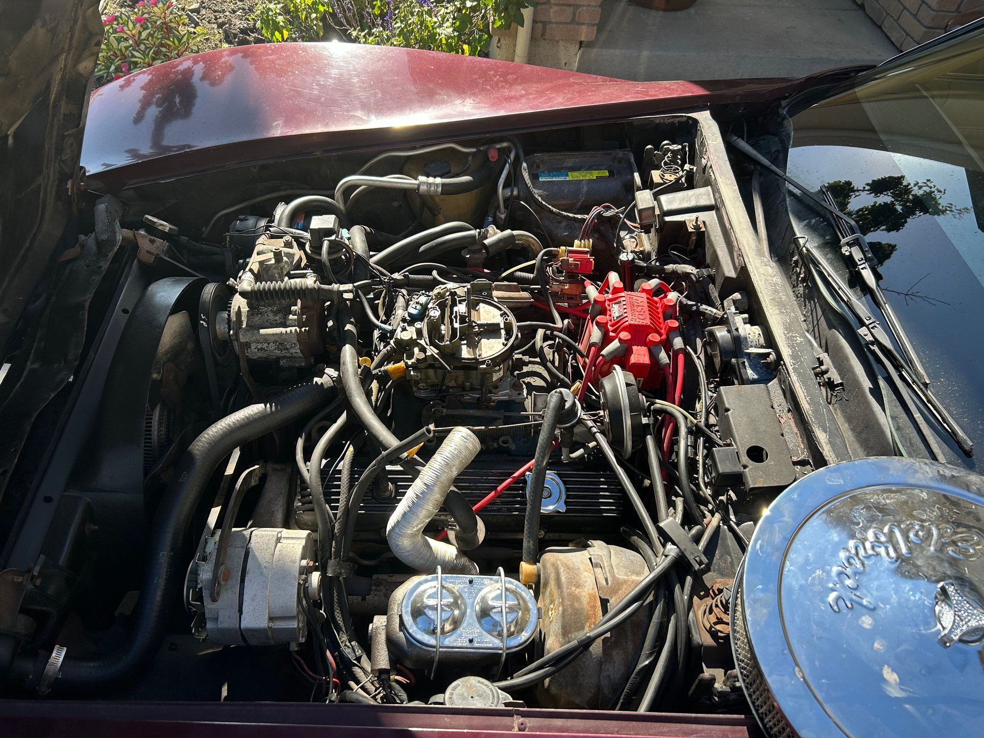

What I got going on under the hood. I already have that msd thing so I can just get a another carb and everything should work fine right?
This thing also appears to have gas on it. Does it need a new gasket?

Old Oct 15, 2024 | 02:41 PM
7T1vette's Avatar
7T1vette
Posts: 37,637
Likes: 3,114
From: Crossville TN
The '81 had a one-year-only ECM/electronic carb/distributor system that would only work properly if all items were in good shape and used as a system. If you 'modified' engine system no longer uses the ECM, it also MUST use a 'standard' distributor and carburetor...it cannot use those items which came from the factory.
If the ECM (and other components) are still operational, you need to diagnose the problems with the engine controls system via info contained in the 1981 Chevrolet Chassis Service Manual. To my knowledge, there are no qualified mechanic shops (or dealerships) who have adequate capabilities for working on an '81 C3 engine control system. In this case, yes, your OBD-I trouble codes will help to guide you toward the cause of your problems.
What has the previous owner told you about this issue? Surely, he/she had similar problems...maybe why the car was sold. But, if the PO knows that the fuel mileage was not a big issue in the recent past, the problem could be solved with a rebuild of the metering solenoid in the carb and/or a new O2 sensor. This control system is not "complex". It just needs to be diagnosed to identify the problem area[s] needing resolution. If the engine seems to run OK, odds are that the issue is somewhere in the engine controls system.
