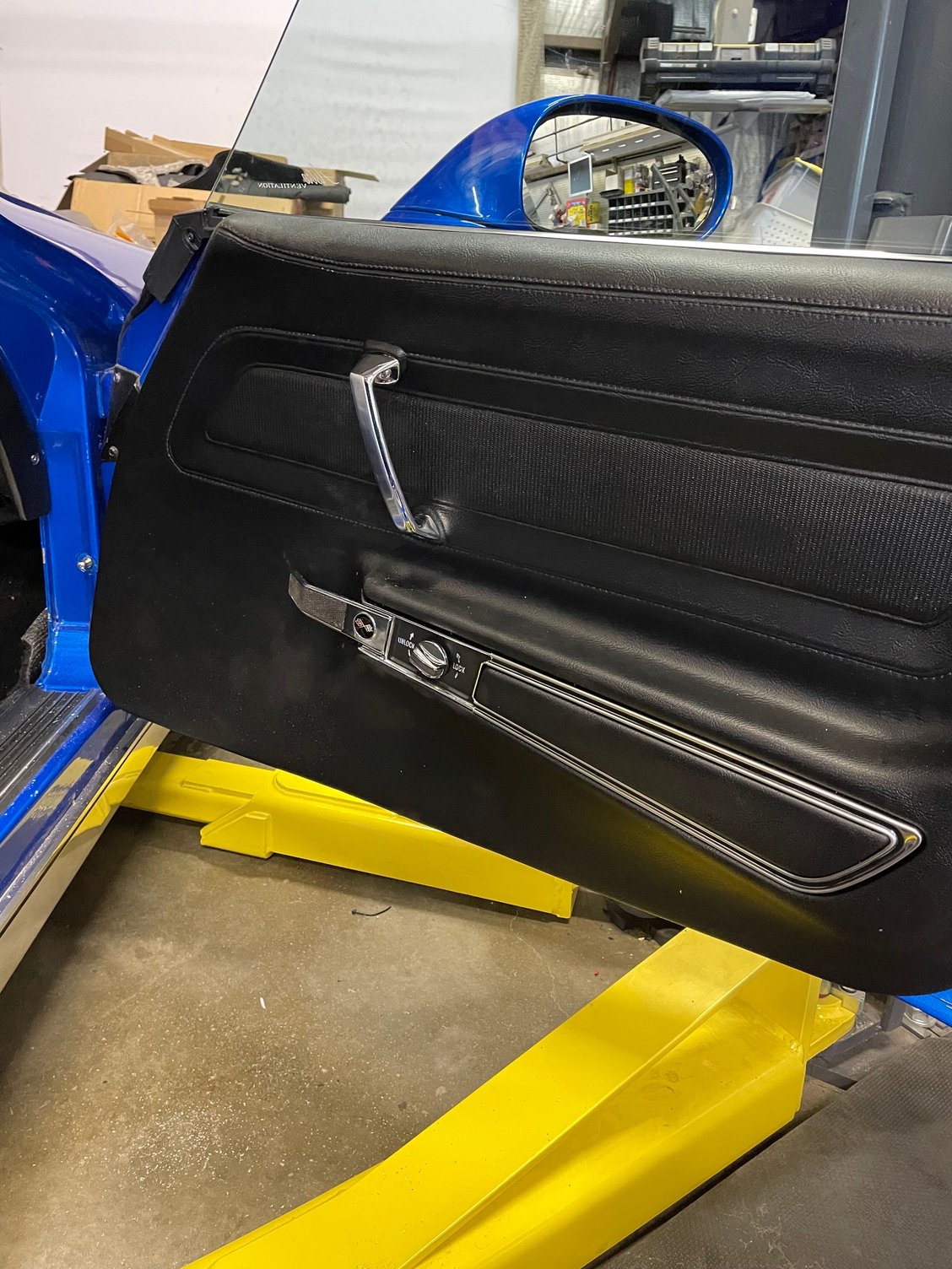

It takes some grinding and test fitting, but you can make the chrome door pulls from the C2 Corvettes work on a C3 . The left one works on the right side and the right on the left, Leaves you with a solid feeling door pull.

This is a very viable option. Will likely go this route and powdercoat black!
