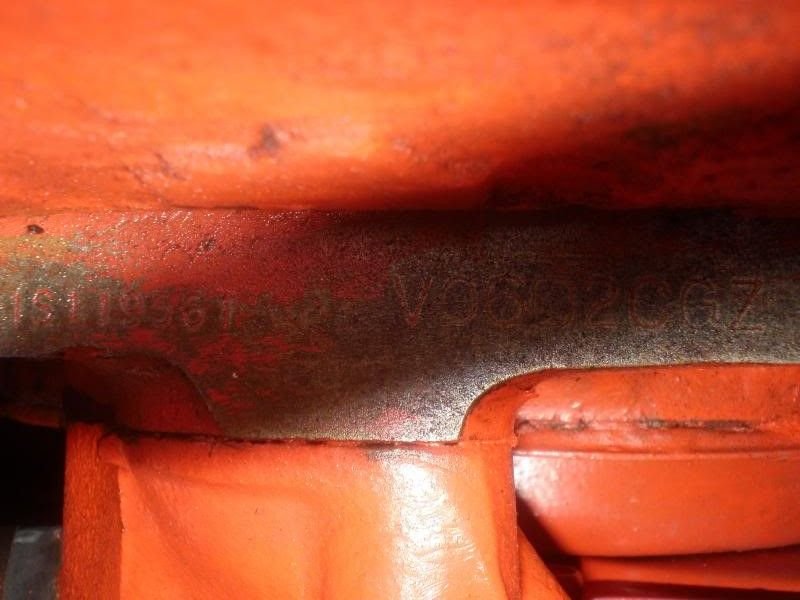

This is a pad from a 71, but the pads are all the same shape on small blocks up to 1977. "V" is the Flint engine plant, "0602" is the engine's assembly date, June 2nd and "CGZ" is the engine suffix code, in this case a 1971 LT-1. The numbers to the left ending in "561" are the VIN derivative.

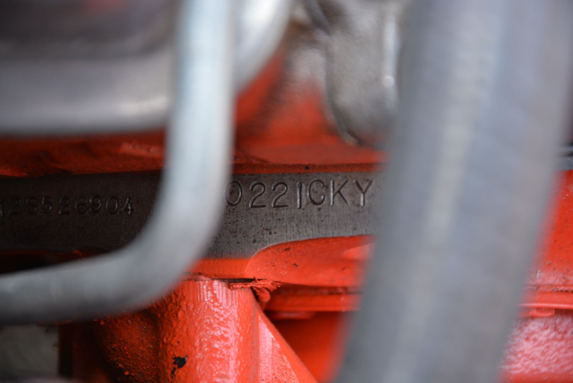

This is the pad from a 72 LT-1 built on February 21st (0221), though the "V" for Flint is being blocked by the fuel line.

If your pad is rusty or covered with paint, do not use anything abrasive to clean it. Original pads have machining marks known as "broach marks" on them, that makes it easy to identify a real pad. Using something abrasive with remove the broach marks, so it's always better to use paint stripper or thinner, WD40, or something similar and a soft rag, old tooth brush, etc to clean the pad. The broach marks are easiest to see in the second picture above of the 72 pad.

This is excellent advice. Do not use anything abrasive or mechanical to remove paint or rust from the stamp pad as it will almost certainly cause damage to the pad’s surface… Which is just as important as the stamped numbers themselves.
Probably not the best example. While there are “lines” that can be seen, these are not machine marks made be the broaching machine. This pad is definitely a restamp.

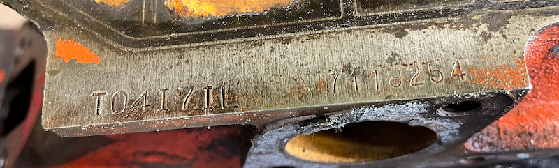

Here is a pic of my '67 engine pad and its broach marks – I've owned the car since '79 and it's never had the engine rebuilt:
To Numbers Matching?
